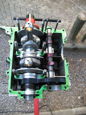

Marty bench running my current race motor.

I started on this engine some 10 years ago, then got tired of the VW-scene and put it away, found new spirit some years ago to finish it. Mostly done in my small shed :-) A little cold now so I moved it indoors..
Its a 2387 based on a WBX case, with an old Pauter crank and Crower rods . Old S/F heads modified for turbo. Turbo spec cam by Skinne, TWM 55mm throttle bodies, dual watercooled intercoolers. 1600cc injectors for E85.
Built for the street with Drysump, piston oil squirter's, full cooling with internal vanes, and so on. but will see the track!
Smallish turbo compared to many racers...
