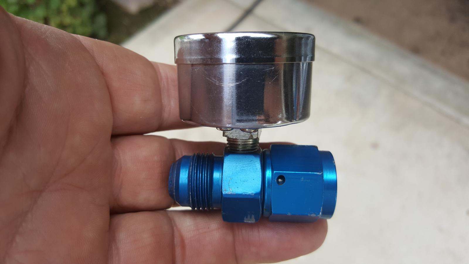

Fiatdude
Posts: 1823
Re: Karman Sutra
Reply #389 on:
September 14, 2017, 19:35:26 pm »
Here's the fitting I use Martin
