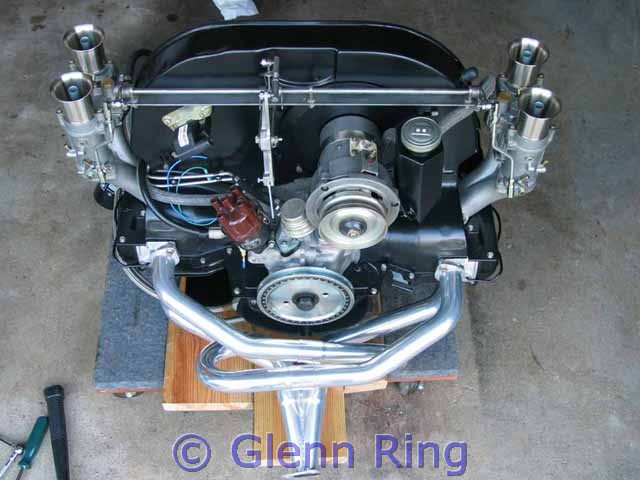

It is an old school Berg header like the one in this photo so you cannot even remove the #4 cylinder pipe since it hits one of the bends (in fact it will barely move in and out a few millimeters so I cannot even get sealant in there-maybe I will have to weld it or do flanges or get out the dremel and cut slits and try a clamp)...

I applied some orange RTV and used a block of wood and a dead blow hammer to get mine together.... no leaks.

That must be a new style header. Their older style headers (that can be seen on that for sale link) you cannot remove the #4 exhaust pipe to put any sealant on the slip joint.
