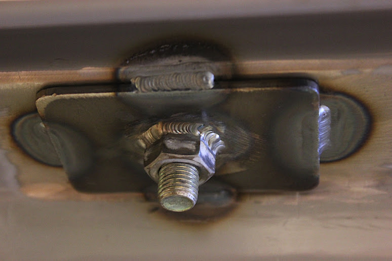

This is how I did mine on the outside of the pan up front.

Fitted 3 point retractables I the front of my '58 with semaphores (which limits height of 3rd mount). Coming from the UK and having done similar things there (including article for the old TotalVW magazine with Quickfit), the rules and signoff needed here in NZ seemed a pain at first but very happy now as it results in a good factory style installation where belts can be removed without washers etc dropping to the ground . No welding needed!. I can post pics if you are interested.
