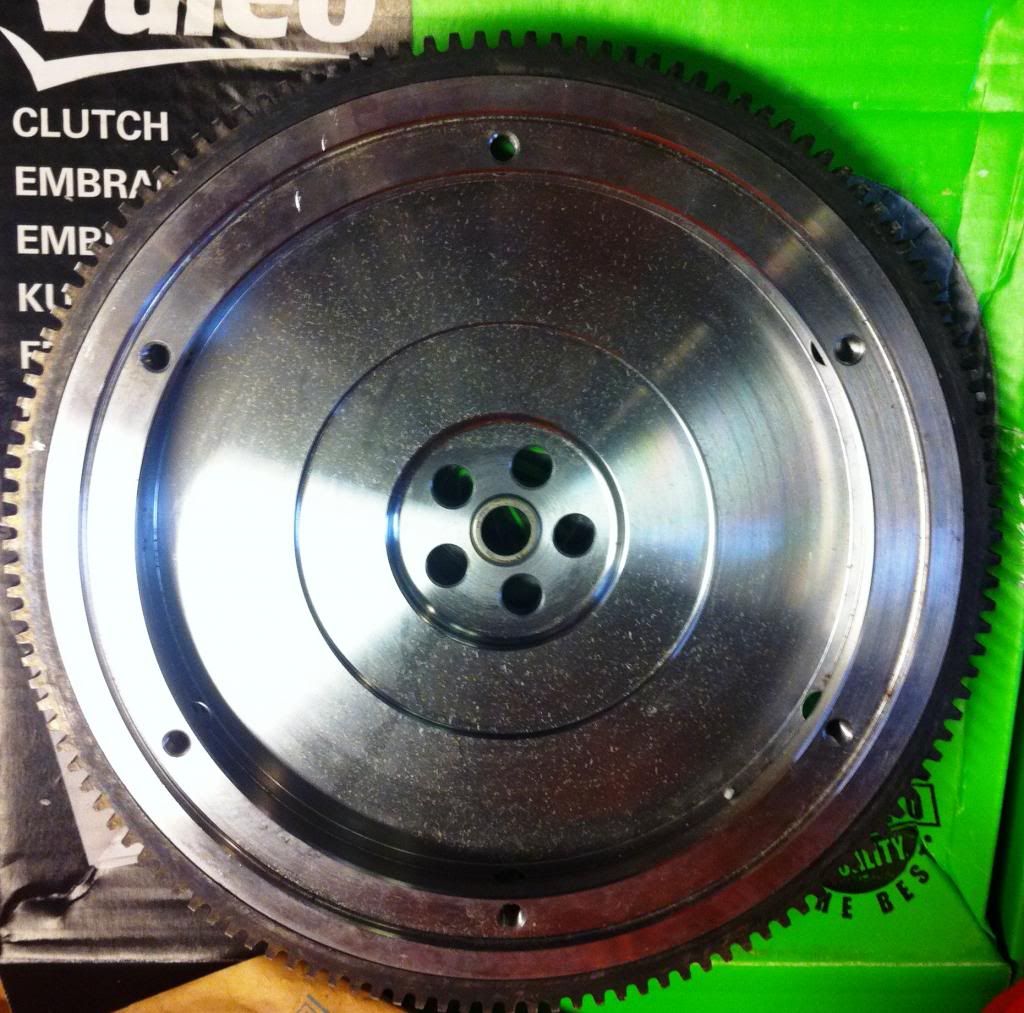

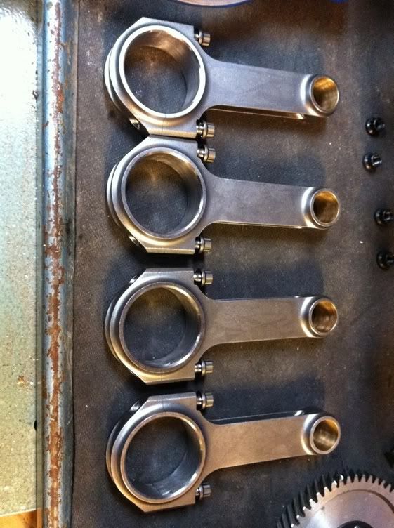

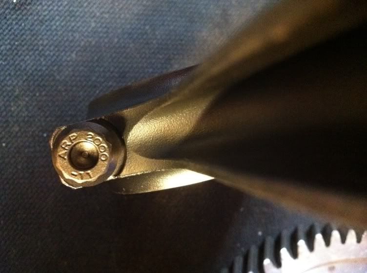

T IV length H profile rods and 200 mm conversion flywheel from Jake Raby

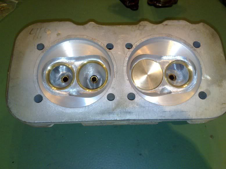

My TIV heads that I have tried to sell for quite a while but now will be core of the engine.

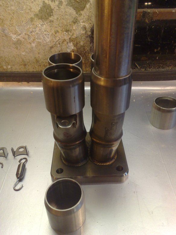

A twin scroll turbo good for 400 hp.

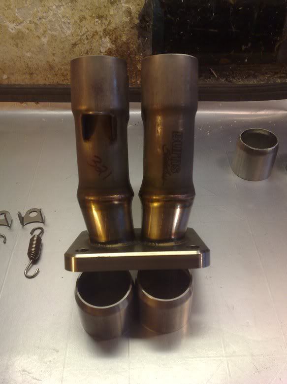

Short non equal length 38 mm stainless exhaust primaries
Burns collector

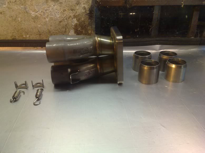

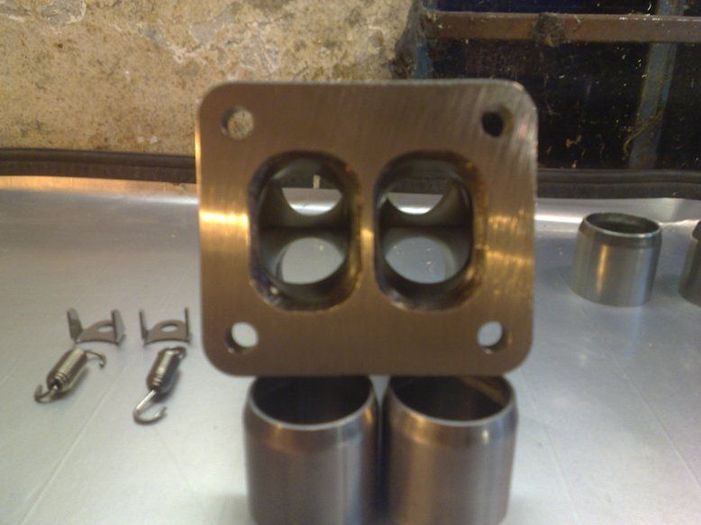

Double slip twin scroll 38 mm collector

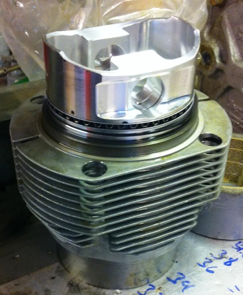

The AA biral 96 mm set with with JE forged looks good and measured round and nice. Al fins on steel liner
The Kennedy conversion flywheel looks good too, so far.

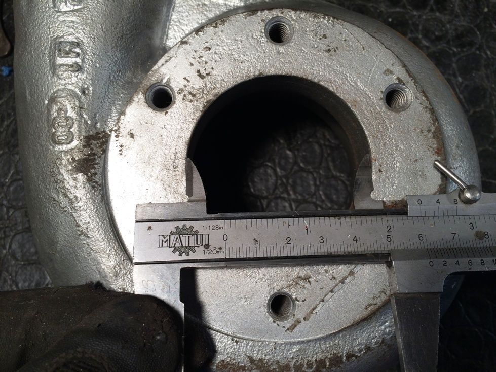

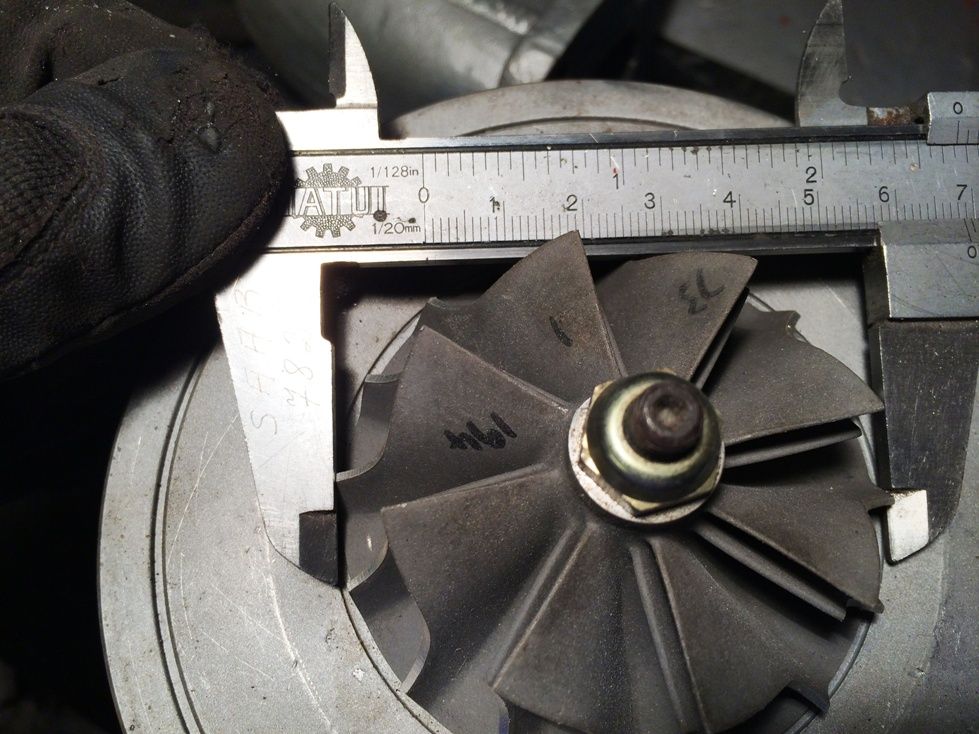

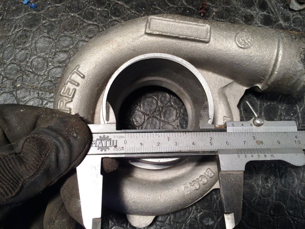

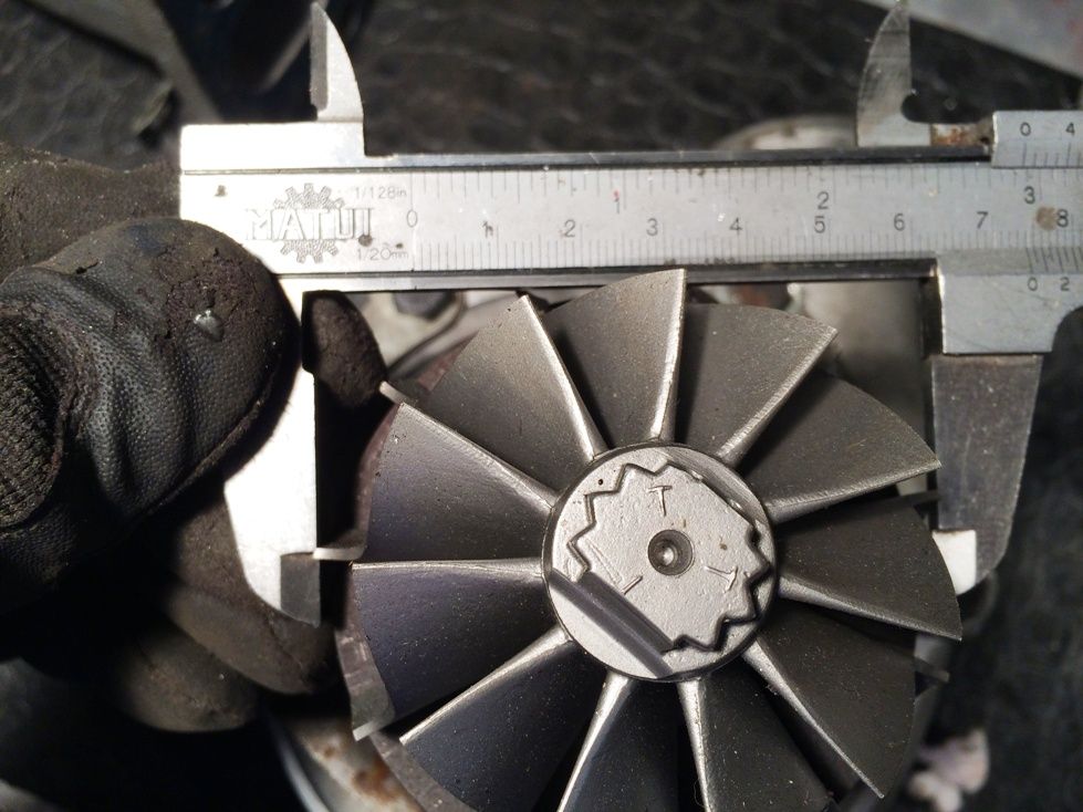

Re: Project X, engine #2 2056 cc turbo

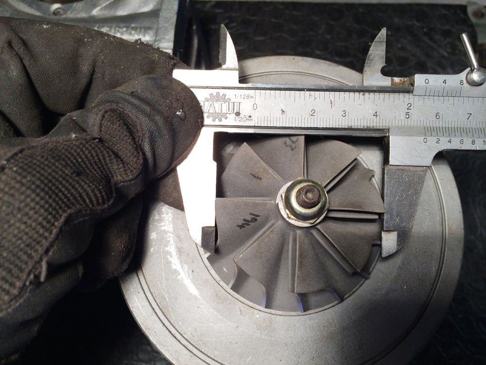

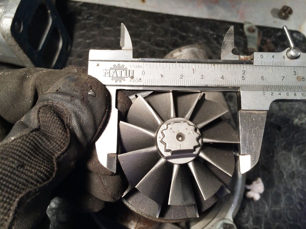

November 04, 2014, 21:05:30 pm »
What is it you need Wally?
Do I need to take the housing apart to measure?
I can do that easy for the compressor but turbine is more complex, I think.
I can then give you compressor inlet diameter too? Right?
Nope, I am not a turbo man....in that aspect.
Some of my cars:

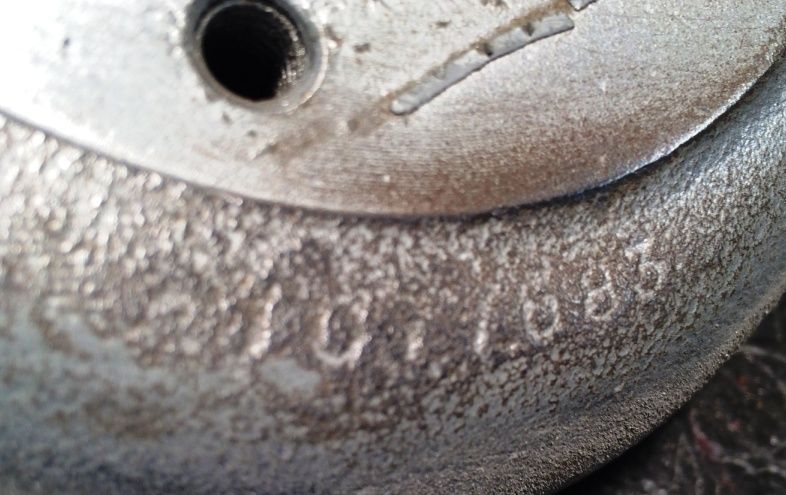

November 04, 2014, 21:33:02 pm »
Look, it was easy.
Does this help?
and this one but I can only read the 7683 number.
Turbo is a Garret Air Research.
Last Edit: November 04, 2014, 21:44:49 pm by Frallan
Some of my cars:
November 04, 2014, 21:46:48 pm »
Compressor diameter 68 mm
Inlet small diameter 54 mm
Turbine diameter 74 mm
Turbine small diameter 58 mm
Some of my cars:

Those are the ones Fredrik!
I'd say that is indeed a 400hp turbo, but on an aircooled that would be pretty maxxed out (very high boost) to reach that I think. 350 real hp would be its ball park under more sane boost levels in my guesstimate with the references I have.
But yeah, should be able to do the job

Good news. Looks like new inside. 1-3 and 2-4 paired? right?
Some of my cars:
Airspeed
Posts: 593
November 05, 2014, 09:58:33 am »
Quote from: Frallan on November 05, 2014, 07:56:09 am
Yep, plus try at least keeping 1-3 primaries and 2-4 primaries equal length as that works very well for spool and power on twin scroll turbines.

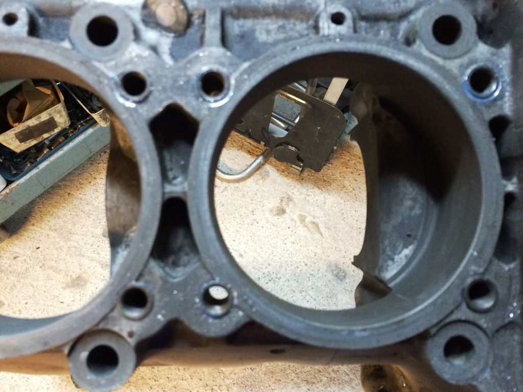

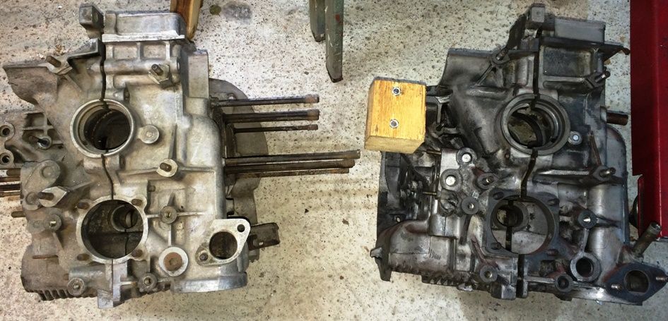

November 08, 2014, 22:09:20 pm »

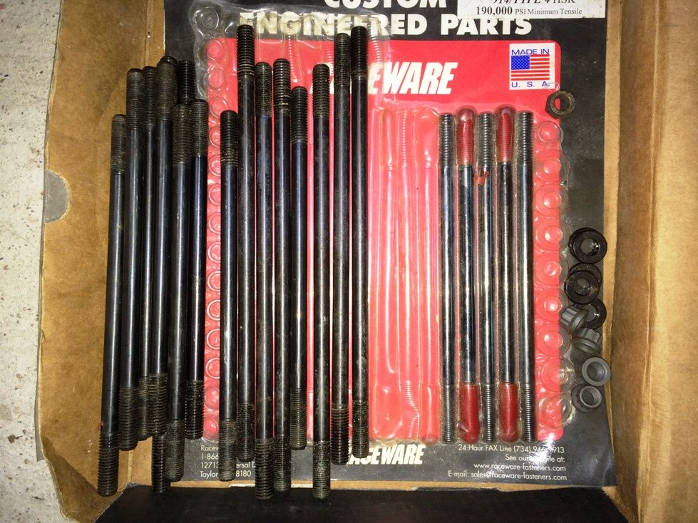

Here are the two water intercoolers that will be mounted in series in the left back seat space.
These are the two engine blocks. the magnesium one to the right will be used.

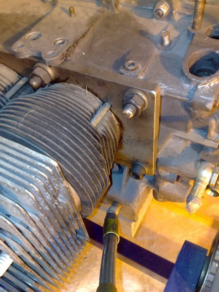

I know it is not the stronger but it is almost 7 kg lighter.
Been looking in to a slim steel plate conversion on the sides. Yes it adds weight..... hmmm thinking. But it keeps the timeserts for the stud in place and stiffens things up.
Maybe.
This is the good outcome of beginning to sort and keep my stuff in order.
I found a lot of Raceware studs. They fit this short stroke engine.
All I need is to order Timeserts and the 12 point nuts/washers.

November 09, 2014, 00:14:31 am »
Nice 'find' on the studs!

Quote from: Frallan on November 08, 2014, 22:09:20 pm

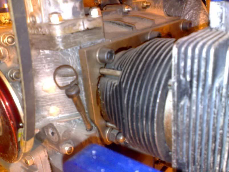

Maybe.
Is this the same type of thing as the steel backing plate I used on my SSP 1303 box, between the main housing and the end housing to reduce the shaft/bearings walking?
Would it be a plate on either side of the cases, under the barrels?

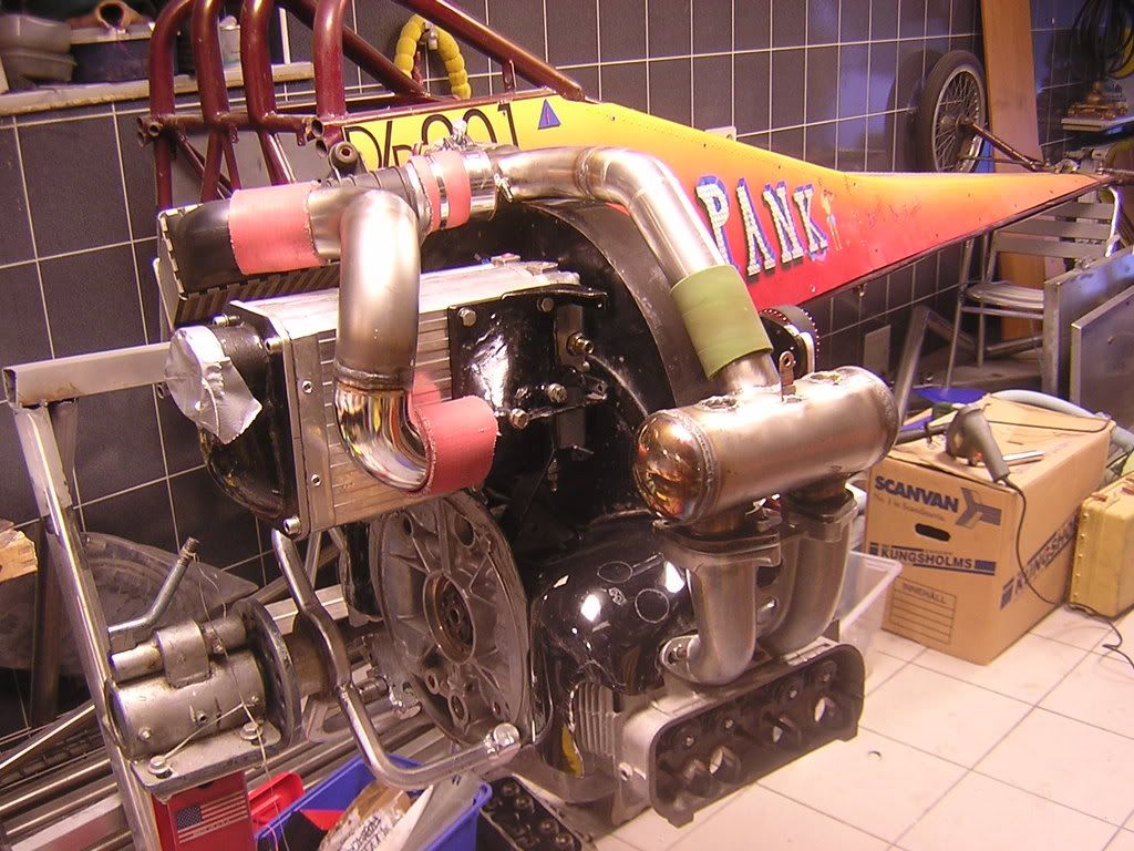

My dragster engine from 1978

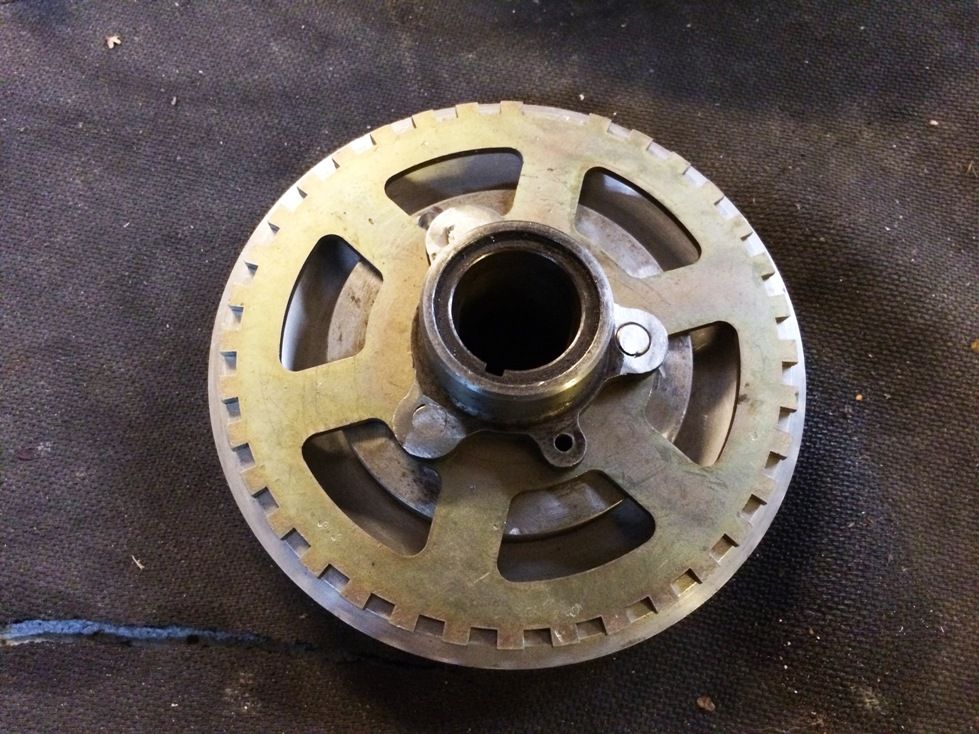

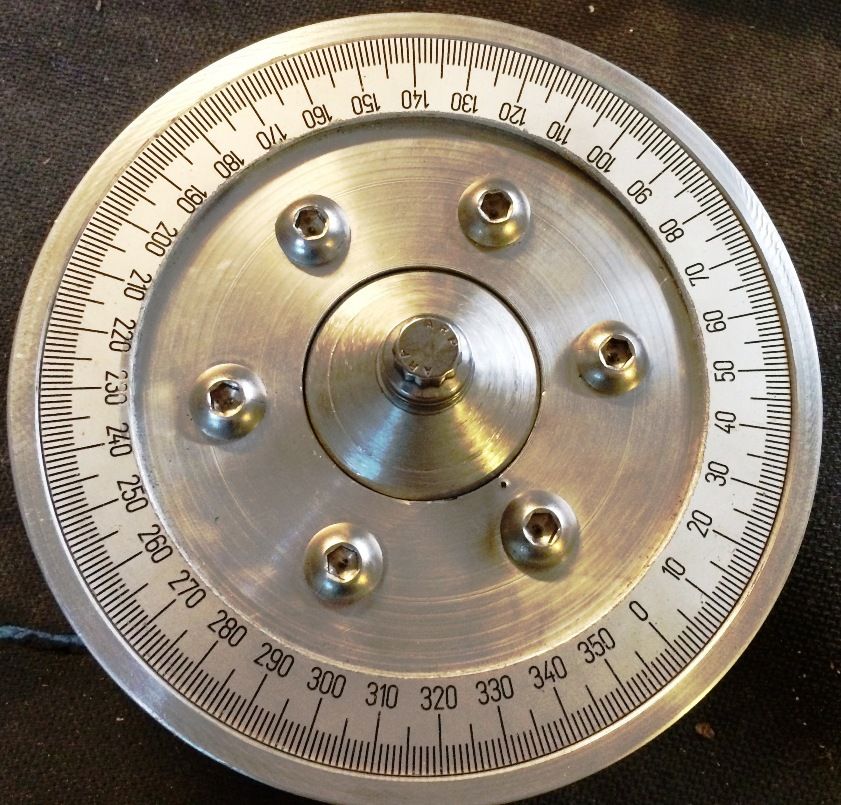

November 19, 2014, 19:00:47 pm »

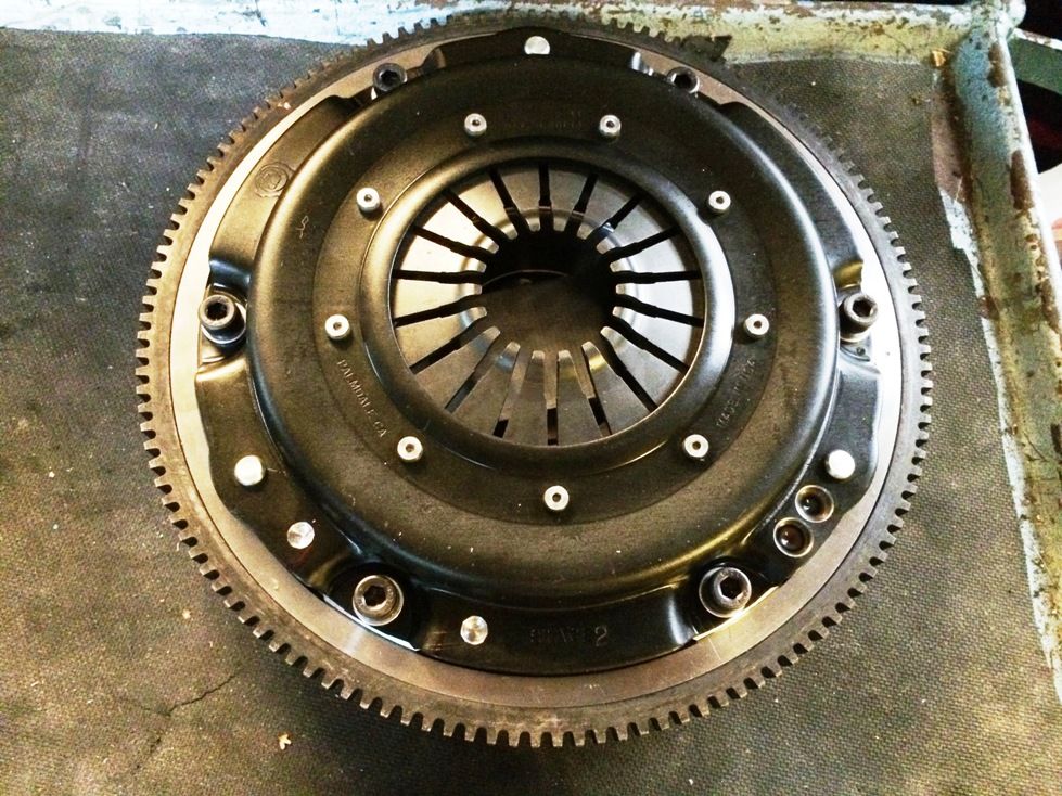

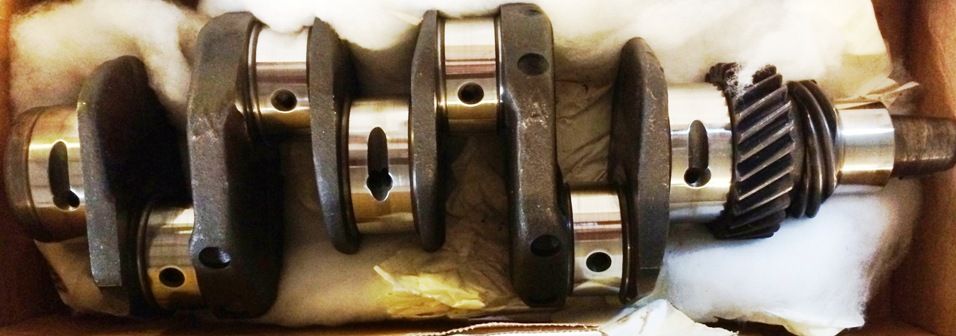

So we have a little bit of progress.
Crank is balanced with pulley, flywheel and pressure plate.
All balanced individually and then added on one by one, balance check on each added component and than as one assembly. Nice work Murre! Thanks!
Crank is checked and journals polished. Thanks Patte! I owe you one. (did you get the Aladdin box :-) ? )
Some of my cars:

Nice parts Frallan, but what dit you do with the oilholes on the mains on your crank?
Regards edgar
Regards Edgar
November 21, 2014, 11:19:49 am »
Quote from: Eddie on November 21, 2014, 09:57:50 am
Regards edgar
Nothing is my guess. Perhaps VW thought that a T4 engine could use some additional lubrication?
-BB-
November 21, 2014, 18:18:55 pm »
Yeah, that is OEM VW.
I did not even react to it. Seen it for years (35) like that.

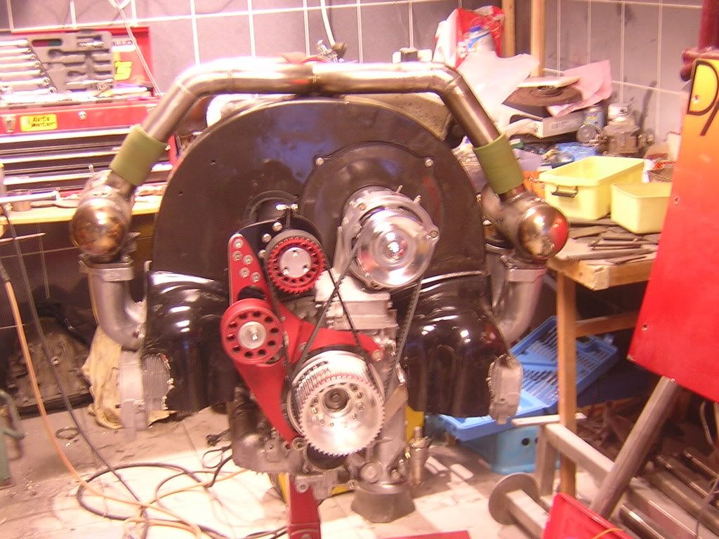

Nothing has happened as I have begun enjoying my engine current 2413 cc high rev engine until last week. I think I have either run a cam lobe flat or a lifter failure.
So with that in mind I decided to start building this one... or rtaher just assemble. It is pretty much done.
Using my mag case I now updated it with timeserts for the Raceware studs.
Then brake in and run it for a while with carbs, still turbo exhaust as pictured, then turbo.
More soon.
