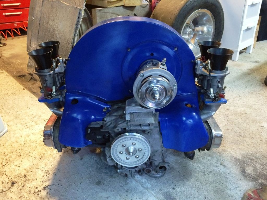

The magnesium block was not straight.
So now assembly with my al case.
Feeling good.
Will start it with Weber and then switch to FI and turbo as next step.

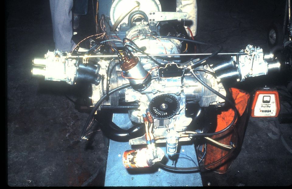

Shley brothers dragster 1973
Yeah, that is a TIV.

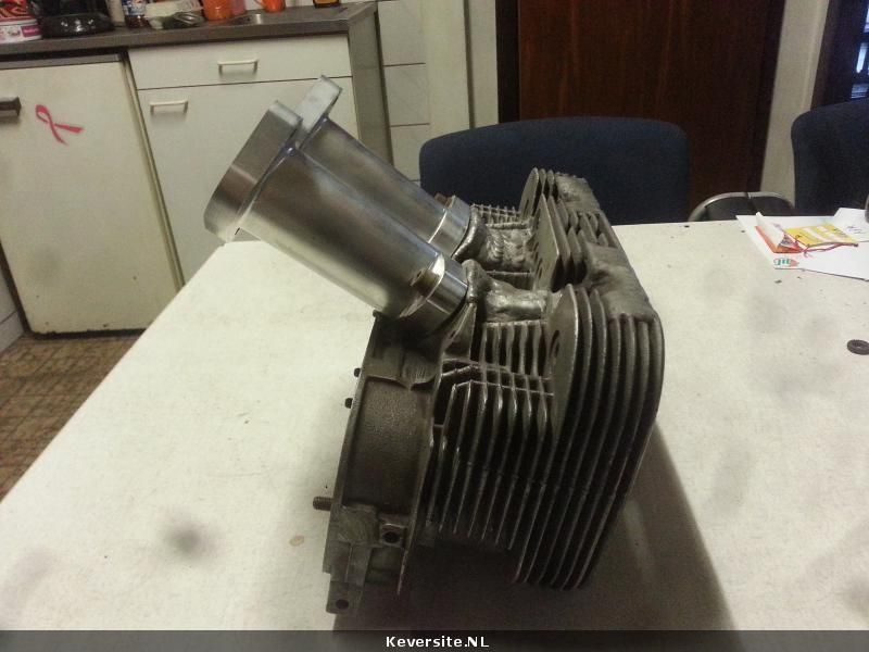

The modern version from Netherlands.
The year is 2014 to 2015
Did you say straight shot at the valve?

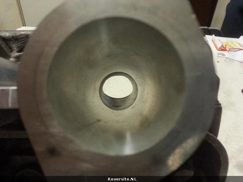

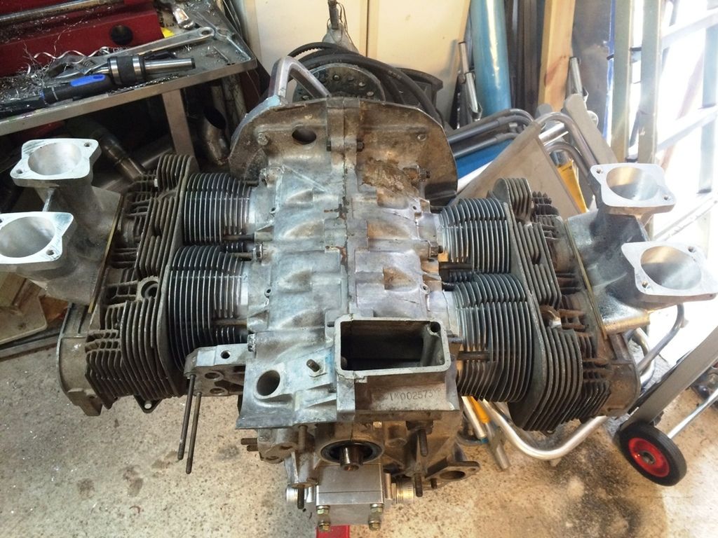

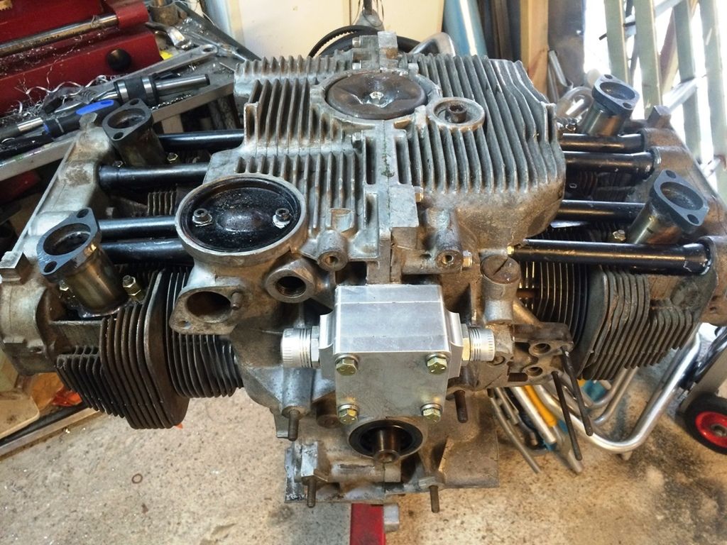

See anything strange with this engine and the second picture?
Well that is the way they will mate.
Sonic, I will give you a calculation and I will take for granted it is normal gasoline that you will use.

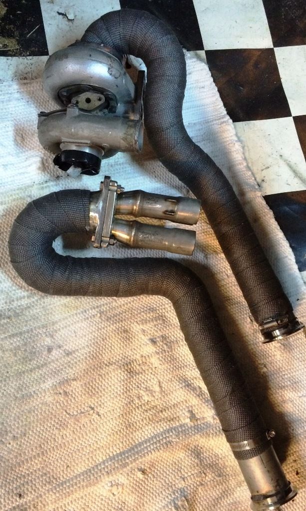

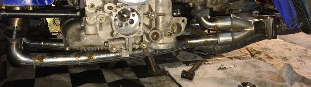

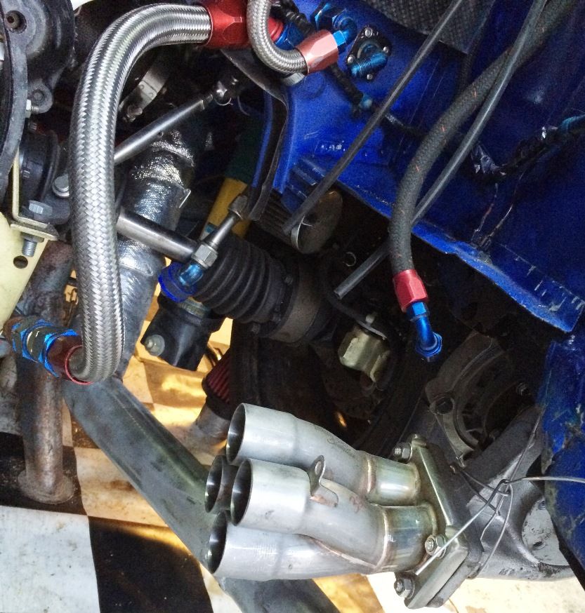

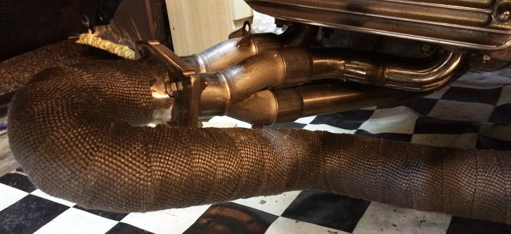

Turbo.....no turbo
Well well, start up and the break in without turbo.
Then Swedish style MOT inspection with carburators.
THEN turbo.

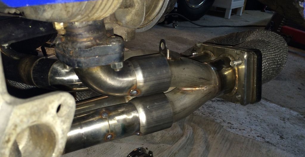

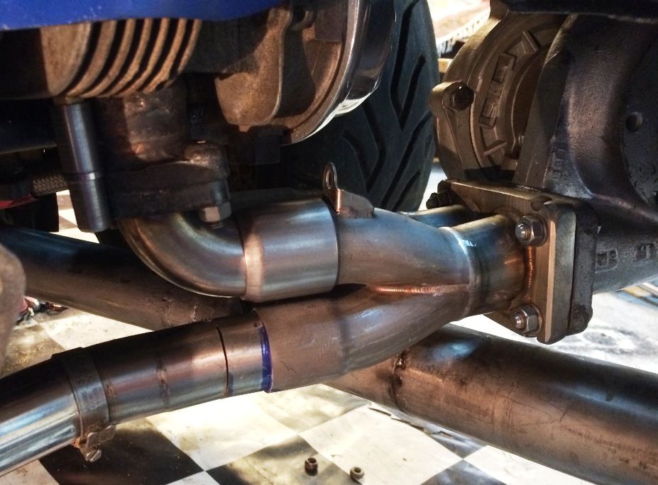

So now we have two end exhausts.
I am satisfied as with few hours every day, means something in progress.
Tomorrow refill of the argon bottle and then fire up the TIG.

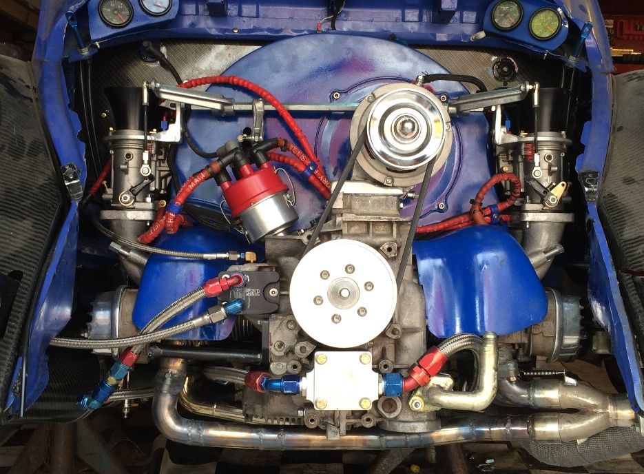

Re: Project X, engine #2 2056 cc turbo
Reply #45 on:
May 22, 2016, 13:37:59 pm »
nice!
Is it my idea, but what size is the crank pulley? different size than original?
Reply #46 on:
June 05, 2016, 09:09:59 am »
Hello Broen!
I have no idea were and when I bought that pulley. Like 10 years ago. I modified it as it apart from the grading has a 36-1 on the back.
But yes, it is slightly smaller than original steel pulley.

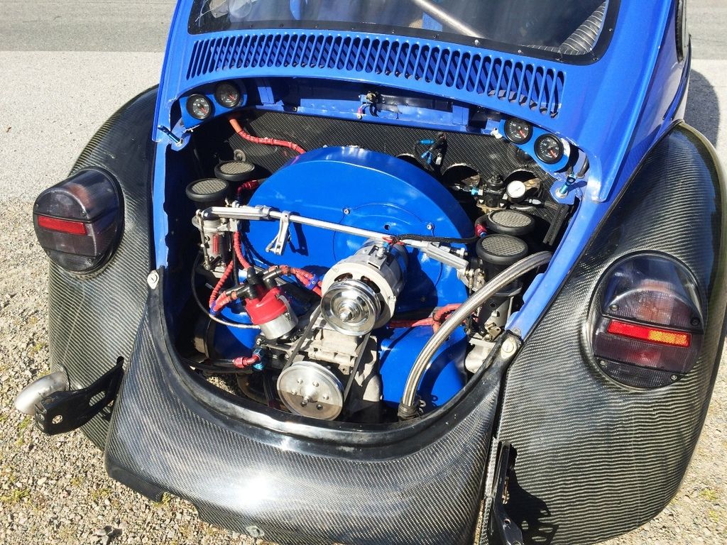

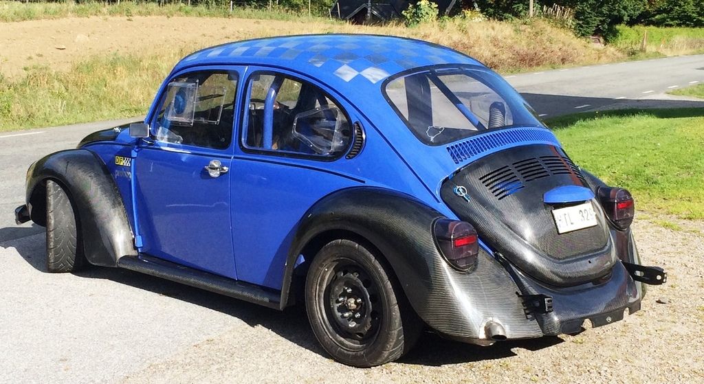

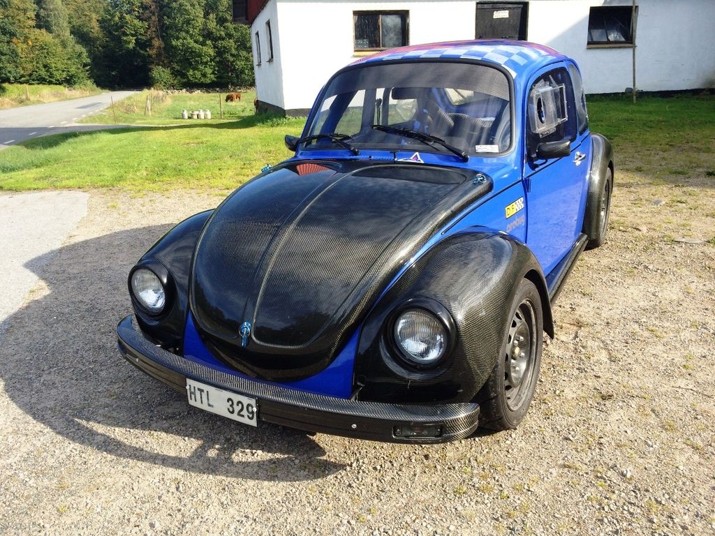

Here she is with the wider fenders, 17" and slicks.
Some more additions such as CF wing and few other updates are in the pipeline.
