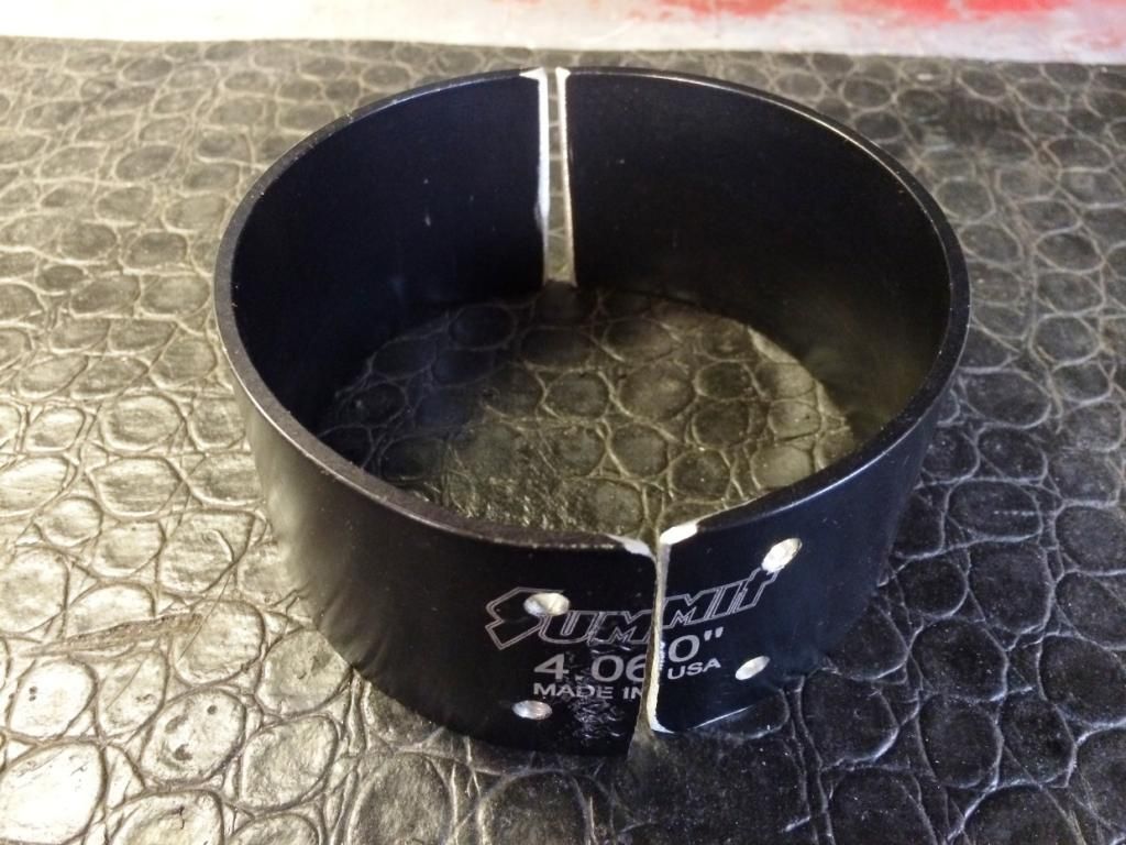

I start with a 4.060" V8 compression ring.

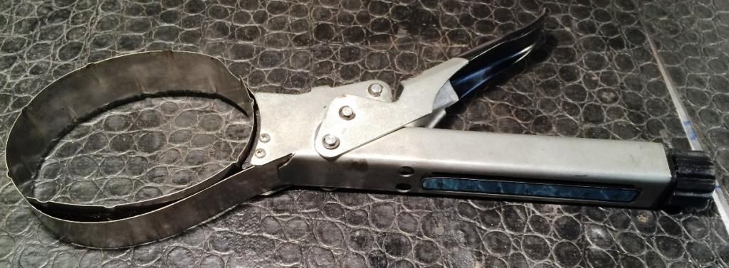

Alternatively like the one I pictured and Glenn.

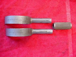

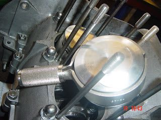

Few minutes invested on google and look what I found.
This is what I had 25 years ago for stock builds but it was lost to someone who "borrowed" it.
Now it is also what I will build out of my tapered ring compression tool from Summit.
First try was not good enough.

Yes, that is the best. But not if you have the rods installed in the case already.
Then you need a split one like the original VW tool.

I also have the ring compressor Glenn posted a picture of and it also works great, I use
it when my JayCee taper compressor don't fit.

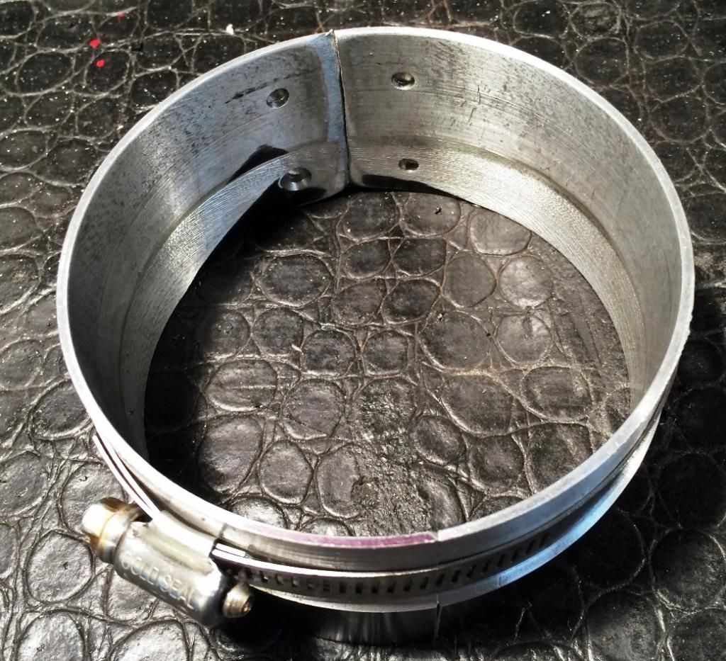

Just like you say, and it can be seen in the pictures, I have very thin rings (1.0 mm and 1.2 mm) plus low compression height with wrist pin support rail.
I will take my modified tapered ring tool and think out some way to make a split version out of it.

« Reply #10 on: June 21, 2014, 17:21:01 pm »
This low compression height, thin rings a and an oil ring that was tougher then ever. Not easy.
So finally I split my tapered compressor and made it fit my needs.
But not untill I took a high speed flapper wheel and slightly chamfered the nicasil cylinder in the bottom, did we become friends.
