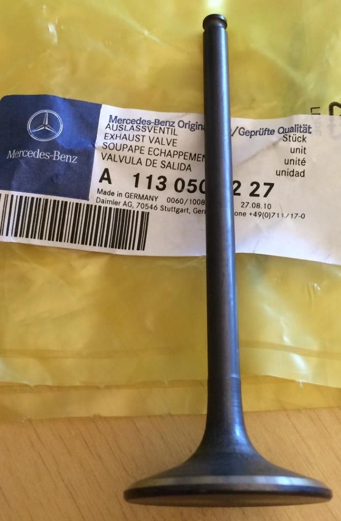

« Reply #1 on: June 26, 2014, 08:16:58 am »
Hello,
I think you are looking for this......!?
But the valve have to modify......shorten and insert the grooves.....
Best regards Thorsten

« Reply #2 on: June 26, 2014, 09:31:43 am »
YES YES YES!!!!

« Reply #4 on: June 26, 2014, 09:45:52 am »
I downloaded the MS catalogue. 3 valve engine. 2002 to 2010.
Now I will just go and buy them and fix the groove.
Just for curiosity I will also look for the intake but it must be another engine.
I needed that few months ago but ended up buying cutsom made valve from Manley.
50.4 mm and 7 mm stem.
Anyway, thanks again!
« Reply #5 on: June 26, 2014, 11:41:58 am »
Arrival tomorrow lunch with MB delivery from Hannover.
393 SEK each including Swedish VAT.
I am happy and I love when networking is this efficient.
« Reply #6 on: June 27, 2014, 11:51:30 am »
Now home and adjust the length and the grooves on all four.
Nice feeling!

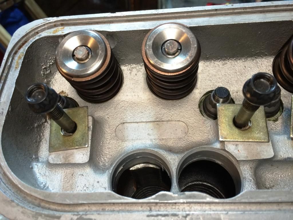

« Reply #9 on: June 27, 2014, 13:30:05 pm »
This is what was in the heads when I bought them.
Not enough for my Raptor cam and Pauter rockers.

i came out of my garage with a so called "ep" exhaust valve.
yes 122 mm, no modification here!
your retainers appear kinda small to me in comparison to the springs you are using.
i changed to del west retainers (titanium) and to better springs (cb vw650) because some ep retainers failed.
btw. i have a new set cb650 spring set and del west retainers left if needed Wink
no idea about the intakes.

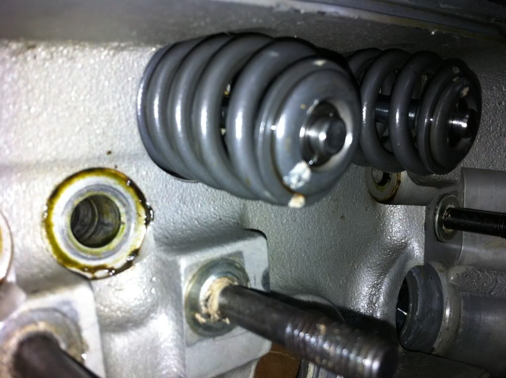

« Reply #11 on: June 29, 2014, 15:11:11 pm »
Hi again,
The beehive springs are excellent in many ways. One of them is the small diameter configuration on top.
The titanium retainer is only 3 grams.
This is Crower spring and retainer.
From left is a K750 spring.
Then a Comp Cams replecement spring for Chevy LS2 beehive style. Retainer is from PSI in titanium.
Then the Crower beehive spring with the 3 gram retainer
Then a CB650 with JPM titanium retainer
Far right is a Gene Berg double spring
Bottom picture is my current modified heads with JPM Oteva 75 Swedish steel springs and JPM titanium retainer.
So we have a very similar setup as CB650 and JPM springs are pretty much interchangebale. Good stuff both.
