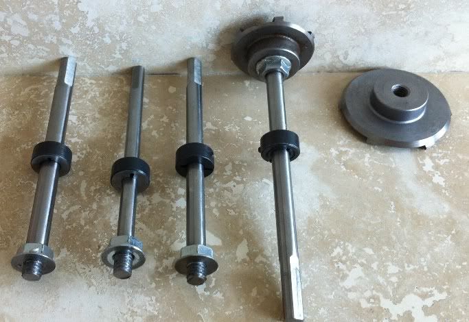

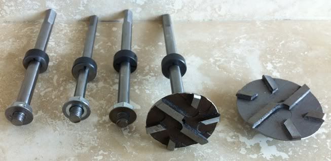

Re: DIY piston notching
January 31, 2015, 19:18:51 pm »
My nice little set with many different spindles.
http://www.lindytools.com/#
!cuttersandtools/c13ps
Nice company to deal with.
Last Edit: January 31, 2015, 19:21:28 pm by Frallan

Quote from: Frallan on January 31, 2015, 19:18:51 pm
Love that gear, Far better tools,^^^^^**** I did it the old way with home made cutters way back, but modern forged alloy is so tough, it will just dig in and break something or other, I admit to die grinder work on pockets, sometimes you just gotta go racing, but it's then you realise how tough quality Pistons are, it's hard as nails, the old brazed up cutter will just dig in and wreck something, Do it right and cry once eh?
Best regards, spanners.

Spanners, I do not know how you did that???...... but above is NOT a quote by me. Look like you are answering inside my quote?
Some of my cars:

Frallan I like those tools and watched all their videos , thanks.
