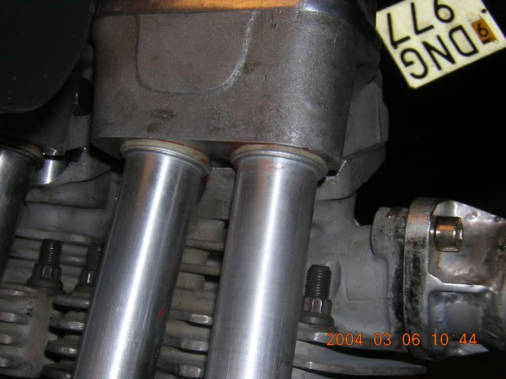

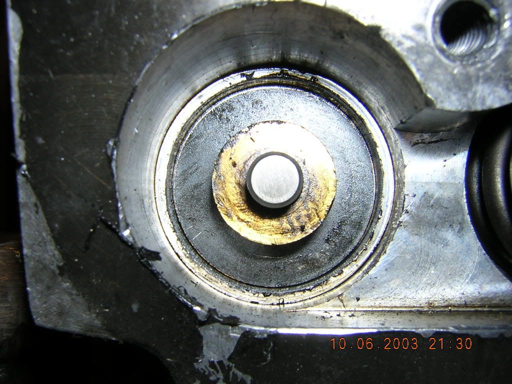

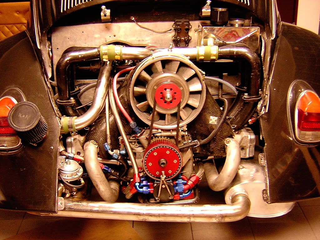

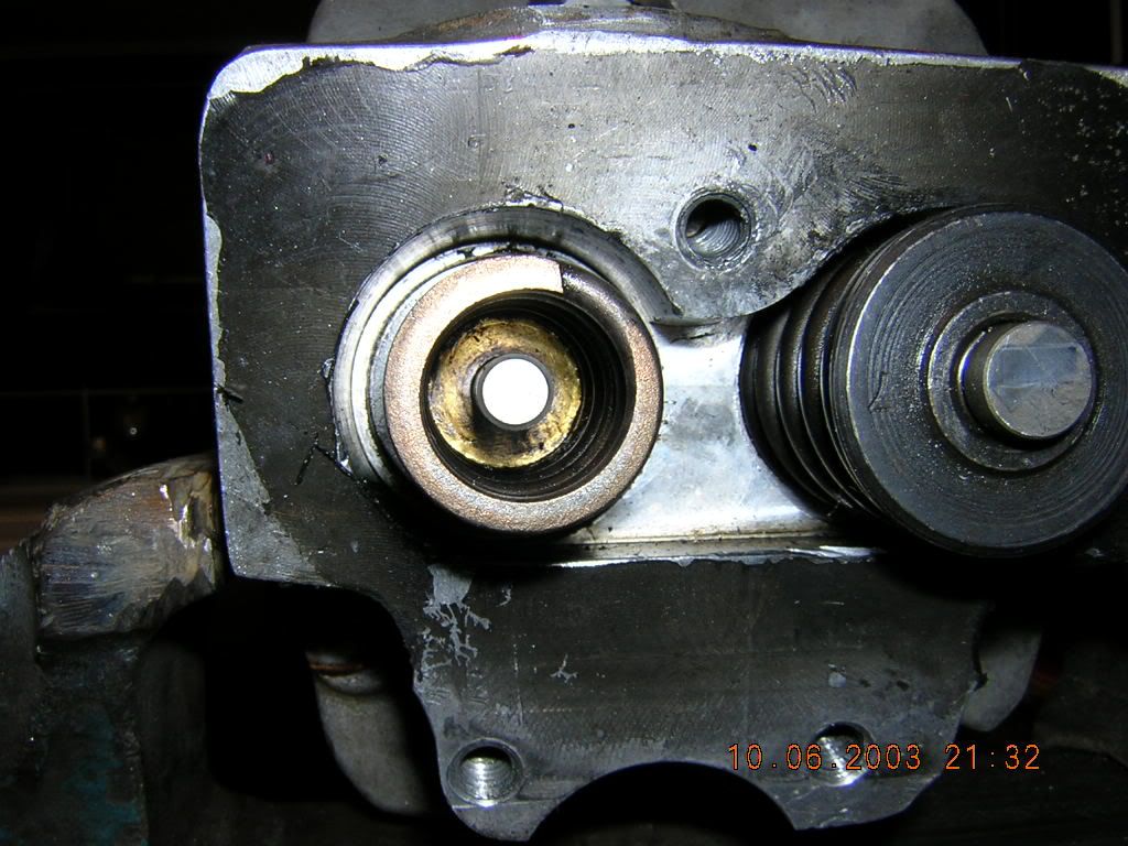

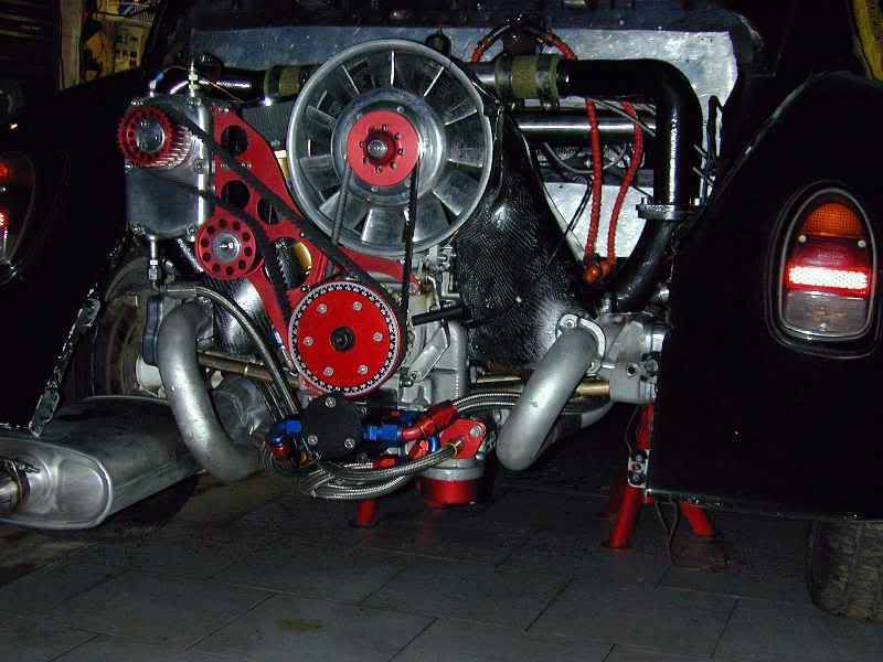

Ran these heads for several years.
Plus in several different configurations but most miles were with 48IDA.
Never liked the rocker shaft solution but SCAT new development took care of that.
In fact I liked the heads pretty much.
Did my own guides as I ran 5/16" stems and with innerspring guiding plus pressfit outers.
No extra spray cooling. Good idea though for any air cooled engine.
Dropped a Manley valve but it was my own fault. I had a mark on all stems from the lathe. Pretty stupid but I learned and engine was idling. Lucky.
Fixed it and ran at least another year.
But no, I would not buy another set. Too many other better options out there.
« Last Edit: March 20, 2015, 21:47:59 pm by Frallan » Logged
