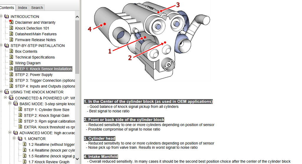

Where do you find is the best location to mount the ring-style knock sensor?
Stripped66
Center location on the block if you only have one sensor.
Good stuff from the Plex manual. :-)
Stripped66
Let me clarify...where do YOU find is the best location to mount a ring-style knock sensor on an AIRCOOLED VW?
I'm not looking for an instruction manual answer. I can see where the OEs put the sensor. OEs typically mount the sensor transverse to the cylinders (as pictured in #1 above). Does that mean the top of the case in our application? What about parallel to the cylinders, such as on the face of the case (between the tops of cylinders 3/4)? Any specific location that is more advantageous for signal to noise ratio for our anecdotally noisey engines?
« Reply #8 on: November 08, 2015, 00:29:58 am »
Sorry Stripped66,
This is my clarification:
On one of the through block bolts.
Usually done with a thick steel extension plate so you get full surface connection on the knock sensor.
Second best is the center M8 bolts but this option gives you less surface and is not as good.
