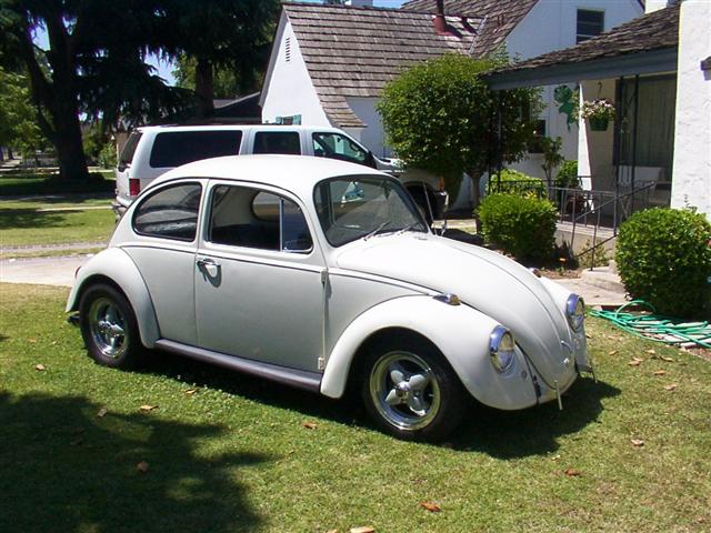

Since I like reading everybody else's build threads, I thought I should do my own.
I have a 1972 1200 Beetle - this was bought new by my grandfather who passed it on when he stopped driving in 1988. It was completely and utterly stock back then, all the mechanical stuff was perfect (my grandfather was a police driver and i think that made him pay close attention to maintenance), few scuffs here and there on the wings. All I definitely remember doing was replacing the crossplies with radials plus a load of polishing and a little bit of filling.
I drove it around like this for about ten years before it became clear work was needed. So in 1999, two months before I got married, I tore it apart and Paintbox worked their magic. New doors, wings, dechromed what chrome there was, 2" narrowed beam, '61 short axles, lucas indicators. The suspension work was to allow me to fit the set of American Racing Equipment LeMans rims I had bought which is what really started the whole thing off. I totally blame Keith for this as he had them for sale at Slough Swapmeet. At this point the rims weren't ready and the new motor was still just an estimate. But off I went and got married:
About a year later I had the rims on, motor in and I showed it at Volksworld 2000:
Showing cars turned out to be hard work, so I concentrated on driving instead. I don't use it a lot, but I use it when I can and all year round. The annual inspection started to get a little stressful as a result of some rather annoying rust in key places, so it's rebuild time!
Motor is 69 x 90.5; Fumio Heads; Engle 120 cam; Dellorto 40 DRLAs; 42mm Python exhaust with 1.75" cone and 42mm heater boxes; Mallory distributor.
There's lots of tidying up to do, not an awful lot of modifications to make because I'm pretty happy with the way it is. I am finding that sourcing standard parts for this standard model car can be tricky at times and impossible in other times (especially for the aftermarket parts). Hopefully some of the these things will be interesting and possibly useful to other people.

I've been looking in my photos and I really need to take some better photos! Here's a few for you:
The exterior isn't massively different from stock: shaved the thin side trim and indicators. And those rims. I love my rims. One thing I am going to change is the centre caps: the centre has the more modern logo and I have a new set with the older American Racing logo with red and blue stars on.
Not a radical change here either. My grandfather bought that parcel shelf - I don't even know who manufactured it. There's a fire extinguisher, Berg shifter, gauges. Eagle eyed observers will know that the seat belts weren't standard equipment in 1972, my grandfather specified that option. I've added static belts in the rear: that was to secure the seats for my kids. I really like the 1200 interior. I replaced the driver's seat cover last year as it had ripped. Other than that, it's just plain old stock.
Motor. I could write a lot about what I've done in here. Notice the air hoses for the heating - works really well with CSP heat exchangers. I replaced the 009 with the Mallory Unilite because the 009 advance mechanism failed - and I liked the ability to adjust the advance cure via different springs, which I have obviously never done!). There's no mechanical fuel pump - after a variety of failures I moved to an Autometer pump, which was way too loud, and then to a much quieter electric one (can't recall the brand at the moment) and that's doing the job very well. Notice the Autometer fuel pressure regulator mounted where the 'diagnostic socket' used to be? I am planning to replace the rubber hoses with braided: I have the banjos to fit the carbs already. I had to rebuild one of the carbs (reversing the throttle spindle) as it was the 'wrong way round' - the return spring was at the front of the engine rather than the back. I remote mounted the oil pressure sensor because I added a oil pressure sender and I didn't want the added weight to cause any breakages. I could go on....
