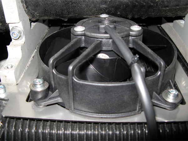

Quote from: Jim Ratto on June 04, 2008, 23:41:44 pm
here's what I did to force cold air (compared to ambient near cooler) through my Setrab
Jim, where do you "pick-up" or "intake" youre fresh air ?
Done ? Not Yet.
Re: front mounted oil coolers?
Reply #61 on:
June 10, 2008, 16:50:24 pm »
Quote from: FDK/Hurry on June 10, 2008, 16:31:31 pm
the "opening" is just below/behind RH rear torsion tube. It's a simple "box" about 10" wide, 3" high, I used two 113255165 VW fresh air pipes and 113119585B grommets going through rear wall of "scoop", connected to two 50mm Volvo hot-air hoses p/n 946841 that run up over trans and into duct I made to feed cooler/fans. I think it may work "too well" as last Sunday I was running hard up 57 freeway and once oil got to 180F or so (when fan is triggered by thermo switch), and the fan came on, the temp would drop a bit below 180F. I may switch thermo fan temps,

BUt aftermarket Bugpack without fan is not good for a 1776cc engle 120 IDA48 motor?
i MUST to install a MESACOLER, cagero ECC... ECC...
can i see a photoes of right installation position?

Quote from: banditina on July 22, 2008, 08:38:08 am
heres mine . excuse the mess !!!

Quote from: Bruce on July 27, 2008, 19:33:00 pm
Quote from: monkiboy on July 27, 2008, 19:21:11 pm
DUDE that looks rather risky
Being centered to the axle means that when you hit a bump, the cooler rises with the car. If you run a Berg style intermediate mount, any rocks that kick up will get deflected out of the way.
Wouldn't bother me to put the cooler there.
Its not the "Bumps" I'm worried about so much - its Road debris!! the Cooler is also now the LOWEST point on the chassis - NOT A GOOD IDEA!! just my 2 cents though
Bruce
Posts: 1424
Reply #88 on:
July 28, 2008, 16:40:54 pm »
If you have a Berg style intermediate mount, IT is the lowest point on the chassis.
Reply #89 on:
July 28, 2008, 17:56:10 pm »
Quote from: Bruce on July 28, 2008, 16:40:54 pm
Hmmmm I guess but fitting a berg mount JUST so you can mount the cooler there - seems alittle wierd to me
