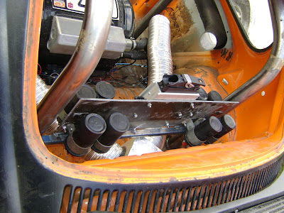

Added the intercooler /spoiler this week, waterinjection is made to work better to, this should get temperatures under control.

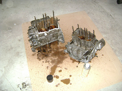

So I told you guys we we're going oxyboxer. Here are the first pictures.
Case registers are reduced by rings to fit type 1 jugs and threads in case have been moved to fit type 1 heads.
In this case it will be 77 mm cilinders and 1300dp heads with twin plugs. The crank will be 69mm from 1900 wbx.
thinking out of the box will get you to go faster cheaper in the long run, time is on my side

Picture of cage, feultank and coilpacks for twin spark coil on plug.
Last Edit: April 20, 2010, 21:13:08 pm by ruffbiker

Quote from: ruffbiker on March 24, 2010, 20:37:49 pm
hi jessi, how did you relocate the stud holes? is this a kind of JB weld? or how did you do that?
wishes from germany
chris

Reply #48 on:
August 29, 2010, 19:31:27 pm »
we drilled the original holes bigger, threated them. inserted a big bolt and rhen drilled a new hole offset in the big bolt.

Posts: 76
Re: 1200t1=>1300t5 turbo
Reply #49 on:
August 30, 2010, 12:30:38 pm »
thanks jesse, that was my second thought.
why the 8 coils? would not 2 coild and a nissan cap be more than enough?

Reply #50 on:
August 30, 2010, 18:48:08 pm »
Coil on plug seemed nice to have. been thinking about something else too. Wont be nissan but other make. I'll post a picture when I'm done with the idea.
