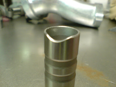

What's this notch for?
http://1.bp.blogspot.com/_DQFlAjUcz4o/R6sK7OgLiwI/AAAAAAAAAWk/48jnQJEiRbM/s400/DSC00644.JPG

Quote from: Bruce on May 18, 2009, 00:25:28 am
There was a small pice missing on the lifter, see this picture, i had to do something. And it works well.
http://1.bp.blogspot.com/_DQFlAjUcz4o/R6cK1OgLisI/AAAAAAAAAWE/ECVxYvFT__Q/s1600-h/DSC00637.JPG
