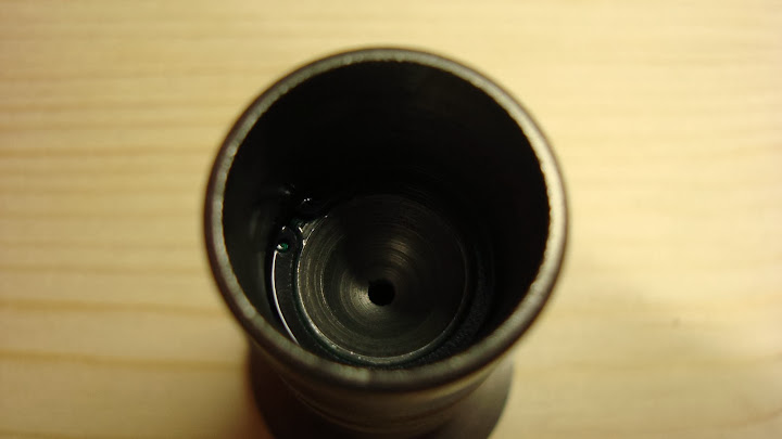

generally speaking they are of a good and affordable quality. For peace of mind, take them apart, check the snap-ring for burrs, degrease the lifters, put them together and put a drop of green Loctite (formula 290) on the snap ring.

Check that the snap ring is in the right way round too. On one side of the snap ring there is a radius and on the other the face is flat. The snap ring (circlip) is better seated when the flat face is facing upwards when you look down as in the photo pictured above. The sets I have seen have had the circlips fitted both ways randomly. Worth checking and sorting. Regards and congrats on the fantastic work on the Kebabriolet, James! Matt
