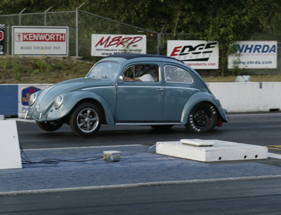

HI Tobi,
I think you'll find the engine comes to life with the bigger vents.
Peter,
In the past I've used the engle 120 and 125 in my 1914's - They were nice. The 86b was recommended by the guy that did my heads (K-roc - in our club) It is a nice cam, comes on strong and pulls hard all the way up. The thinking is that for a street car with stock gears - a little less duration helps build more cylinder pressure and hence more torque. The heads help with the breathing up top so I don't run out of steam.
I do have the third progession hole. The jetting right now is F7 - depending on the track conditions I run a 160 or 165 main and anywhere from a 190 to 210 air. Our track is near sea level. For idles I run a 120 air with a 65 - Bruce in our club recommends soldering up the 120 and then re drilling to a 110 or 115 - I still have to do this.
To give you an idea of the torque -
This is a 3500 - 4000 launch with out a burnout.

Damn that is nice! And you are doing that with a stock tranny, or is it a stonger gearbox, but with the standard ratio gears?? If it is a standard box, no fear of breaking it doing this?? Which shocks do you run up front?
I wanted to keep an original gearbox as well (at first anyway), but I as thinking of converting to IRS for several reasons:
- I have a good 1303S geabox laying here, no decent SA gearbox (so nice highway cruising)
- Handling due to IRS set-up
- Easy to change gearboxes in case you break it (really important!), you do not need to touch the brakes while changing the box
- Since I plan on driving it regularly on the streets and I want to run FUCHS wheels (4,5 and 6), the obvious choice for disks are Porsche 944 disks (super easy with these a-arms and cheap cmpared to other diskbrake converions)
I know, maybe not 100% in line with the cal-look theme, but I consider these important safety upgrades.... But I just need to check if the 6"FUCHS with 205 tyres will still fit the original fender with this IRS set-up...
