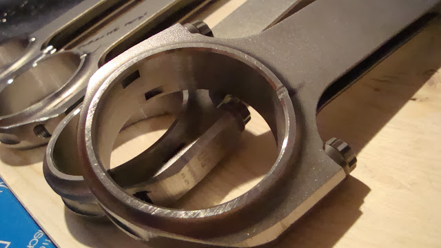

hi my friend need to know how is the right way to position H rods by empi...
he says that it has a number only on one side...and not not the "I" like originals ones..
the side-number have to been down, up or is it the same?
excuse me for my bad english...but technical questions (and answers!) are difficult for me also in Italian! Grin

The bearing tang notch goes down.

 i hope i traslate correctly "bearing tang"... Grin
bearing tang= numbers
right?

Bearing tang is a recess in rod and rod cap where the rod bearing is secured:
Anyway I raised the same question some time ago and was told that H-Beams are symmetrical so they can be installed both ways.
Only common habit says to install the bearing tangs down (facing to cam) so I did.
