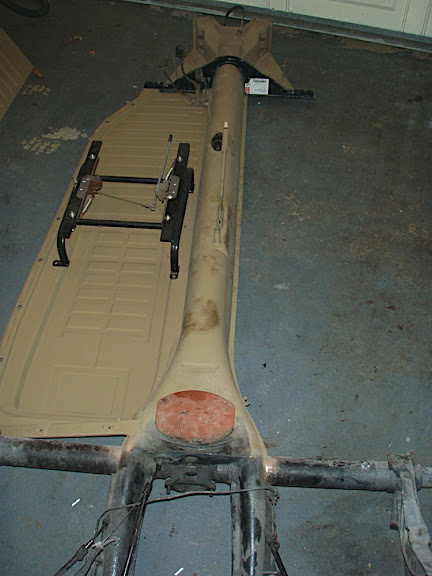

I wasnt happy with the chassis I bought all those years ago. I think it was a late 60's item due to the wide 5, but it also had weird chunky rear arms (check the pics)
Anyone know anything about it?
I wanted the collar & cuffs to match!
So luckily for me (and thanks to various people on this forum for helping me with my dumb ass questions) I located a guy that was breaking a 53. So I had the chassis, doors, bonnet and various other bits off him.

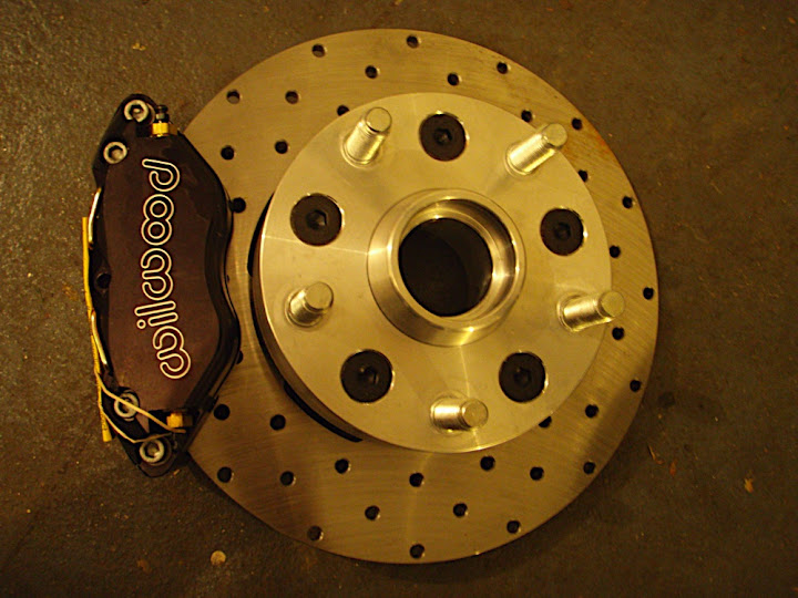

I wanted my car to stop well so after a bit of research I decided to go for the CB Performance wide 5 disc kit with dropped spindals
Nice!
I also really wanted to go Torker!
So I bought these guys...
Typical me its a bad combo! The dished back spokes of the Torkers foul the calipers! DOH!
So... I needed to re-think...
Looks nice though huh?
I also found that the offset of the wheels, combined with the wider track of the disc kit meant the wheels also fouled the arches quite a bit. After speaking to another guy that was very helpful about all this the solution was to narrow the beam AGAIN removing a total of 5 inches!
So I decided to to go a different route..
So now Im happy
