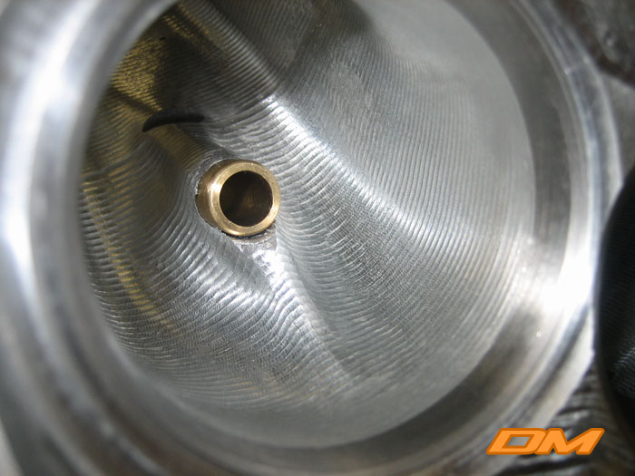

« Reply #404 on: January 22, 2013, 09:50:45 am »
Interesting picture and statement:
I know very rough works , i'm at probably 15+ engines so far in my tests and all 15+ have gained , its been 100% so far. Its ugly, but it makes HP!
-BB-
« Reply #405 on: January 22, 2013, 12:10:47 pm »
Not ugly.
I love it!
How is that "uniformity" done?  (cannot think of another word right now)

that is amazing work,I am not sure many of us need to go to that extreme,the hours in it proberly wouldn't justify its cost

looks like snake skin....or golf ball

Think I seen that on Yellow Bullet. CNC programed

Done on this machine http://www.rottlermfg.com/cylinder-head-shop-machine.php?model=P69   wicked looking finish, search for dimples intake on google and many more intake results pop up. Some interesting approches some guys have...
Rottler 5axis has some other tricks:

http://www.brighthubengineering.com/hydraulics-civil-engineering/58569-how-golf-ball-dimples-reduce-air-resistance/
