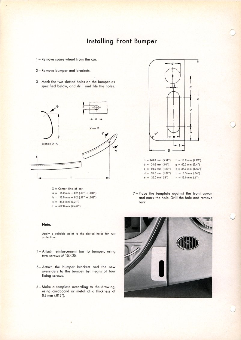

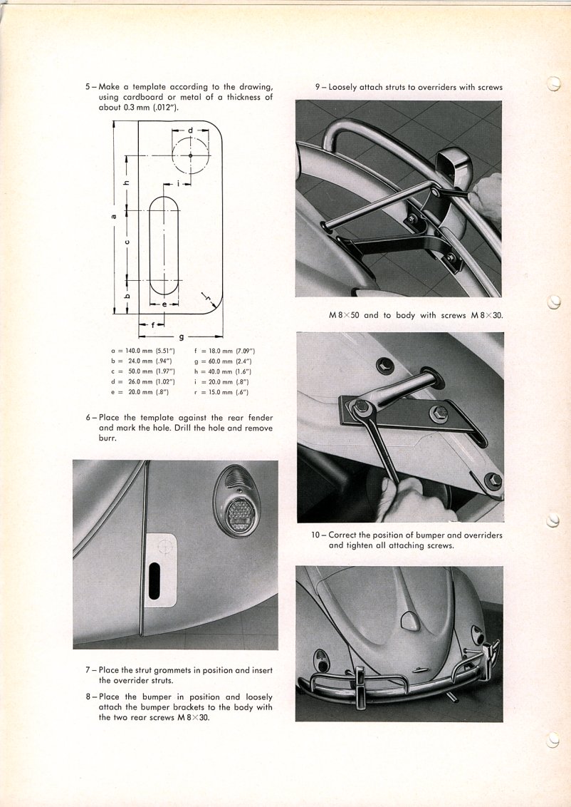

well I have I have one set of bumpers from Mr Richie and I am waiting on a pair from Mr Ratto - My plan is to make the nicest pair out of the two and then fit them properly to my 65..... Now this is where I have a slight problem  Undecided Roll Eyes
Being a "Norwegian" car ie EUROPEAN spec I do not have the 4 extra holes for the surport bars for the US spec towel rail bumper
So.........
I am hoping someone can provide me with the position/location/dimmensions/placing of these 4 holes PLEASE  Grin

Rumor has it that he locations of the holes are to be found in old VW workshop manuals. Not your ordinary Haynes manual but the real VW-ones that the dealerships used back in the day. When replacing body parts they didn't necessarily get the front valance or rear fender with the holes in them and had to make them themselves.
I think I can get to my oval and measure sometime later this week. But it will of course have the bumpers and support bars mounted, it would be better to measure on a valance/fender that has the hole visible to get it right. As I said, it's critical to have these holes 100% right, not much room for playing around.

« Reply #4 on: July 08, 2013, 01:10:31 am »
Front...
http://www.thesamba.com/vw/archives/manuals/techbulletins/a7/3_58_page2.jpg
Rear...
http://www.thesamba.com/vw/archives/manuals/techbulletins/a7/3_58_page4.jpg
Please give all credit to Everett Barnes and TheSamba for archiving old VW Workshop Bulletins Wink
« Reply #5 on: July 08, 2013, 12:26:56 pm »
Perfect  Grin
I knew they would be out there somewhere - I was just being lazy  Wink
Thanks again guys  Grin

« Reply #9 on: July 13, 2013, 21:55:49 pm »
I have made up 4 templates if anyone else needs them  Smiley
