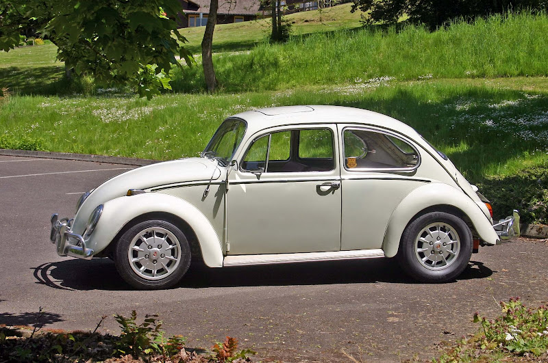

Hi Dave, here is a pic of my set-up. 69' with 2" drop spindles with repo GeeBee's, But does have a 2" narrow beam. Have no issues at all. 145 tires and disk brakes.
Last Edit: June 04, 2009, 17:08:38 pm by Racecraf
Re: wheel combo advice needed
June 04, 2009, 18:22:49 pm »
Stock drums? Yikes.

I run a stock width beam in my 66 with drop spindles and real Gas Burners on 145's w/disc. The ball joint clears, but not by a ton.

I got all my suspension stuff from Russel at Oldspeed. I would have to look up what spindles he sent me. My wheels were clean when got them and still have the original primer/paint on them.
No adjusters in the beam, I would like to get in down a little more in the front. With a tank gas and interior I think it will be right where it needs to be.
The Ball joint has about 10mm of room right now.
