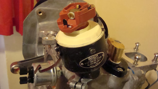

Well I´m a distributor freak:-) I already have a 010 on the engine:
I also have another two new 010 in my parts cabinet (from unused military industrial engines)
