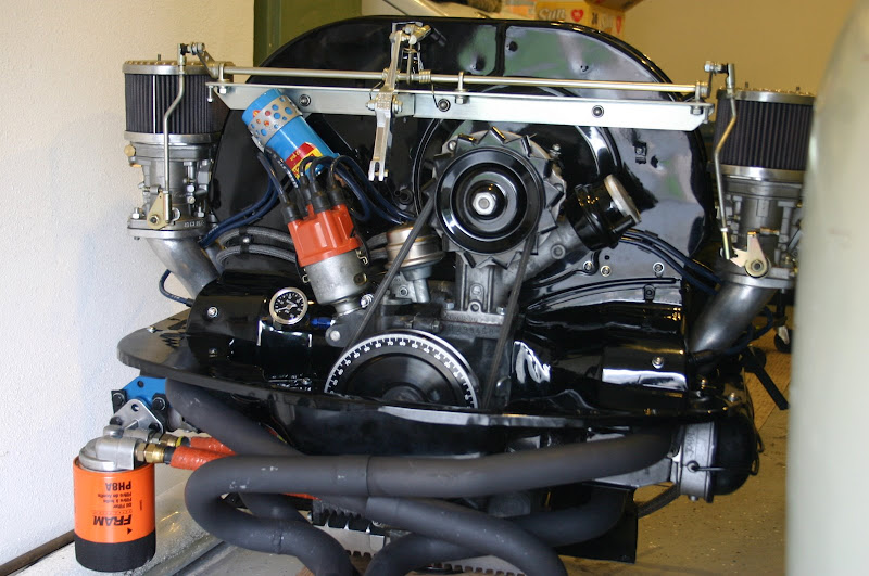

On my 66 with a similar bracket it does not clear the body. Brackets that drop it down around 2" had to be made. You can just see them in this picture. I plan on changing it and hanging it off the bumper bracket.
Here is a shot with how low it hangs-

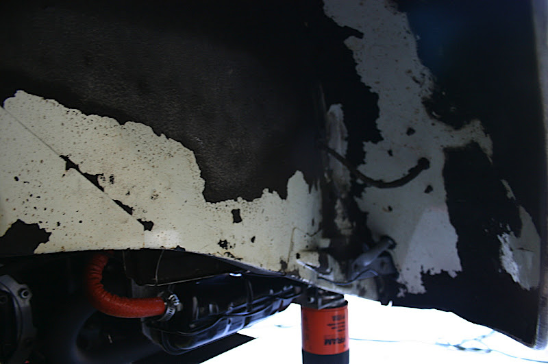

Bad picture, but you get the idea. The top of the filter mount is to wide and hits the inner fender on the engine side. Make sense? I have not looked at the bumper mount much, just looked like it might be better than what I have.

Hey Gary, Here are some pics of mine, albeit on a late model. If you look close at the second picture, you can see that the adapter is slightly clocked on the bracket. I enlarged the bracket-to-adapter holes so that the filter would have a little extra clearance to the 1 5/8 A-1 Sidewinder exhaust (ScottP has one on a 1 3/4 sidewinder). Because of that, you can see in the other photos that I needed to clearance the underbody just slightly. It also means that I have to drop it down off the studs to pull the motor. My lines don't touch the exhaust anywhere, one coming from the pump, the other going forward to the remote cooler. Because of the exhaust, I have to run the smaller K&N filter, but it is also rated to 500 lbs. pressure and has the handy bolt head on the bottom to make removal easy. The "Old School Purist"
may not approve of anything other than a HP1 hanging down far enough to intimidate american muscle from a distance, but I like that it's tucked away safe and still easily accessible for maintenance since this car is driven every single day, rain or shine.

Hi Dustin Damm that is Close to the header and the Body? My 1 3/4 is the one that goes under the push rod tubes so should not hit the exhaust with an HP 1
if I only need to notch the Body a Tad I might go that Way But I will be Running an Old School HP 1 LMAO Is the Filter your using smaller OD? or shorter? Or Both?

Here is a different perspective.... This is how it fits on my Type-3 motor with an 1 1/2" header. The header isn't as close as it appears...
