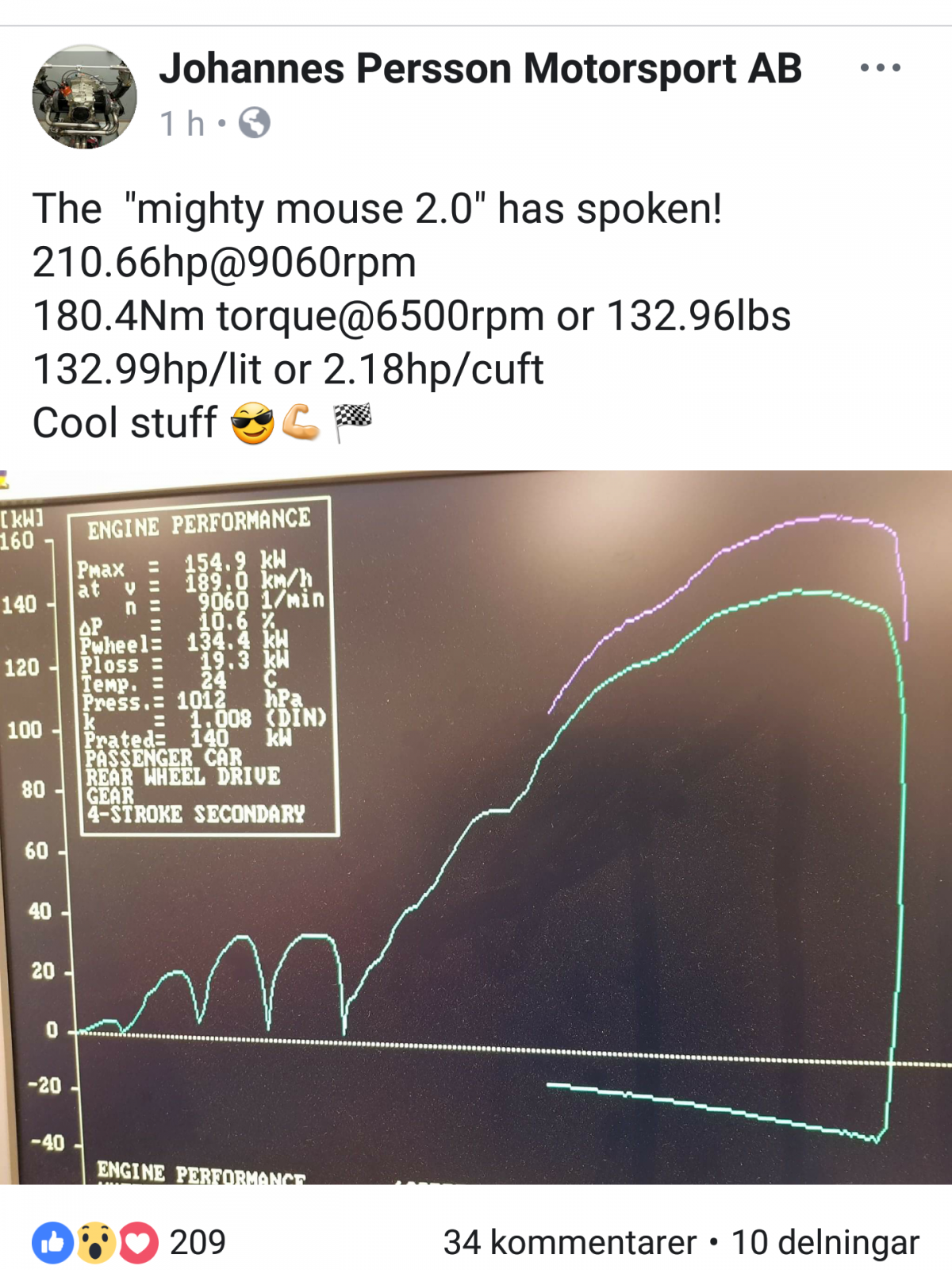

Anyone got more info on the new JPM 1600cc challange engine?
Not sure if it's ok for me to post it here, but his work is quite impressive!

WOW.
Somebody post some dyno videos quick!!

Is there a tuning reason for using 36mm venturi's in 48IDF's instead of using 44IDF's?
I'm thinking better signal, or maybe the 48's were available?
