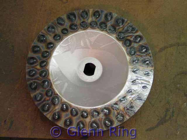

 Berg is about quality. However, my fan was done by Renato at Brothers (before he was at Brothers). I searched out a solid, straight German fan and had him do it. I'm sure the Berg fan was done in the same manner. If you were to see the welds on my fan, you would notice they are a good sized droplet. ALL the tabs are welded by doing one, turn the fan, do the opposing, turn over, do the second (every other), turn over, and so on. Then balanced. Now, I've never gone over 6500 with the belt on, but, no problems. Berg is good and I've heard nothing but good about Jason Eggums, but you might think about Brothers, too!

I haven't tried Bugpack's, so I can't really say anything about them. The Berg fan on top of AssHull's motor is top notch, though. There are a lot of fans being peddled out there that are only re-inforced half way like the one pictures above. Is that a Bugpack "welded" fan??
