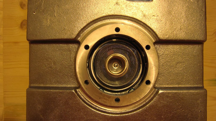

Scat 1 1/2 q for my 2276. My plan is to have it o-ringed on engine case flange and under sump plate too. It is sitting on Elring gaskets and no leaking. But I have Wolfsburtg West silicone seals for just in case..
Does anybody have a pic of o-ringed flanges?

Hi,
what did you use to extend the suction pipe? I only got the aluminium bolt on pipe which is very suspect to me and I don`t want to use it on the 2.2l.
Greetz!
« Reply #28 on: March 18, 2010, 23:03:06 pm »
I made my own extension. Throw the delivered extension as far as you can!

I agree on the extension comments.  I only used on bolt on in 1972 and never did it again.  I cut a piece of tubing and fit it for the sump and weld it on. The only way.  Pressure test it through the oil pick up hole in the case to ensure that it is pressure tight for the best suction.
