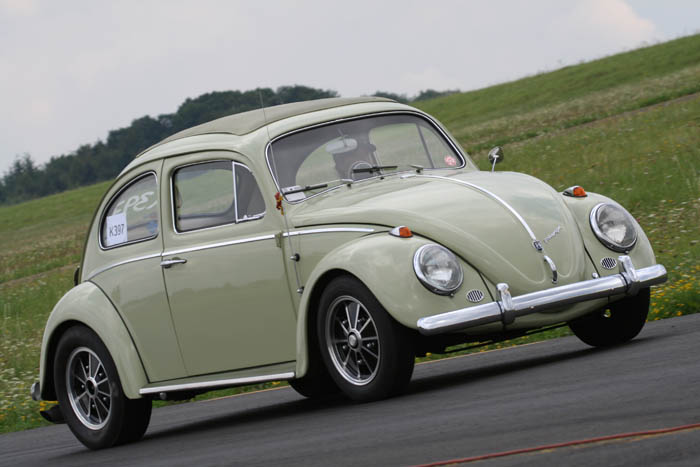

I'm pretty sure that's the fake 67 that was featured in UltraVW last month!
Only it had us-spec fenders... But the custom colour and fuchs are identical.
The story is that that "67" used to be a 1970 1200 that was converted, apart from the wide trim that the owner wanted.
Note the 70 door and doorhandle.

That's not Pat's car...

Indeed, that's not his car and has never been...
That's what he's drinving with:
