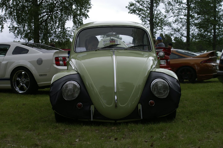

The summer the same year, not much rake as you guys like
I got more inspired of the Cal-look scene, so i painted it Beryl green, and gaved it a little cal-look touch. Here it is on a cruising night in Sweden early on the spring.
