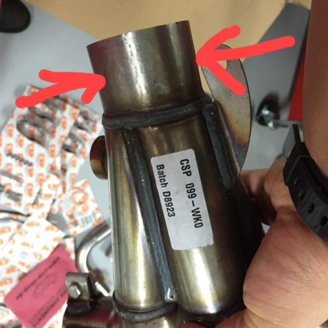

You can run a traction bar if you make one yourself to suit. They are not that nicely finished either. The j tubes are badly dented where they have been clamped in the bending machine too.
Re: CSP/JPM Wasp header and Muffler ( Images Wanted)
Reply #94 on:
December 27, 2016, 15:00:12 pm »
I just love the thought of someone cutting into a new silencer and welding a dented piece in to clear a caliper. Thought this exhaust was made to be as efficient as possible. So how is modifying something that's had loads of research and development, to make it fit a car!

Like this. Poor
vwhelmot
Posts: 687
Reply #96 on:
December 27, 2016, 15:09:17 pm »
Shouldn't have to spend time making it like it should be in the first place. Took tig welding to make it better.

So, after experimenting and measuring for a few more hours, I chose to add a 3.0 cm extension to the end of the collector and not modify any of the CSP parts. The deciding factors were: being able to use the Berg engine support and providing clearance to the caliper bleed nipple. I could always experiment on the dyno to see if there's any difference from adding the 3 cm extension, as it would be simple to do.
I went to my FLAPS and picked up a
2.5" ID-to-2.5"OD
(63.5 mm) connector and cut it down. The uncut version provided 6.0 cm extension, which was too much, so I worked from there and ended up at 3 cm:
I added a 3 cm tab to hold the extension for now, until I decide whether to clamp or weld it:
I can use the lower stock holes to use Berg support bar (there is room for the rod to move toward the valve cover a bit to prevent contact with the muffler). A fellow on thesamba from Hawaii showed how a shortened Berg bar will work with the Wasp, so I'll use his method:
The banjo fitting bolts the brake line into the caliper with adequate clearance. Will have to experiment with brake line position, as it's crowded with the Z-bar, e-brake cable, shock absorber with limiting strap, etc:
The bleed nipple clears the muffler by about 5 mm:

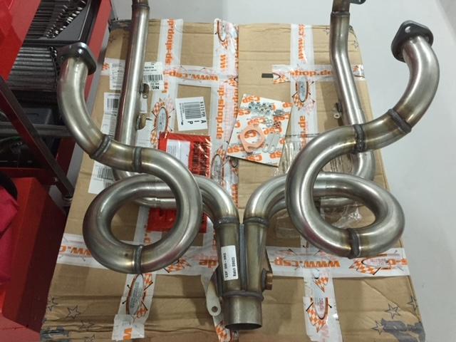

old thread , does anyone know what size is the OD of the collector for Wasp Stage 1?
Olaf A./DFL
Posts: 339
Reply #113 on:
February 18, 2021, 15:26:38 pm »
Quote from: pupjoint on February 17, 2021, 15:51:44 pm
Info from CSP: That'll be OD 59 mm.
