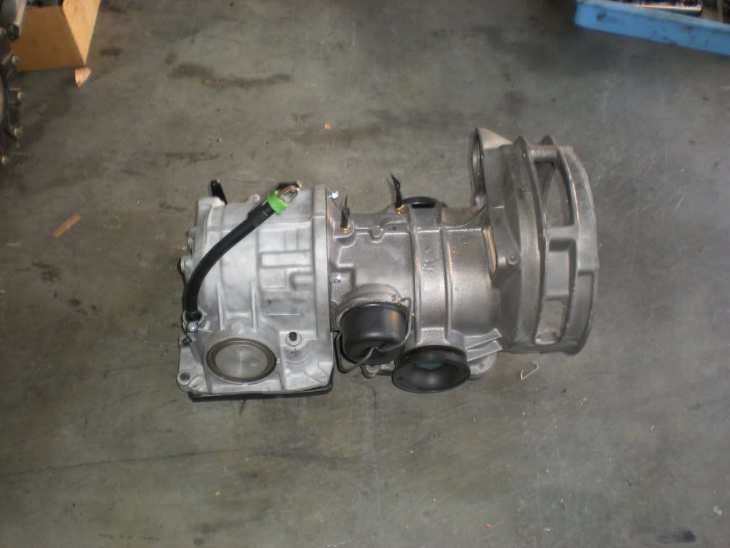

« Reply #39 on: July 27, 2016, 10:11:49 am »
I drove mine for many years.
In Italy as Daily driver for three years with a 2732 cc. Loved it!
Even a couple of laps around famous F1 Monza track.
Here on a Swedish drag race event and this time with the "911" turbo Engine.

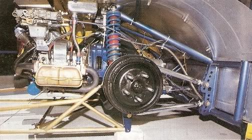

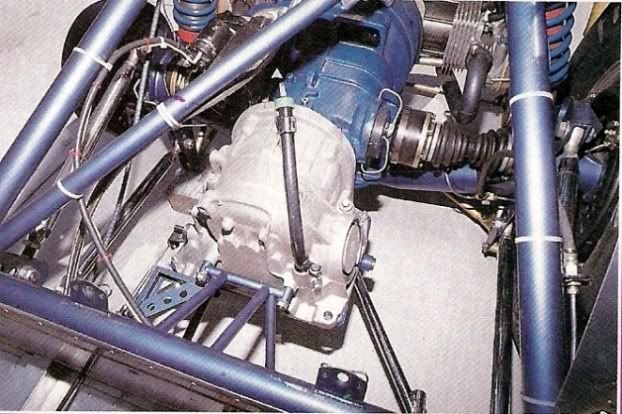

« Reply #50 on: August 13, 2016, 09:14:43 am »
https://www.youtube.com/watch?v=lAUHiOvx8Mo
Pure joy!
At 4:30 they do a test with the foot hard on the brakes.
Builds boost and runs through the gears.
They had to build a brake system with large drums from a  Ford truck. Then upgrade the drive shafts as they started popping.
'They started at 5000 rpm or more by just holding the brake.
I have more videos from the week after at the track. More links coming.

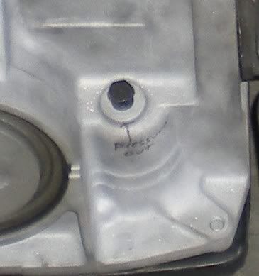

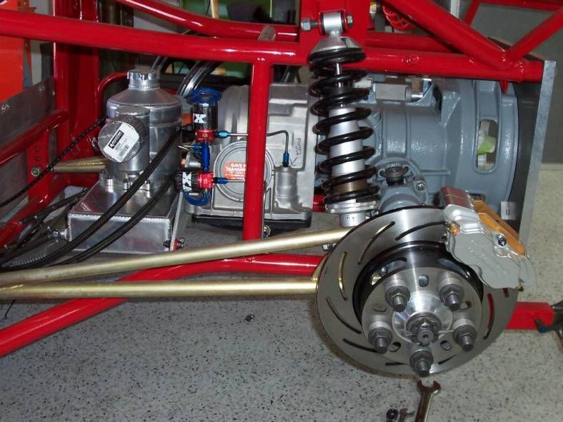

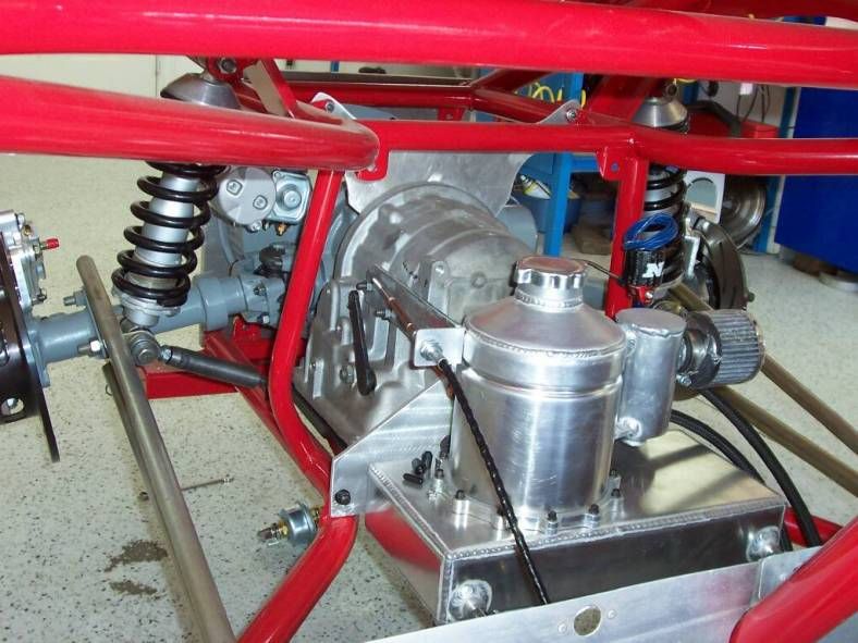

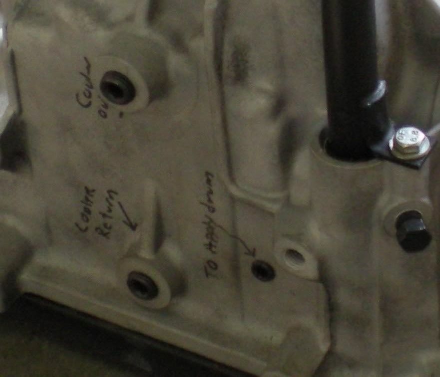

« Reply #52 on: August 13, 2016, 09:42:28 am »
The drum brakes on Pizzos
Pizzos setup
A Dave Folts transbrake setup.
I do not know if it worked.
My setup from Dave Folts
My spool
« Last Edit: August 13, 2016, 09:48:58 am by Frallan » Logged
« Reply #53 on: August 13, 2016, 09:52:45 am »
So a very simple circuit to apply line pressure to the reverse drum in order to lock it and then when releasing the pressure, it vents it down to the sump.
Now there is more to the story as you do not want the valve to remain open after launch...but I guess that is not so difficult to solve?

« Reply #56 on: August 13, 2016, 10:28:00 am »
Cool stuff fredrik thanx.
I wil try to get the band applied on the brake
And i have to find a sollution for the 2/3 shift as the back of the band apply piston is the acumulator for the direct
And i saw on the hydrolic schematic that pressure in 3rd is still on the aply side
And that by filling the rear the band release and direct wil apply
So have to make a new route for that
Gr henri
