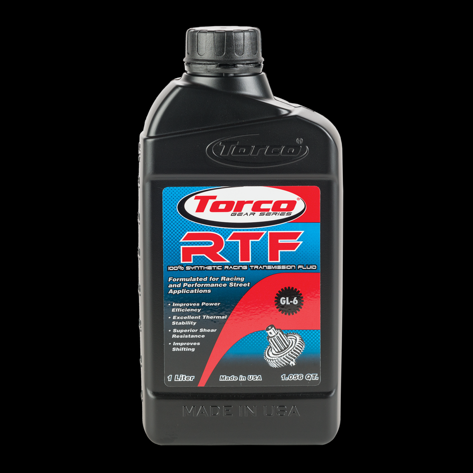

here you go thought I would toss this option out there - i have used allot of oil products in the past .but after trying this for the past 3 years , im SOLD no need to try anything else .
 no wear issues found during last 2 inspections /4th gear ratio changes .
launches are very hard and shifting is quite fast but very smooth .
gearbox is full synchro
https://torcoracefuel.net/products/torco-rtf-racing-transmission-fluid
https://cdn.shopify.com/s/files/1/0058/8110/2447/files/RTF.pdf
