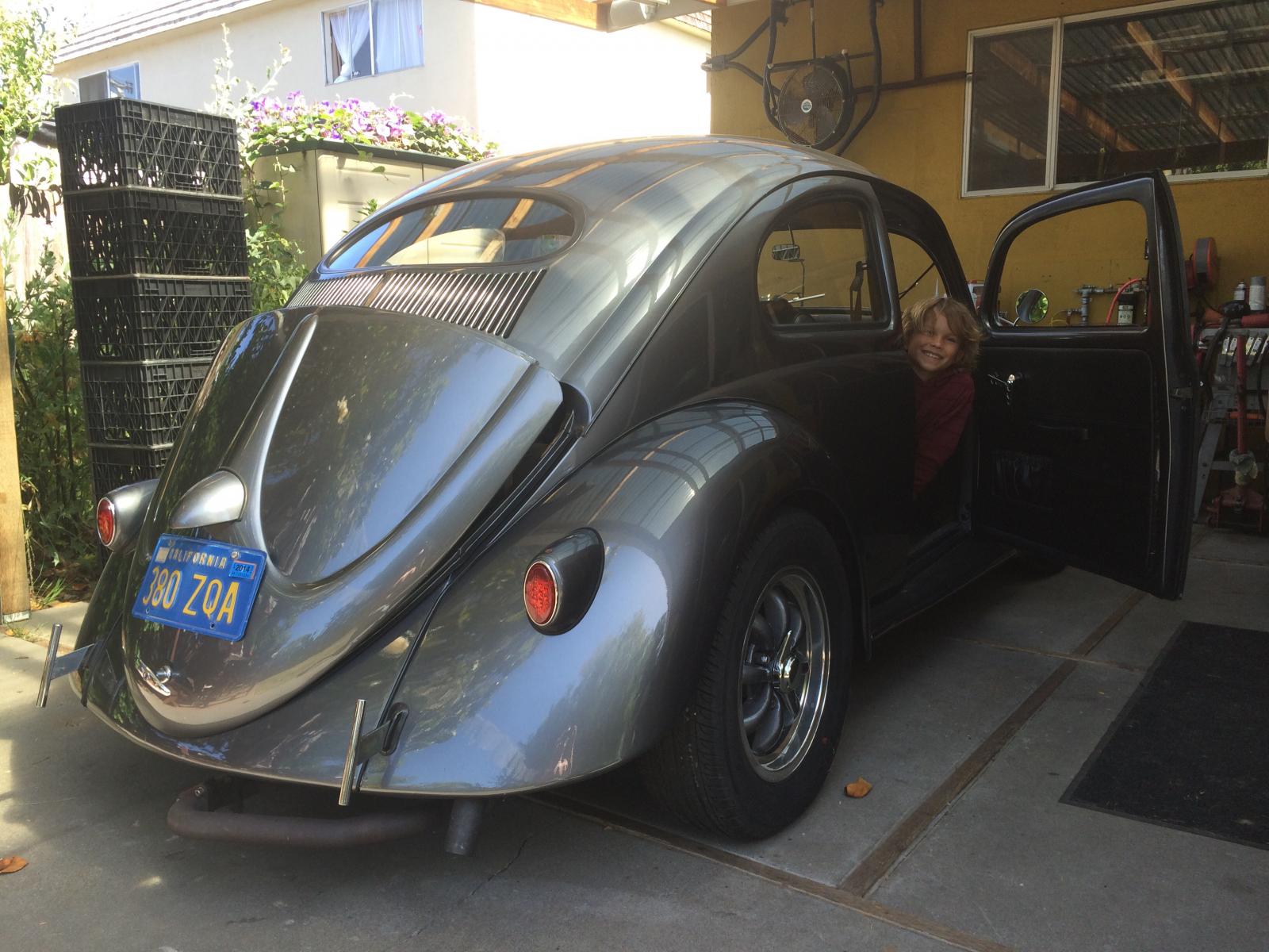

Y'know.. I'm really digging the theme here.
Dug my Oval out of hibernation, and breaking in the 1914 after a couple of 'mishaps'.
Had it since '96 or so.
If only all the traffic here wasn't constantly at a standstill...

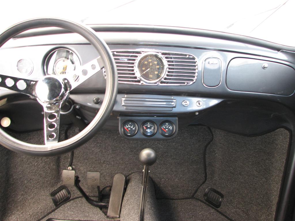

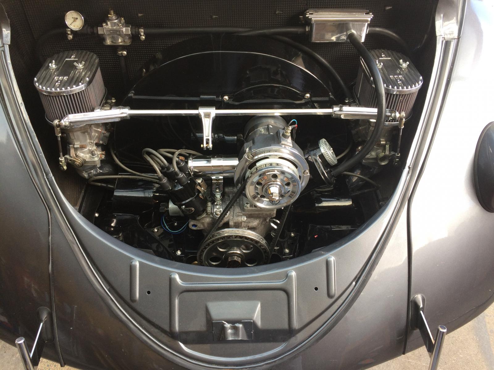

At first glance, you might think it's a pretty traditional late Cal-looker, right?
Compartment looks the part, too..
Interior:

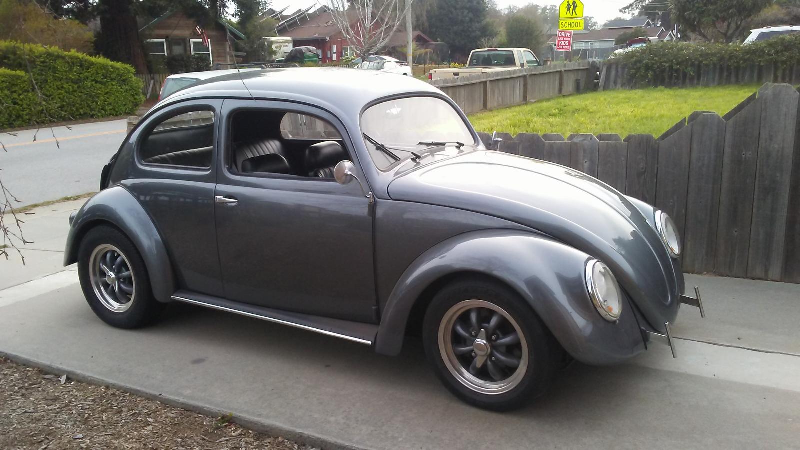

Fact of the matter is, I've gone nutty for handling with it as well; pretty much 'everything' to be done with a beam.
Those old 145s I had up front would plow into turns, not really steering much.
A narrowed beam gets you room for drop spindles and proper front rubber.
The single best mod was the further-offset ball-joints to get some more camber into the front.
A chopped beam also gets you stiffer torsions,
To match the stiffer rear torsions, and make a better balance.
Also notice the pan swap.. IRS and ball joints were such the hot ticket for an Oval back in the day!
It was like "Wow! pan swap!".
Now it's all this OG nonsense.. Never mind how weak stock Oval brakes are.
Scat seats provide some proper support.
The little dune-buggy steering wheel makes for some flingability.
Aftermarket fenders weigh less.
Fuel gauge, passenger mirror, three-point belts, etc...
Once you make the trip over to the dark side,
Not to ever care about what is original or not,
What the kids think is hip,
Then you can go with all of the great old stuff that actually works well.
Somehow, now that Bugpack is no more,
I'm even pretty stoked on my one-piece black vinyl headliner.
Who woulda thunk it??
One-piece windows and REAL decklid standoffs forever!!
PS, yes, the bogus 8-spoke Empis with fake knock-offs are there just to piss of today's 'experts'..!
