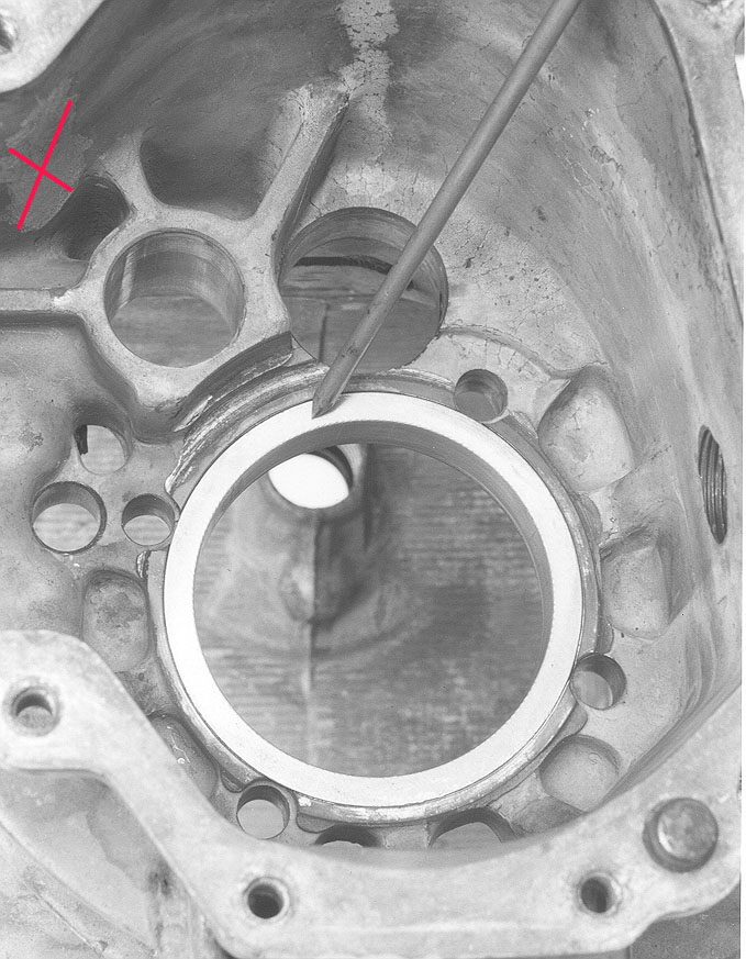

Is there a good thread out there?
Alunimium house I presume..
Big or small gussets?
Steel plates and bolts to hold the side plates?
Help wanted.. Snapped a gearbox in two..

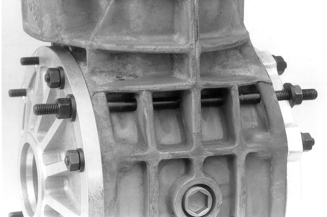

New main gearbox will now be:
White Rhino main house
Weddle/Mendeola gear carrier housing + nosecone
Paul Guard diff
full Weddle race gear stack
Hopefully a Weddle R&P
Full circle sideplates with through bolt
Gearbox girdle/cradle thingy..
