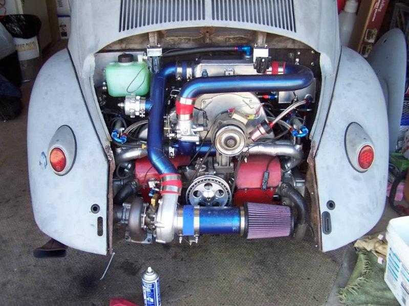

Hello, Joakim from Norway here.
I'm having a problem getting clearance between my pushrods and pushrod
tubes on my Competition Eliminator heads 48/40 valves. Knowing the moved
valve guides are not doing this any easier, I wonder if you have some
recommendations on Rockers/rocker assembly to run with these heads to
maybe eliminate the problem instead of machining the heads where the
pushrod tubes are seated? The pushrods are now gently rubbing, causing a
leak between the head and the pushrod tube (cyl 1 and 2 are the most
tight/most issue). I have tried to shim the rockers to get as most
clearance I can get without hitting the valve too far to the left of the
valve center, but still not enough clearance to avoid rubbing and oil
leaks. So do any of you have any tips, tricks or parts recommendations to easy
my problems and put me in to the right direction to eliminate my low
clearance, rubbing and leaks? Would love to not take the engine out of
the car again to machine the heads. Valve/rocker geometry is as good as
it gets.
List of engine specs:
CB Competition Eliminator 48/40.
1:1.4 rockers (Think they are CB but bought second hand, so could be
wrong).
CB Cromo pushrods (cut to length).
Valve-caps.
Fast Fab pushrod tubes.
Engle FK89 Camshaft.
94mm bore.
76mm CB crankshaft. (2110ccm)
5.5 h-beam rods.
8.7 compression ratio. (2.1mm deck height, 54CC)
Running hideaway turbo, watercooled Intercooler, EFI and pumpgas/E85. (Car has not been driven yet, freshly built and soon going for the dyno)
More you need to know?
Hope someone could help, I'm stuck trying to figure out what to do. Next
step Is to tear down the engine and machine the heads for clearance.
(Also contacted CB for some input/suggestions)
Thanks!
Joakim/Norway.

Re: CB Competition Eliminators 48/40, Pushrod/Pushrodtube clearance. Rocker's?
August 23, 2017, 14:01:07 pm »
Quote from: Erlend / bug66 on August 23, 2017, 13:45:05 pm
Picture time... Easier with something to look at
Try to figure out if someone is making offset rockers for one side?
Yes, offset rockers for one or both sides would be great. But also need input on what rockers people are running. I'm not the only one running these heads. Pretty sure someone else also have had to handle this problem?

Re: TURBO!CB Competition Eliminators 48/40, Pushrod/Pushrodtube clearance. Rocker's?
August 23, 2017, 16:50:27 pm »
Hi Joakim
I am using Scats on one car and CBs with the 67 nitrous car, fast fab tubes, and straight mantons on both, part of the problem I think you have is the short stroke, this equals a narrow engine so angle for pushrods is exaggerated.
Where does it leak? head end? do you use sealant on tube seals? if not a generous amount around the head end seal before install will help as the tube is at a bad angle as well and the seal doesn't sit straight in the head so slightest movement can cause a leak, the sealant helps add more sealing area on the edge that barely seals
cheers Richie

UPDATE.
I use straight type cromo CB pushrods. In the future i will take the heads of to machine them for more clearance (Move pushrodtube seating), but at this point I want to take it to the dyno first to see if it will hold up
I did as Richie said and put some extra sealant on the pushrod tube (intake cyl 1). All others are at this point dry. No leaks. When i inspected the valvtrain and the pushrodtubes, there was some rubbing on the tube intake cyl 1 and 2, but not that much on cyl 2.
I have now been able to run the engine warm after some tuning and drove it 500m on the road to check the clutch and gears. Nice sound in the engine, everything looks dry (small leak from oilpump cover, will tight it up). Good throttle response on ''bad tune''. With fresh fuel and new 10/60 oil inside, I'm ready for the dyno.
The time has come to see if I have manage to build a good engine. Can't wait.
