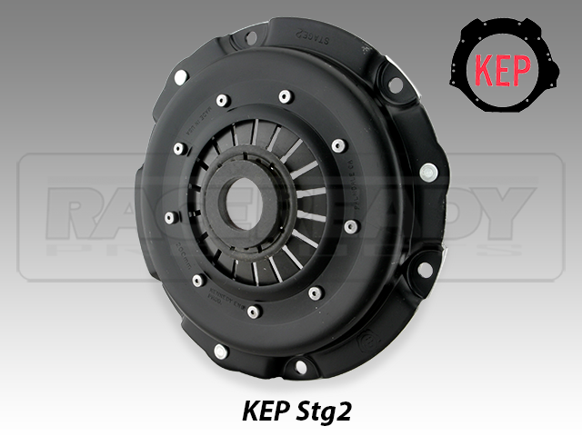

Hi Guys.
I'm experiencing clutch slip.
Pressure plate is a kennedy stage 2
Disc is a Daikin .
Motor is turbo
It doesnt slip till 3rd gear on a straight. And only when at full operating temp.
Is this heat related. like does the disc material FADE like brake shoes do.
Thanks.

At this page you can see how much torque different stage Kennedy pressure plates can handle, with stock disc.
http://www.racereadyproducts.com/transmission-components/clutch-pressure-plates/
Stage 1 = 180 ft.lbs = 244Nm
Stage 2 = 220 298Nm
3 = 260 352Nm
4 = 300 406Nm
Metallic disc can add 25% more torque. I don’t know about Black Magic.
If somebody tells you that a lot of people use stage1, it only means that they have less hp and torq...
At my race engine (N/A 2,85L type 1), I had 300Nm and Stage 1 + BM disc, the clutch start to slip.. Now I have Stage 3 for next summer. I hope it helps me.

Sanded the cover with some 600's wet and dry using a flat rubbing block. This has brought out the area of the cover that has the been slipping. Its from the outer edge going in a 1/3rd or the shoes surface.
Last Edit: April 09, 2018, 17:46:43 pm by GARRICK.CLARK
Air cooled Engine builder
Garrick Clark
Posts: 516
Re: Clutch slip
April 09, 2018, 18:12:44 pm »
I tried the break away torque today.
My torque bar only goes to 100 ft pound.
So the bar clicked at a 100 no slip.
I put a bar on the end of the torque wrench and couldn't get that disc to budge at all.
Guess its definitely a heated up disc issue.

Hi Guys. I've now fitted the CB dual disc. So far so good no slip. It does have a bit of judder when you 1st set off ,I'll have to get used to it I suppose.
Garrick Clark
Posts: 516
Re: Clutch slip
June 15, 2018, 20:15:45 pm »
Hi guys.
I'm looking for v dubbers to tell me about how your turbo bug drives on the street.
Mine with the stage 2 and the CB dual disc is getting difficult to drive. Yes the clutch doesn't slip which is Good,but the bug is getting more difficult to drive around town. I feel that this bug needs me to be more aggressive with the stand still starts from the lights, like more revs and let the clutch out quick in order to stop the clutch juddering. I think trying to be smooth with it will eventually brake something as it doesn't like it.
Looks like my bug isnt a street bug anymore.
