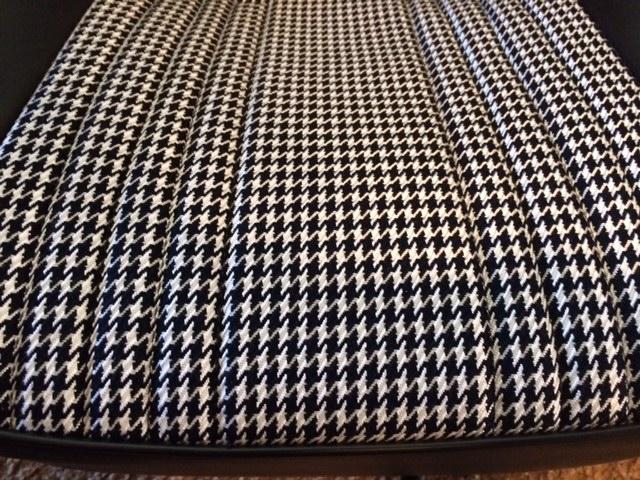

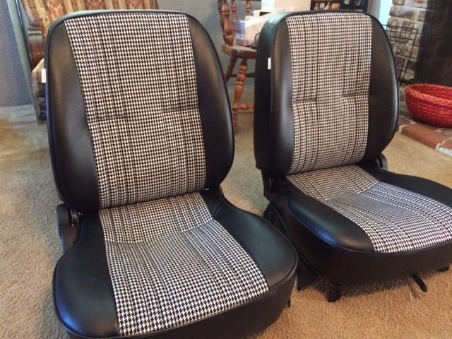

I went on a mission a few years ago make my '67 a little more civilized as well. The koni's made a huge difference as did a lot of dynamat. I haven't been able to locate a Koni steering damper yet but as soon as I do, I'll be purchasing one. I'm currently thinking about some kind of exhaust that will be a little quieter than the A1 maganaflow. I wouldn't mind a set of aftermarket seats as well but all the ones I like cost a fortune.

When collecting parts for my 63 build I wanted to get a set of 911 Recaro replicas with hounds tooth centers. But at $1100 a piece I just couldn`t do it. So I called Scat and they did a custom set of Pro 90 seats that I`m very happy with. And for much less.

Those seats look great.

Those seats look great Bryan! How do they compare weight wise to the stock seats and comfort level?
