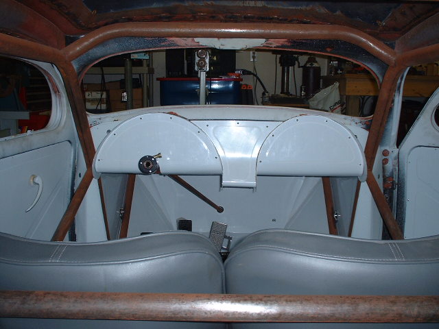

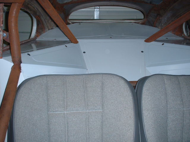

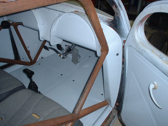

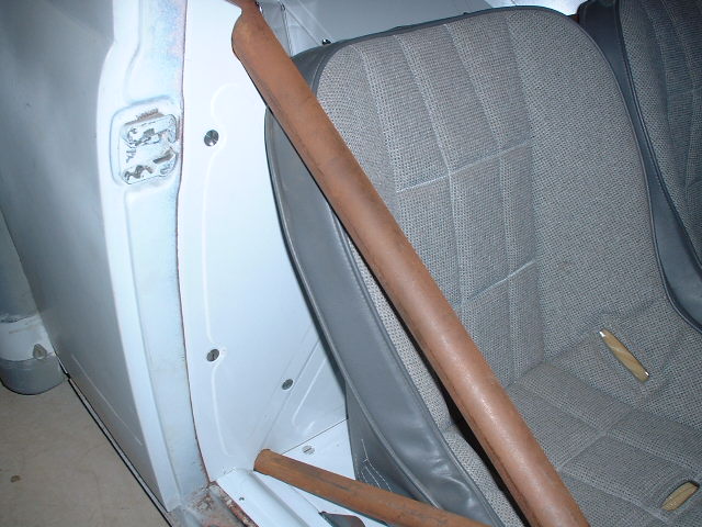

« Reply #1 on: January 22, 2008, 03:07:06 am »
You just got to get cozy with your passengers.  They'll fit.  More of the car below here: http://www.bigwigracecars.com/brewer.htm  Yes, it's a tube chassis car, so there is no shifter tunnel to get in the way, but even if you had to pinch the tunnel in to get the seats closer together in the middle, it's still workable.  No hand brake though.
Sweet that looks like a 50's bench seat lol. Shouldn't be a problem thinking about pinching the tunnel as you said Ric, as i will be running the MSE shifter setup with an 091 and the rods go above the tunnel, also I am toying with the idea of a hydralic handbrake so can essentially put this anywhere.
