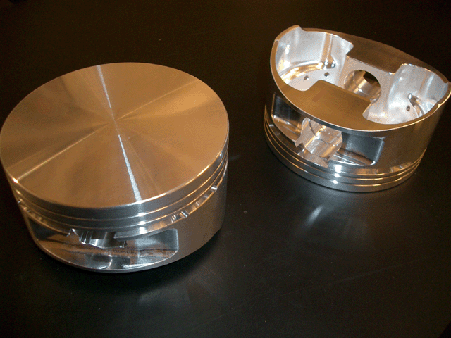

Re: Long Barrels or Mahle??
May 22, 2008, 08:59:09 am »
With these you can run 86 stroke / 5.7 rods and STILL use the stock length barrels...
http://www.jpmotorsport.se/
jr59
Posts: 126
May 22, 2008, 09:22:28 am »
Hi Jhu,
Are they JE special 94mm from JPM?
http://speedshop.skynetblogs.be/#
May 22, 2008, 09:53:41 am »
Yes, they are!
BTW nothing is as nice as a engine that fits in the engine bay!
