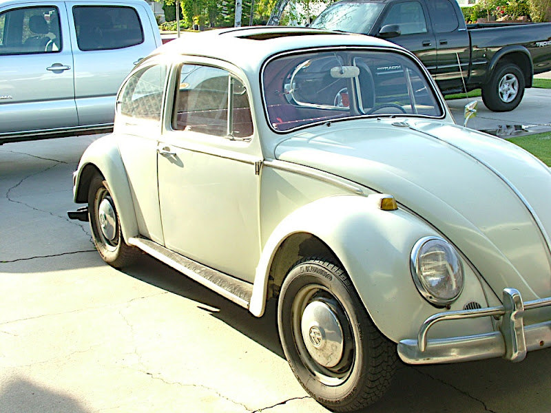

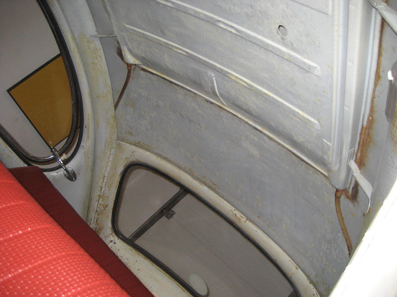

I sold my first real project car which was a 65 bug all because I wanted something I could drive and not be worried about. After the 65 was sold to a guy in Sacramento I searched for a original car. I looked for a while and all the cars were rusty, or just complete piles of shit.  I had no idea finding a clean car would be so hard. I posted a wanted add on cal-look.com and came across this 66 sunroof from a old DKP member.
It has had one very thin repaint, but has never been hit and was very solid. The car came out of LA and we met in Sacramento during the BOR.

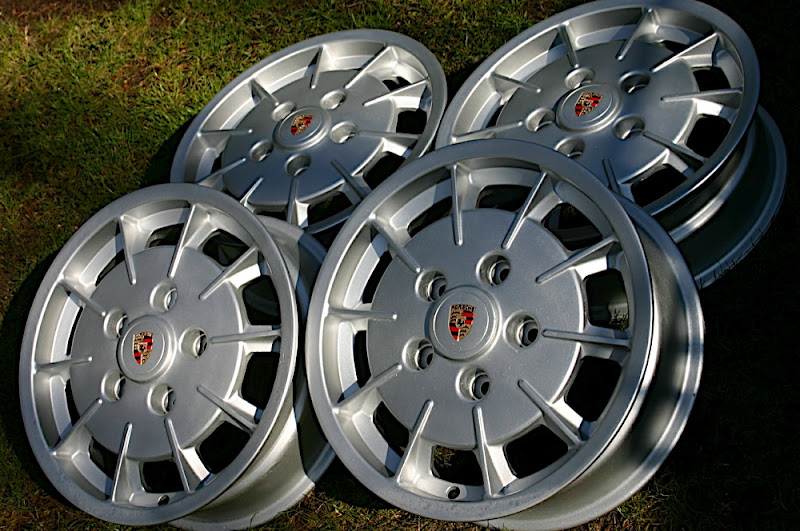

I always like Gas Burners so I posted a wanted add on Pelican Parts and I had made a deal on a set within a few hours. I touched up the paint and detailed the center caps and they were done.

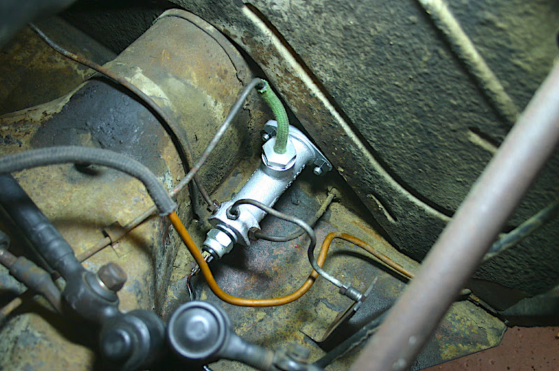

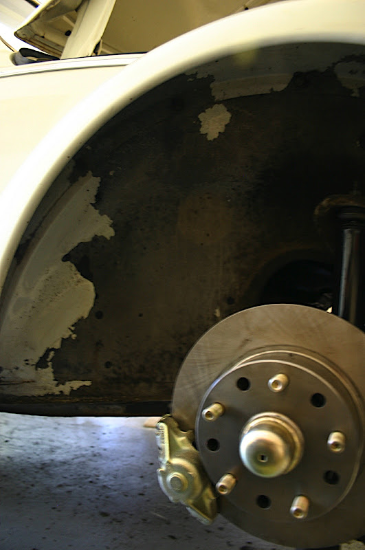

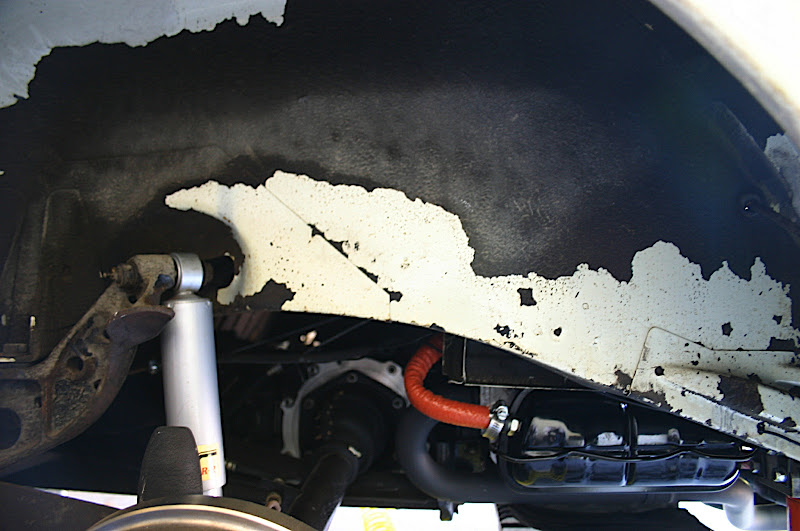

I got a set of Disc and re drilled drums and modified bus master cylinder from Russ at Oldspeed. The fender wells are super clean. I am going to strip the undercoating off and leave them painted.

It's driving now..still some tuning to do and things to finish, but it's almost there. All the paint has been buffed out, I had some stainless trim from my old car. A few more seals to go and then refurb the sunroof seals and cables and it will be water proof.  Grin

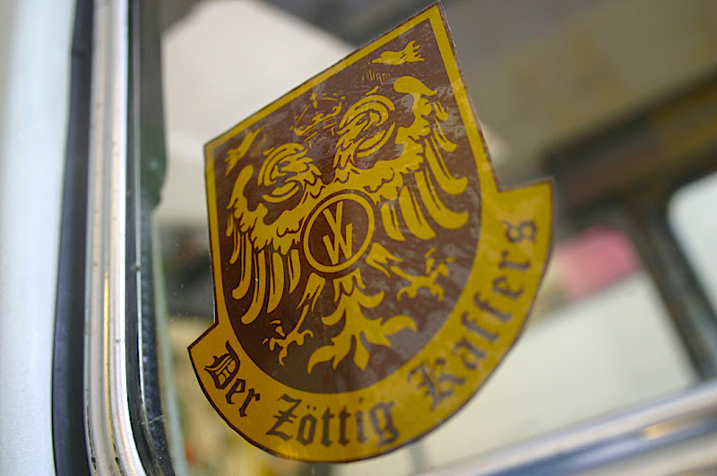

the car was into the dzk club(der zottig kafer) Huh who's is the dkp member who had the car Huh johnny salgado Huh
rgd
fabs
« Reply #8 on: June 25, 2008, 16:04:07 pm »
Not sure about the about the sticker I am guesssing it was just on the popouts when installed. It was Johnnys...good guess.  Cheesy
Grin Grin i said johnny because on his latest car (red one) he had some dzk stickers on  Grin and that's what i named him

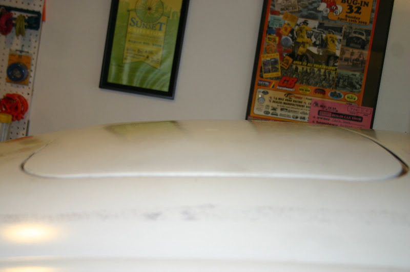

Rebuilt the sunroof, works like a champ now and looks 200% better, also got alot of the glue of the roof. I just need to get a felt seal for the front and back of the sunroof panel. Got some misc wiring figured out also, everything works except I still need to work on the wiper water sprayer some more.

chris could you tell me what paints you used on your centre caps and if you done them yourself.cheers barry
vw hot rod heaven
« Reply #23 on: October 07, 2008, 15:59:36 pm »
I just used model paint from the hobby store. Guards red, black and a gold then some Wurths clear over the caps. They turned out pretty good. Just get a few different brushes with super small tips.
