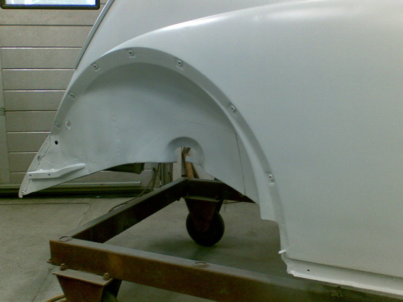

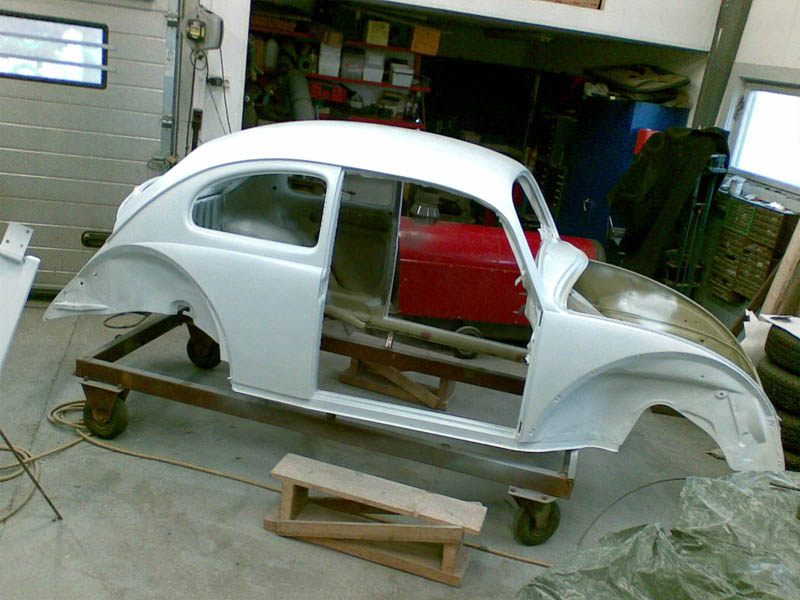

Last night I got my body up on the trailer, its going to paint prep now... not the best weather!?!

Good job, when is it due back?

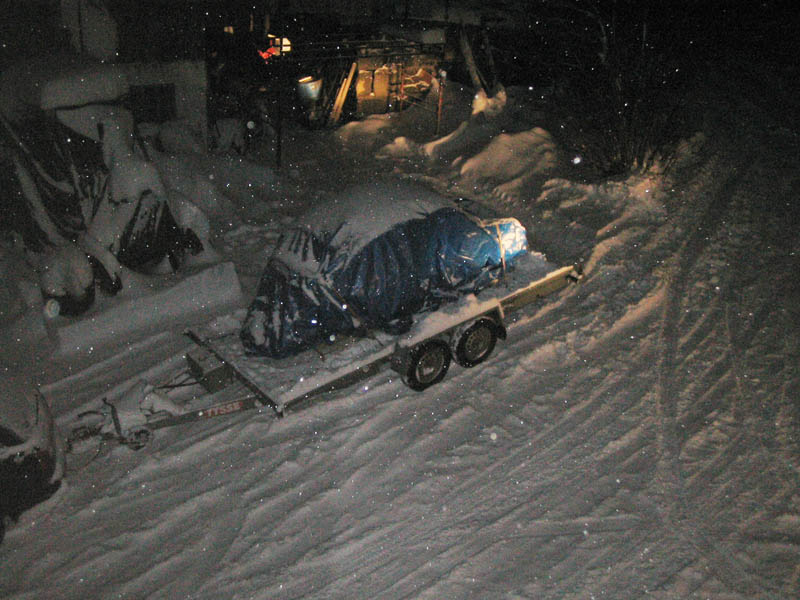

Restorations in Norway this time of the year is always fun:

It´s due back in two weeks time, and then it will sitt for a a few weeks before the final sanding and the black paint will go on it. Fingers crossed.

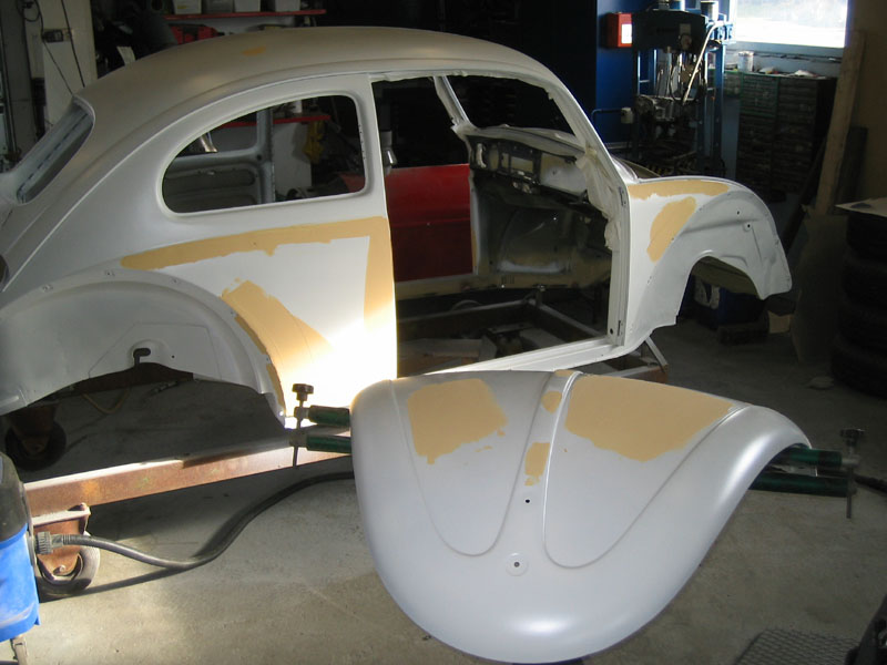

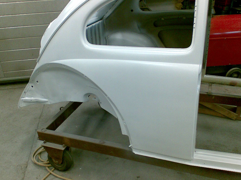

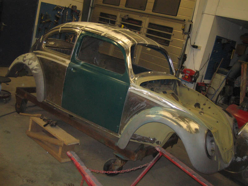

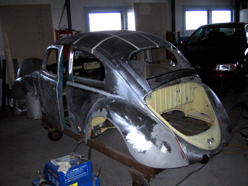

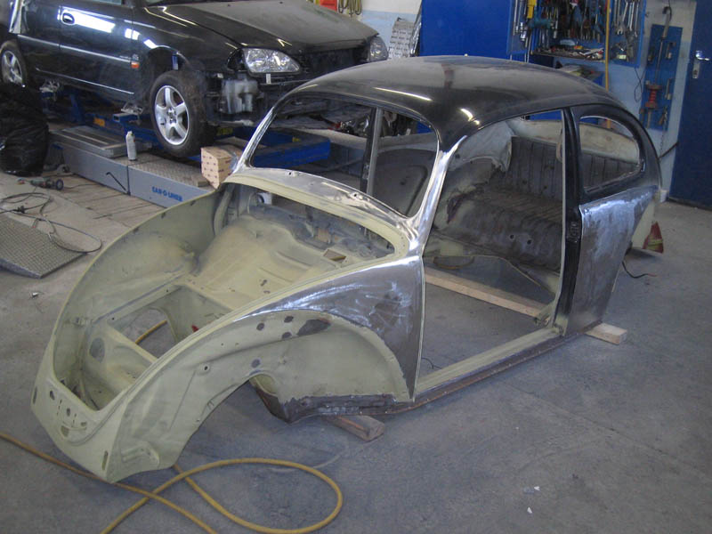

When I got to the body shop today, my body looked like this:
Looks like someone is working on my car, other than me... a very odd but good feeling
When I left the dust was dangling in the air, and the roof was in its "birthday suit"

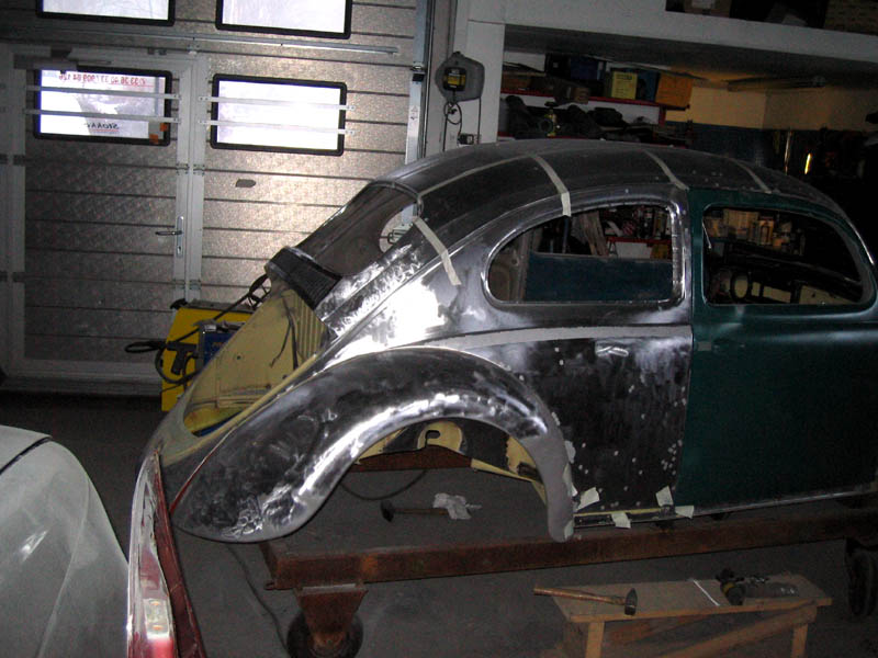

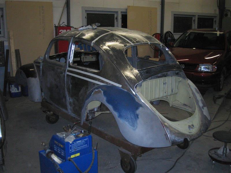

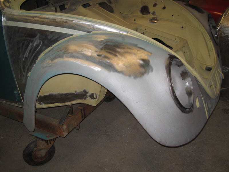

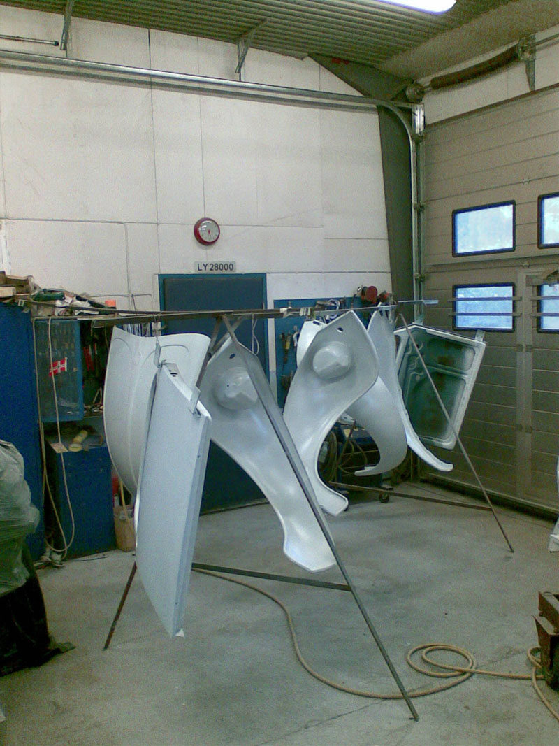

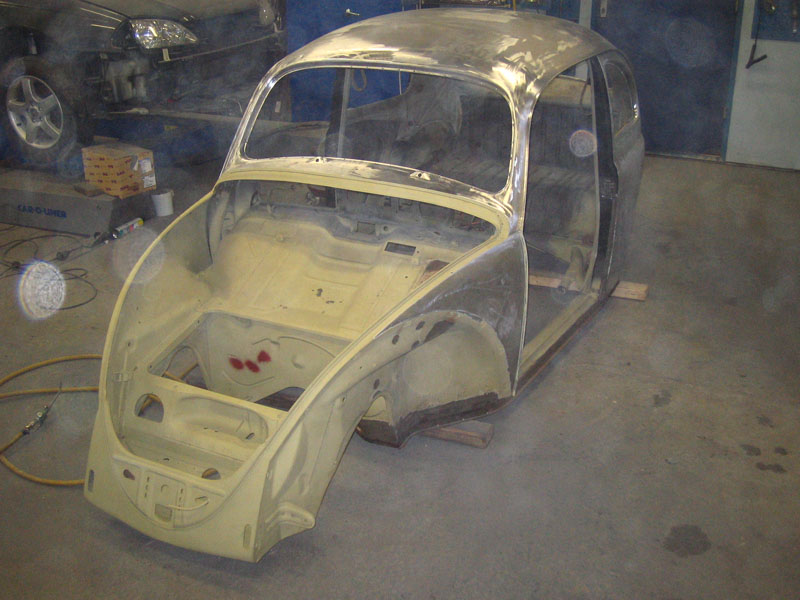

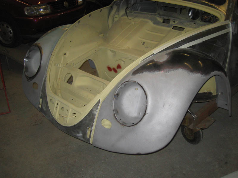

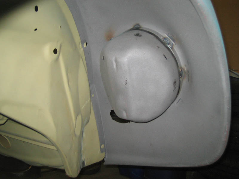

A few pics from the progress. Glue gone!

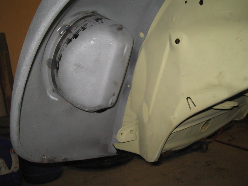

Last weeks big project was to get the main body part blasted, I did it myself using a friends industrial size equipment. If you take it easy you don't warp anything..
I did the inside of all the fenders and the bottom inside of the doors, and also the area around vent window. Even though the doors are NOS they have a tiny amount of surface rust from storage. I did the inside edge of the hood as well. Before blasting the original front fenders I drilled the spot welds and took out the headlight buckets.
I gave the buckets and the fender a good coat of welding primer and installed the buckets again... one less thing to worry about.
The car as it looks right now, some more stripping left for me.

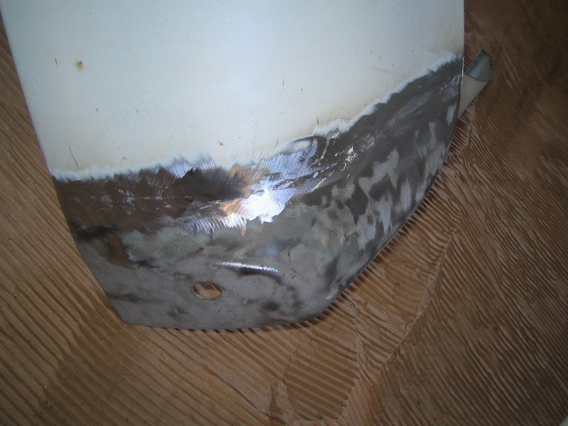

This fender was discarded in favour of a "pattern part" by a fellow Norwegian enthusiast, it was way better than anything I had so I gave it a new life.
To spot a repro is quite simple actually, for instance, check the nice S curve from headlight bucket to fender edge.
This is a VW original:
And this one is Danish repro part:
Last Edit: February 17, 2009, 15:28:05 pm by JHU

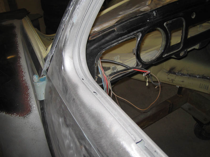

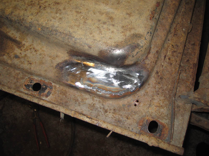

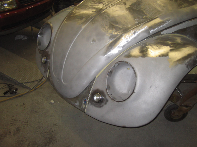

Been burning the candle in both ends this week, and I'm making progress on both my Bathroom, and more importanly, the CAR!
I pass this bodyshop on my way home from work, so I try to squeses in an hour on my way back. On monday I got the last paint of the fenders.

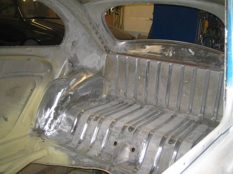

Then I sanded my bathroom ceiling, before going out in the barn and taking care of the only(?) rust in the floorpan.
On Tuesday I took care of some smal details that needed welding. Then I painted the ceiling and welded together the engine lid after sandlasting the edges.
Last night I spent the night there and got the horngrilles welded shut. Then I punched new holes with a 36mm hole holepunch.

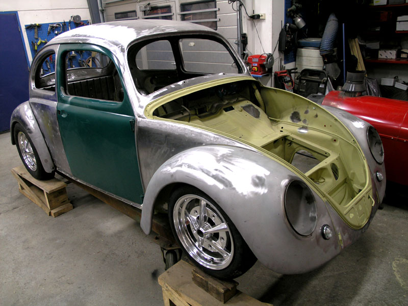

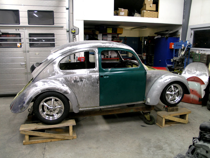

When I went over to work at the car this weekend, the body man had mocked up his wheels to my car... even if these wheels are to bling-bling for me... it looks kind of cool. I had almost forgot that this was a car by this time.

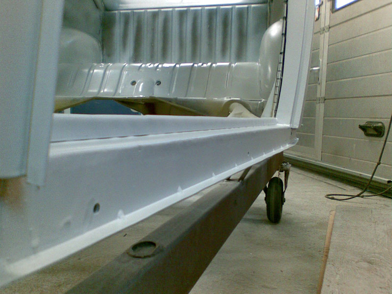

Now its covered up in some nice EPOXY.

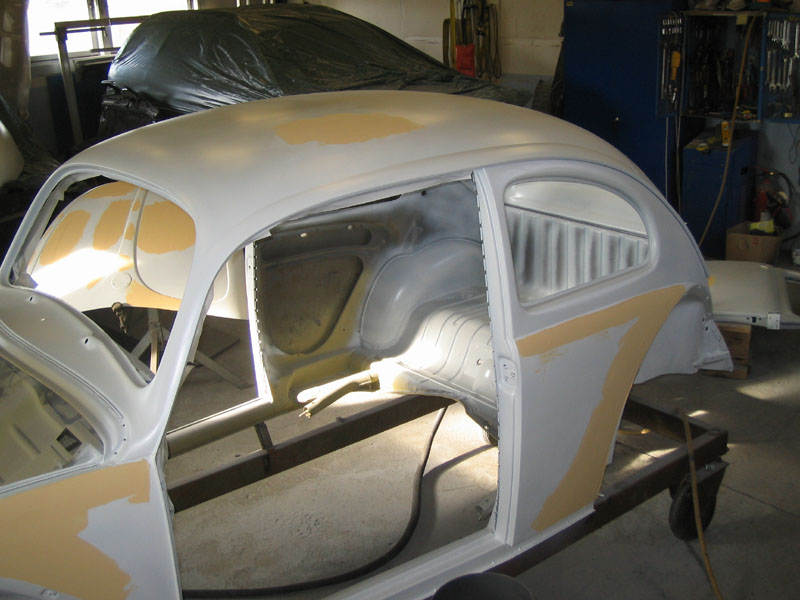

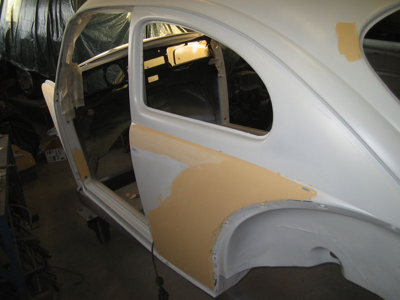

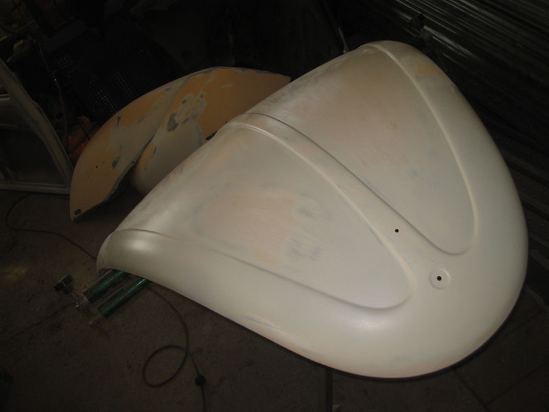

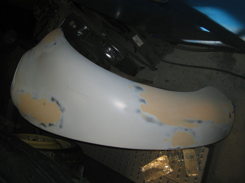

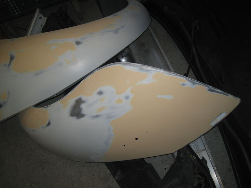

It's fillertime!!
Last Edit: February 17, 2009, 15:31:44 pm by JHU
Re: JHU's timebandit
Reply #86 on:

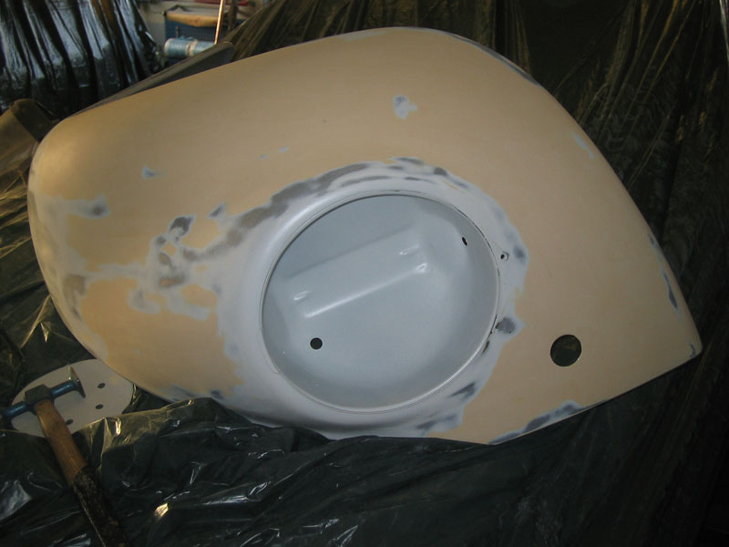

March 20, 2007, 11:26:14 am »

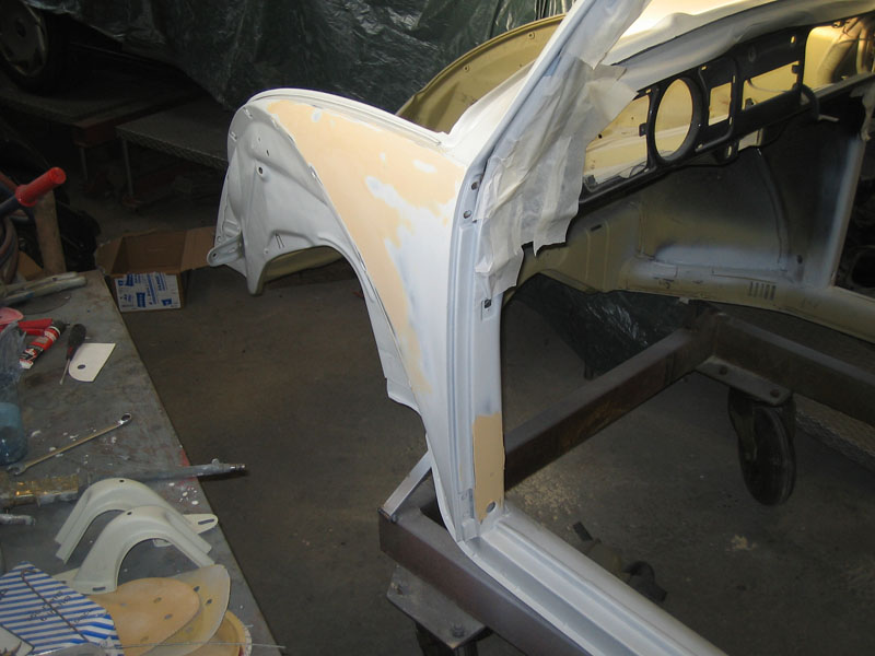

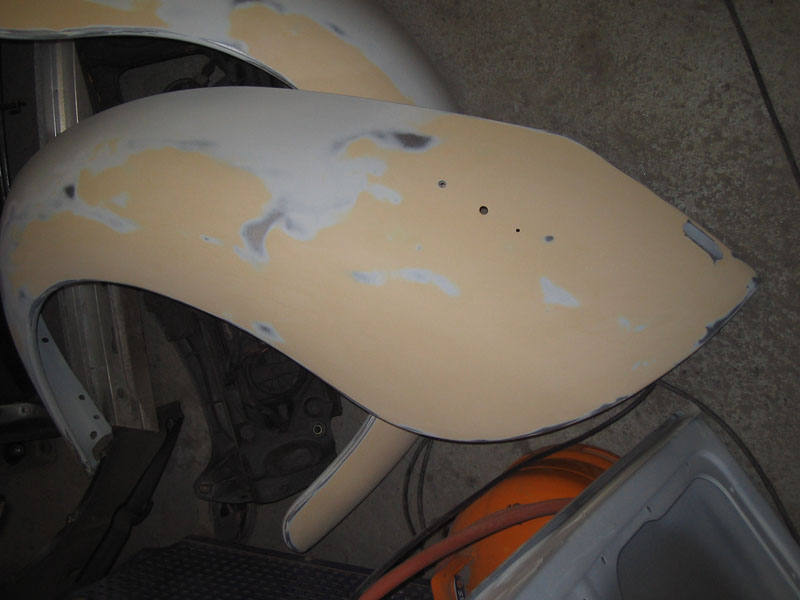

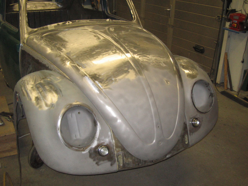

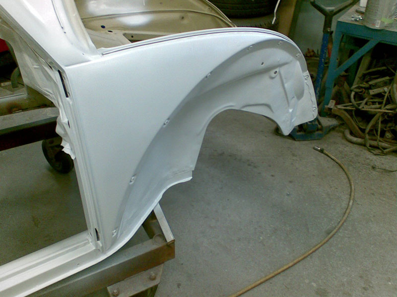

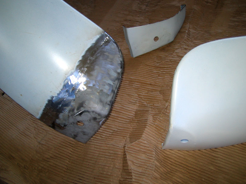

And last night I gave in to my obsessive side and cut up my newly primered fender.
The right fender is a original factory installed fender, but it wasn't perfectly identical to the original fender for this car.
Unfortunately the original fender was to far gone due to a serious dent, otherwise I would have used it.
The first discrepancy I corrected was the headlight bucket, with had slightly longer beads in the bottom on my original. So I swapped this over earlier. Then it got primered.
But the transition to the runningbords wasn't right I felt... it was"there" but didn't feel "crisp" enough. So I welded in the bottom from my original fender. After a sandblasting this evening I hope my body man can forgive me.
Last Edit: February 17, 2009, 15:32:42 pm by JHU

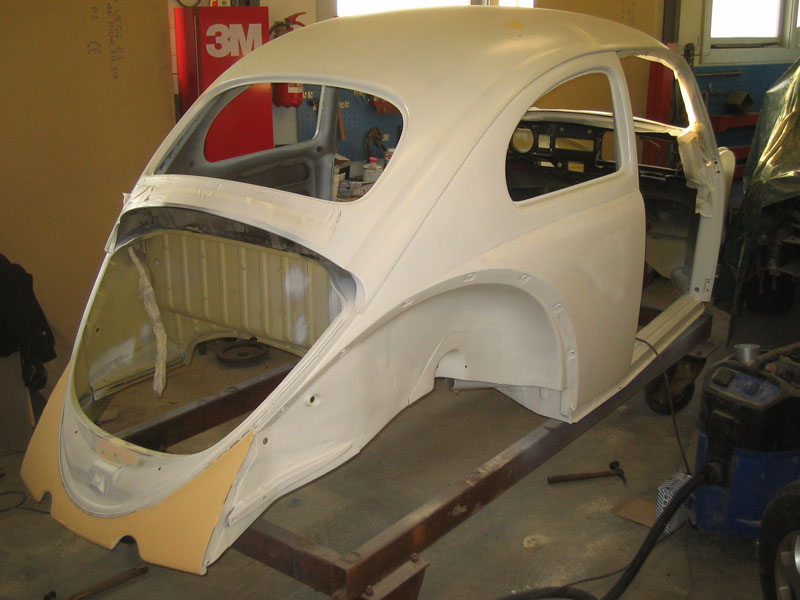

March 28, 2007, 15:50:14 pm »

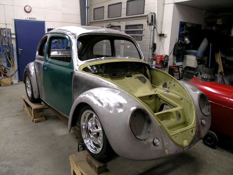

This is what it looks like now... feels smooth to my untrained hands...
Last Edit: February 17, 2009, 15:33:09 pm by JHU
