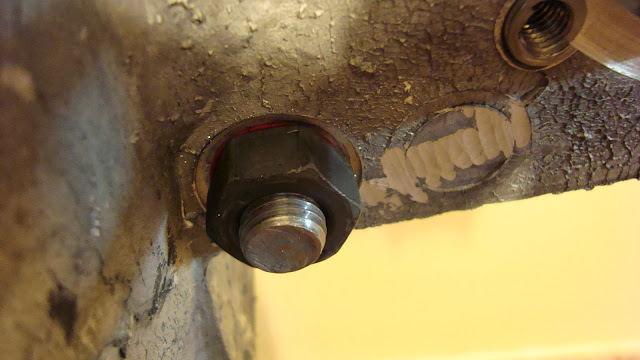

what do you mean by case washer at main saddles? inside the case, or those 6 washer around the barrels? didn't you reverse those 6 nuts:

« Reply #3 on: May 20, 2009, 21:44:42 pm »
I think you have the main 6 case nuts backwards..they are not self locking but self sealing and that means they are supposed to be installed with the plastic ring crushed against the case, without the washer.

originally those red seal nuts were designed to have the red seal material go against case, without a washer. However by doing that you cannot get consistent torque on probably the most important fasteners in the engine (aside from rod bolts and gland nut  Grin). Berg made mention of it on his catalogs too or in his Blue Books. Use a thick 12mm heavy hardened washer and I would run the nuts "upside down" with red seal facing outwards, and use a good coat of K2 on underside of washer. I also smear a dab of assemb lube on 12mm threads and on underside of nut to prevent any galling when doing the final torque.
