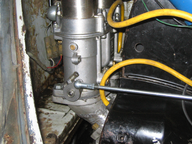

any pictures of your manifolds you made?

"any pictures of your manifolds you made?"
Not JHU manifolds and these are longer - but then again the carbs are shorter compared to IDA`s. The carb on the picture are mounted on a 1915ccm NA street engine dynoed 244hp.

Shubee and all, sorry for this dirty picture. This engine is just a test of my engine settup, the cooling is just stuff I had laying around.
And it will run with the magneto in the future, but its still in the states for its tuneup.
Now back to the manifolds, here is a not to good closeup of them:
The IDAs are tall carbs, so they need to come down a bit to keep the runner lenght sensible, but I like the look to!
Again sorry for the dirty pictures
The 244hp IS mighty impressive, but please note that it is NOT a street car if it doesn´t have cooling - seriously you need a fanshroud on that engine before it enters the "street" class. but ok let´s say it still has 230hp with the fanshroud mounted - still IMPRESSIVE!
Johannes usually has full cooling on this engine does'nt he?
It would be quite interesting to know how much it makes with generator/fanduct/powerpulley... and then compare this with the figures without cooling.
Cool manifolds by the way - I love when someone has put som thoughts into their project and not just built a "mail order engine". actually it could be fun to run your engine on the dyno with these manifolds and then again with "std." manifolds - will this happen ?

I will not change manifolds I think. But I will make some adjustable stacks to fine tune the engine on a dyno. The result will be the same.
In theory I can have different stacks for different uses, like drag, street and as here, hill climb.
