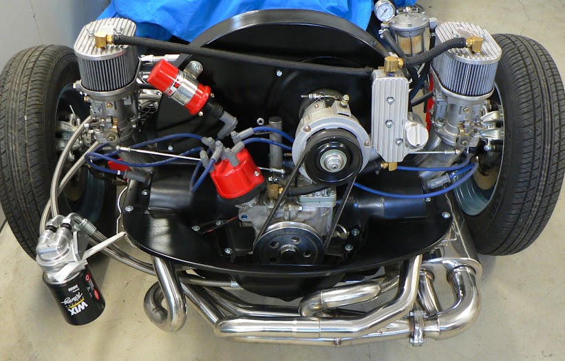

Sepi
Posts: 102
Re: -59 sleeper project
May 04, 2012, 06:08:56 am »
I have to update the ready engine combo...
- polished Bugpack 84mm crank +8 dowel lightened flywheel and Chromoly bolt
- Kennedy stage II + 200mm, Kush-Lok
- 5,5 Bugpack H-profile rods, new ARP bolts. Porsche journals
- VW block machined and reinforced, ff,
- 94mm AA cylinder/pistons
- Schadek 30mm oil pump
- Porsche 911 oil squirters
- KS crank bearings
- Raptor PM00806 (263deg at 0.05” , 9.64mm cam lift and 106LC)
- JPM 7075 billet dual taper pushrods
- Scat steel straight cut cam gears
- JayCee no leak tubes
- 1,4 SCAT Pro-Comp 4340 Chromoly rockers
- DRD CNC L7 heads 42x37.5
- MSD Billet T-1, MSD 6AL, MSD Blaster 2
- Dellorto 45 DRLA's with 36 mm venturies
- S-S Sidewinder
- CR 11.05
- wide oil sump, filters, coolers etc.

After so many long days waiting the paintshop finishing their previous works, my beetle is now under professional care. Basically sand blasting didn't give any big cases and now the body is getting nice original fjord blue colour. Few places are ready and it is so nice to see those gloss results. If everything goes well, I'll get the body + all shiny pieces of beetle before Christmas. You'll get me then from my garage :-)

look nice.
Is the R-P steering from a vw polo 86c or a 6N?
