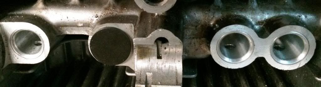

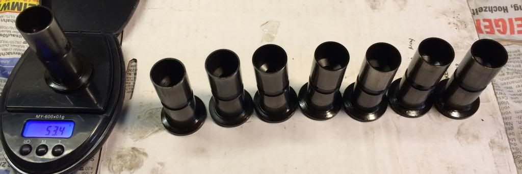

So now this engine is progressing too.
New Thorsten Pieper inserts and T1 tool lifters are added as Johhanes recommended strongly T1 lifters.
The composite one goes in to the turbo engine with mild cam.

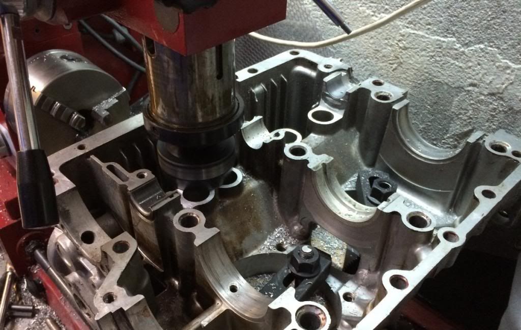

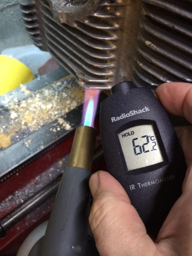

« Reply #21 on: February 15, 2014, 21:59:39 pm »
Thanks Thorsten Pieper!
Minimal machine work, heat it to 80+C and then insert the bushings.
Now ready for assembly.
Nope, that blow torch did not do it. BUT the large gas BBQ did.
Promise not to tell my wife. She will kill me.
