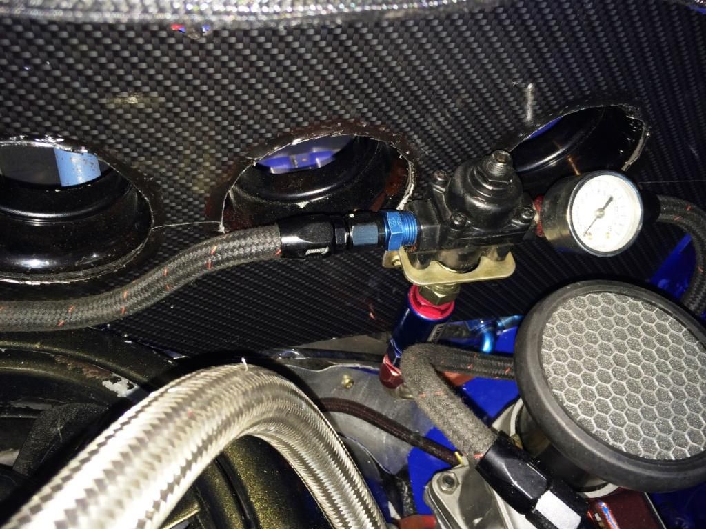

Slowly slowly progress.
Double Blue top Facet pumps.

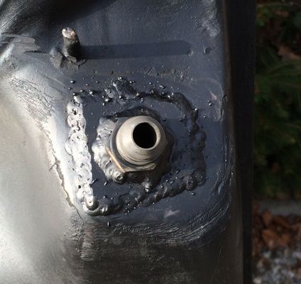

Oberg large prefilter
AND a real AN8 connection in the tank.
Not a fake adaptor with a tiny hole in the bottom.
Then I drilled out 11 mm and welded on a large hole connector.

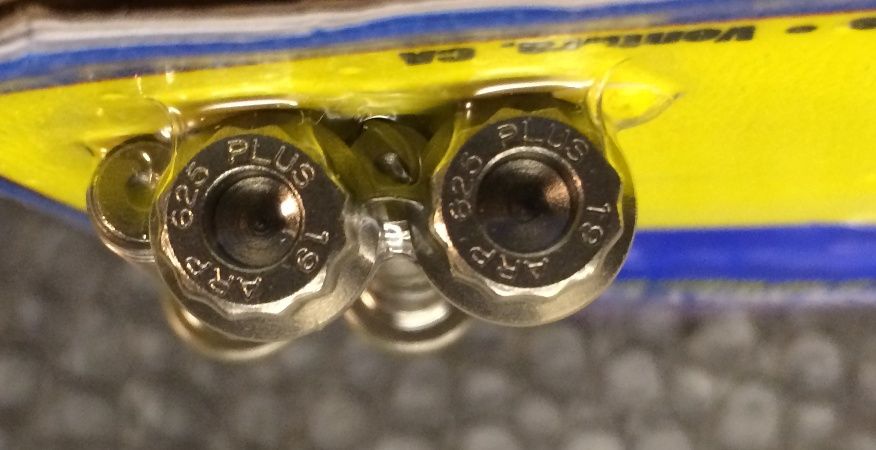

The ARP bolts are once again upgraded from ARP 2000 to ARP 3,5 and now the best Carillo replacement to ARP 625Plus.
Best option if you (I) insist on running cheap H profile rods.
Carillo or Pauter would have been better.

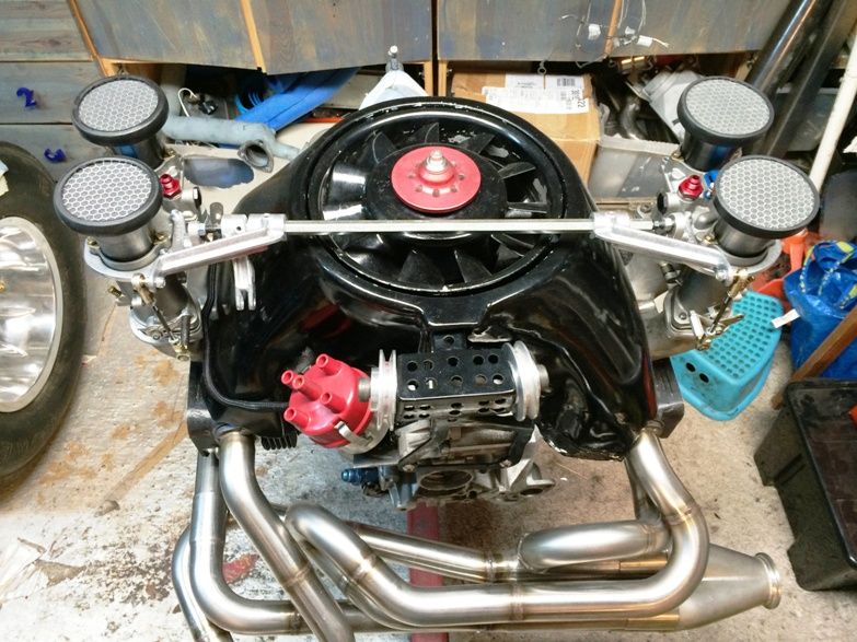

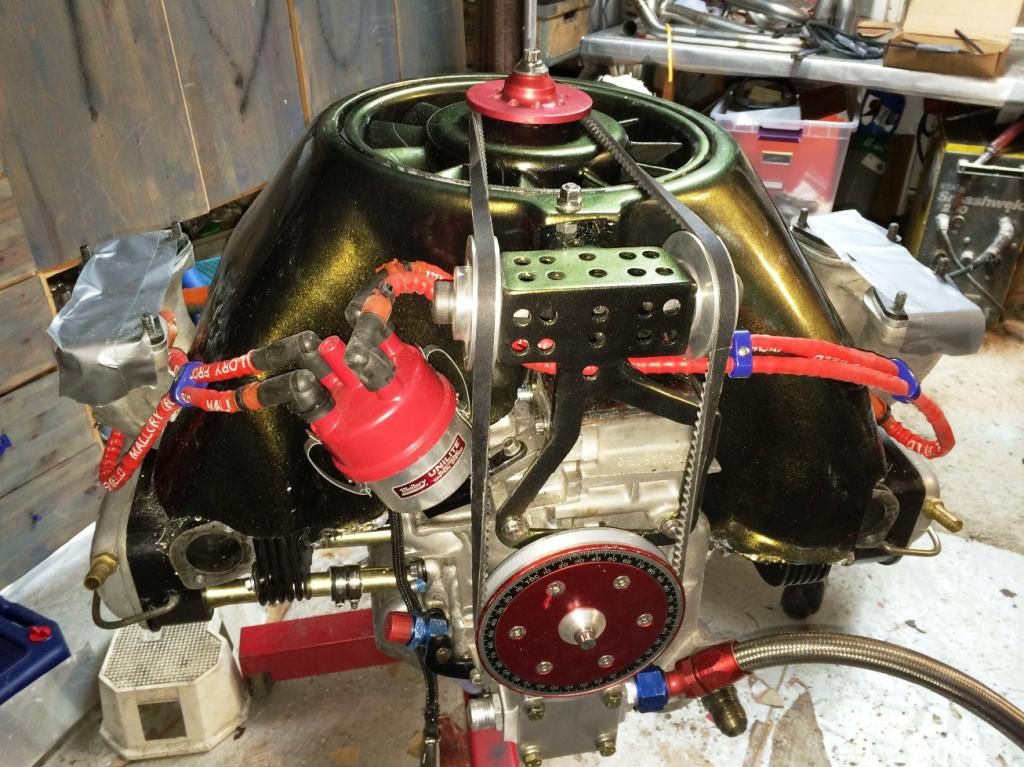

Engine is taking shape.
All small details are taking a lot of time but I enjoy it.
The CF fan housing had to be swapped for my regular one, as I needed to modify it a lot to fit the Engine Plus heads.
Next week it is time for final assembly.

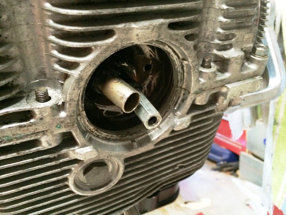

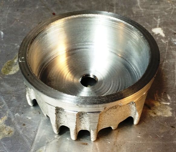

Did a mini sump out of a CB T1.

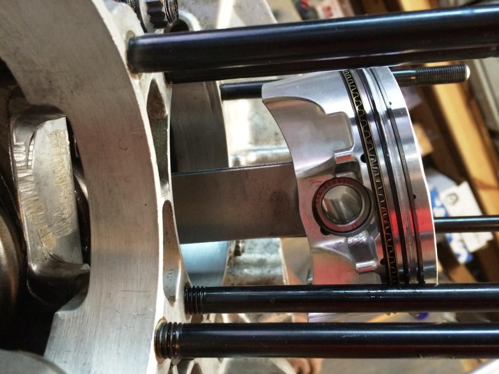

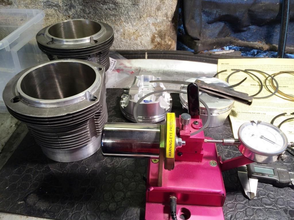

Love my ring gap grinder.
Square nice grinding and pretty easy to handle.
Do NOT love ring locks. Best for duarbility but these were 10X more difficult than the spirolocks.
Mahle has nice and easy one but JE made it very tough.
Plus 1. 0 and 1.2 mm rings are pretty difficult to hande with the ring compressor.
I have to build myself a new ring compressor tool. later......

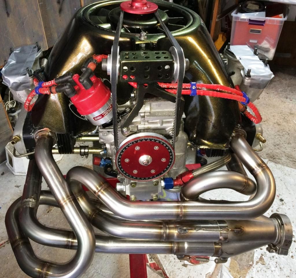

« Reply #35 on: August 06, 2014, 19:50:45 pm »
A bit of progress last couple of days.

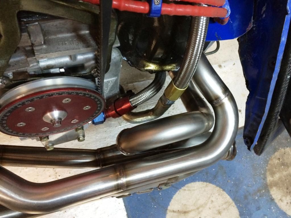

« Reply #36 on: August 07, 2014, 17:57:22 pm »

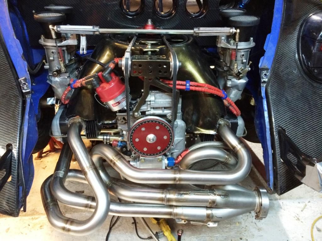

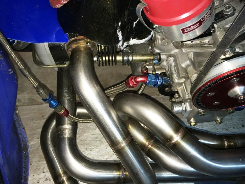

...and exhaust in place.
modnrod
Posts: 795
Old School Volksies
« Reply #37 on: August 07, 2014, 20:27:35 pm »
Mmmmm! Shiny!  Cool
« Reply #38 on: August 09, 2014, 16:00:50 pm »
Finally mated and home with Mummy.
Plenty to go but it is still a nice milestone.

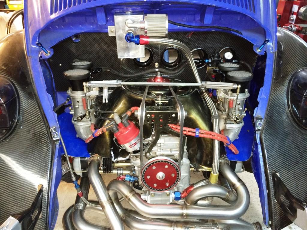

« Reply #39 on: August 13, 2014, 20:19:58 pm »
Details Details
It really takes time but that is no surprise.
Anyway, rear cover plate, few more oil lines and electricla connections, then I will fire it up prior to doing interior with insulation and rugs....plus more.

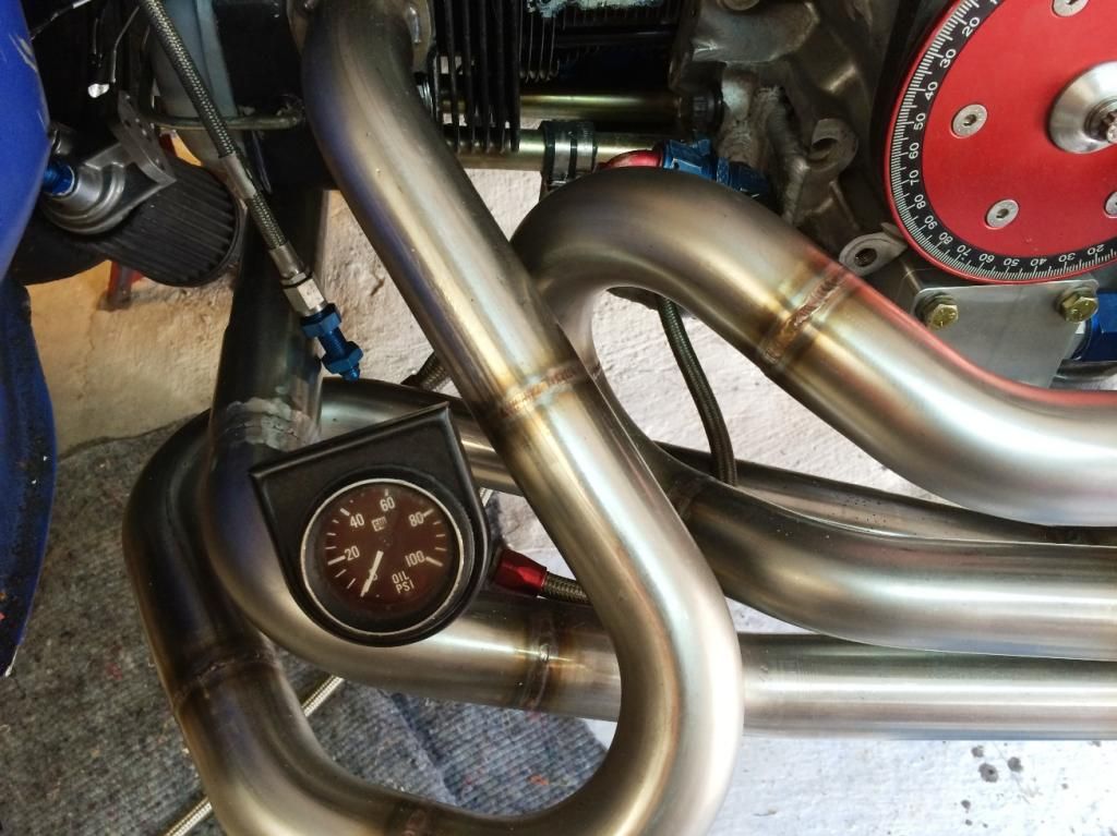

« Reply #41 on: August 16, 2014, 13:22:09 pm »

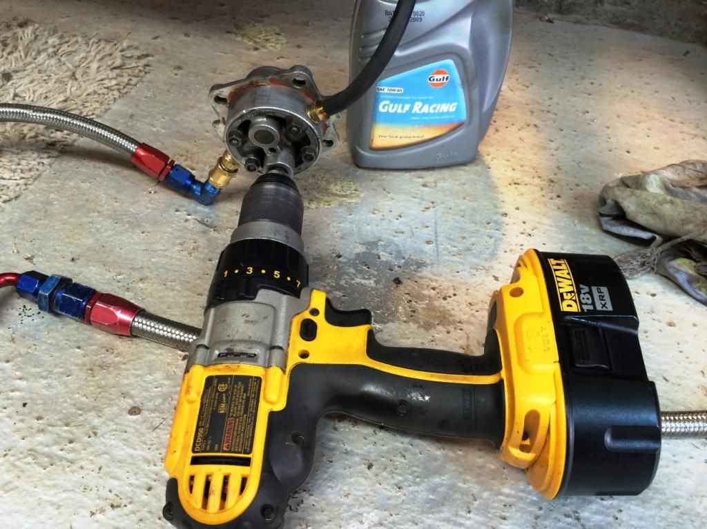

Today I made a "redneck" oil primer.
Now it did work although the TIV pump would not be fully tight.
I got 20 psi directly with a hand drill.
Connected a gauge temporaily right by the engine so I could see it better.

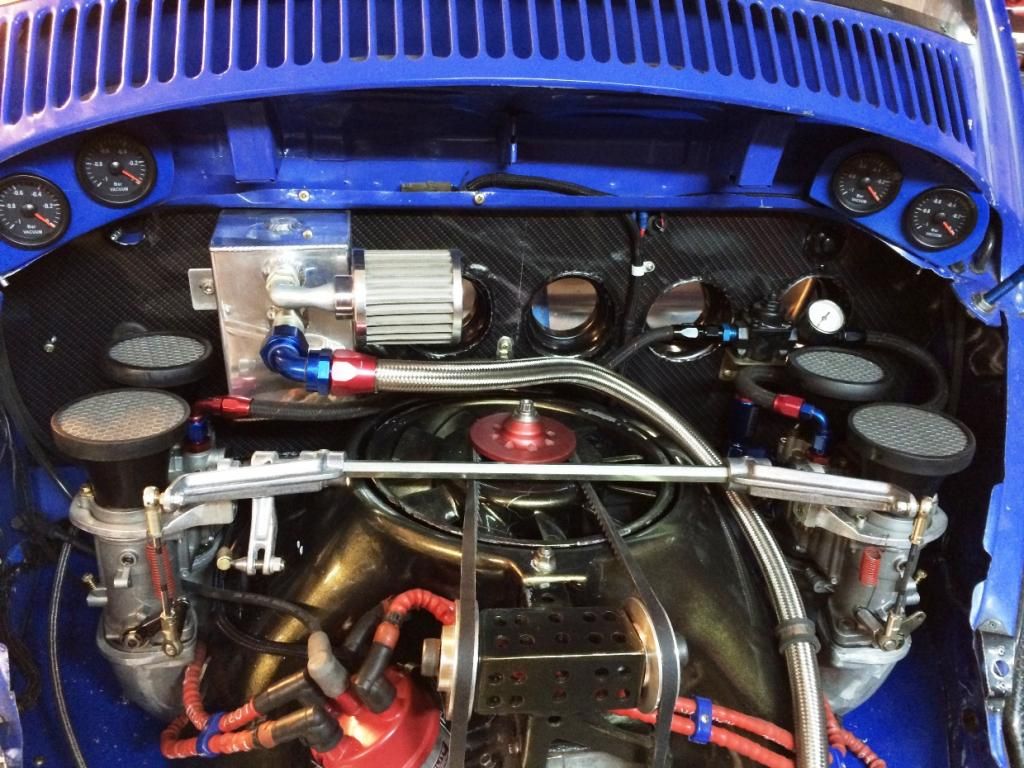

Today an idea came true. 4 X vacuum gauges mounted in the engine bay.
Ahh, plus my remote starter button.
« Reply #44 on: September 13, 2014, 00:03:51 am »
http://youtu.be/J3Td2bSz9Sw
All well except my idea about the four gauges. Or I mean windshieldwipers...kind off....like.

« Reply #45 on: September 13, 2014, 11:03:12 am »
you might need a dampener on the vac line, my carb balencer uses them, think there just needle valves, but without them it'll be all over the place  Grin
« Reply #46 on: September 13, 2014, 11:59:21 am »
Thanks Andy!  You give me hope.
I had just told myself to connect them all together and just look pretty but now I am interested again. So you mean that by just restricting (adjustable needle) in the line, it might work?
You are right, there has to be some way. I was initially thinking more of a small chamber that blances out the pulse.
Now this is not main focus right now. I can get her to run pretty good just by ear, for the time being.

« Reply #47 on: September 13, 2014, 14:07:47 pm »
Frederic - just install a small orfice, for example an idle jet - in every vacuum line close to the manifold and it will be ok (it surely will pulse but not like this). In my "carb tune" vaccum carb synchro tool the jet size is less then 1mm.
« Reply #48 on: September 13, 2014, 17:42:03 pm »
Excellent! I will try. I have a bunch of old small N2O nozzles lying around. Will most likely do.

« Reply #49 on: September 13, 2014, 20:32:48 pm »
http://www.ebay.co.uk/itm/like/291228901400?limghlpsr=true&hlpv=2&ops=true&viphx=1&hlpht=true&lpid=108&device=c&adtype=pla&crdt=0&ff3=1&ff11=ICEP3.0.0&ff12=67&ff13=80&ff14=108
thats like the one i have, see the T pieces, with the knob on top, thats just a variable restricter, with it wound out, the needle is all over the shop (like your video) you wind it in so it settles, but not so much its locked off. if that makes sense?
Should work fine once sorted, the jet idea sounds like it will work fine also! as the the brass barb on the gauge has a hole about the size of a pin in it also.
if your jet idea doesn't work, i'm pretty sure you can buy those little valves for fish tanks, to control the flow of air going into those bubble stones (airstone) if you have a fish shop near to you....
