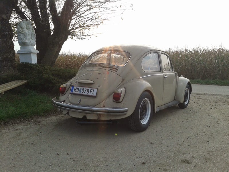

I have also Vredestein Sprint classic front 155R15 and rear 185 R15
http://german-ghia.blogspot.co.at/2014/11/fotoshooting.html
« Reply #27 on: March 17, 2015, 18:19:00 pm »
Cool bug. Like the rear wheels
Stevo_L
Posts: 77
« Reply #28 on: March 17, 2015, 19:55:35 pm »
thank you.  Grin
rear rims are lemmerz 5,5x15 et 25, front stock 4x15
