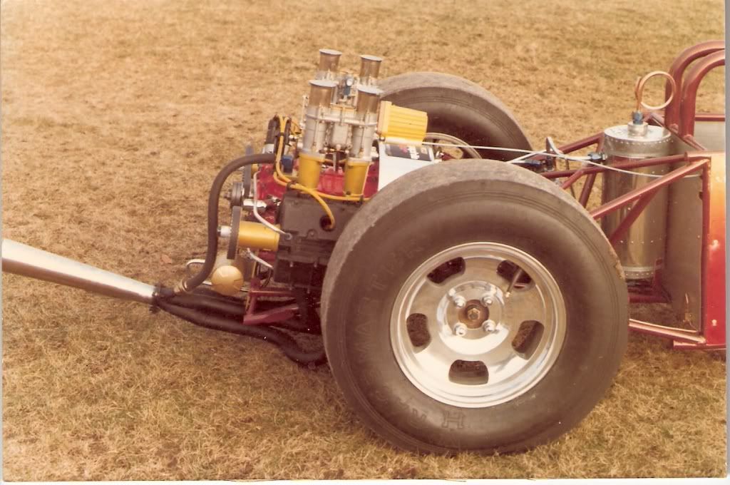

Finally it is happening.
I now live in the same country as this dragster.

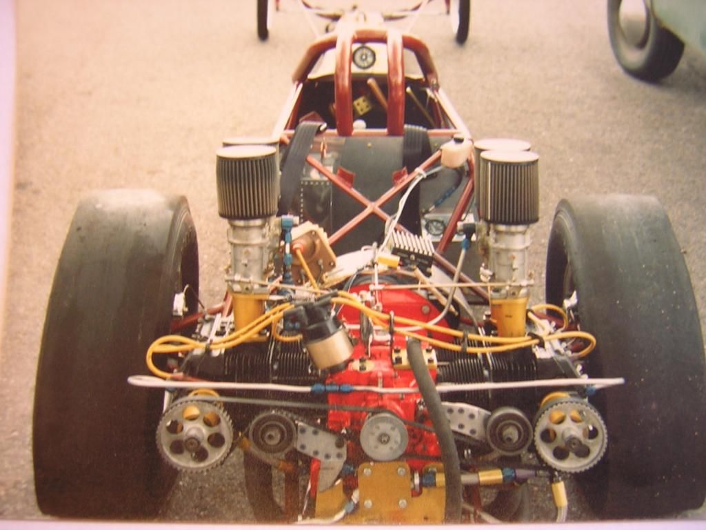

I have collected parts for many years to get it running again.
Original engine from 1978.
This time with a Autorotor to bump up the noise factor.
090 bus automatic transmission.
To begin with, pictures will tell the rest of the story for now.
Edit: I will fix the size problem but not tonight. Sorry.

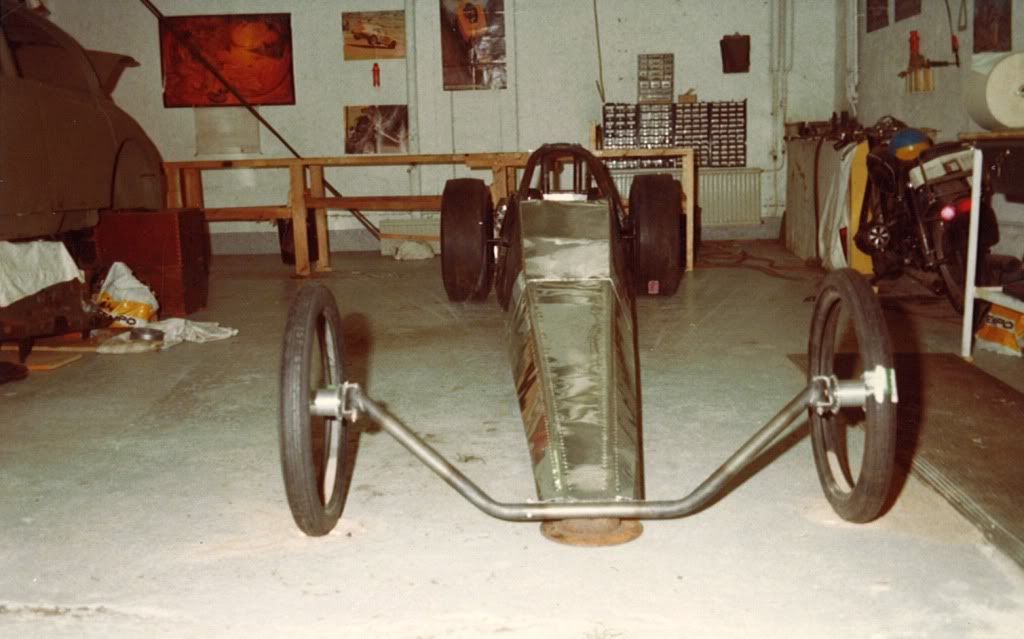

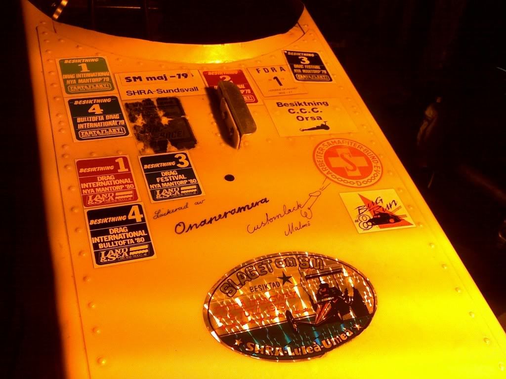

When it was being built; 1977
« Last Edit: May 09, 2014, 18:49:58 pm by Frallan » Logged

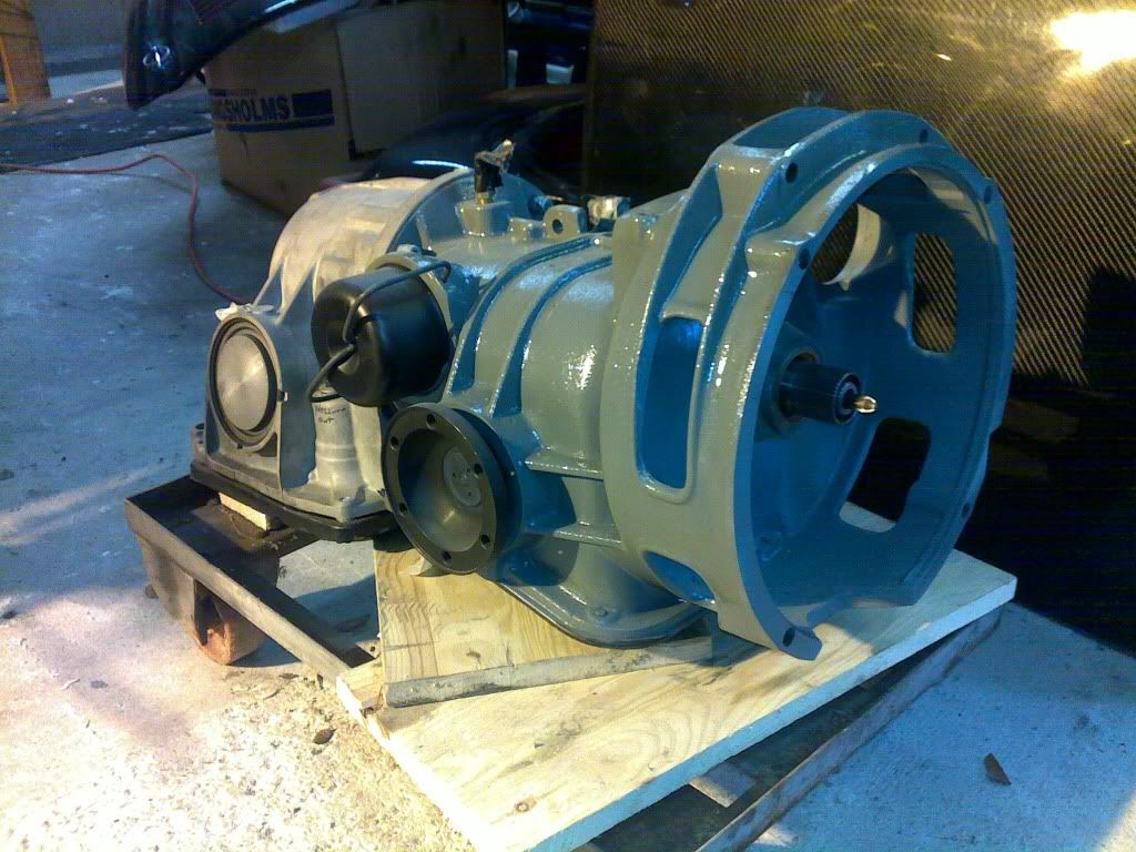

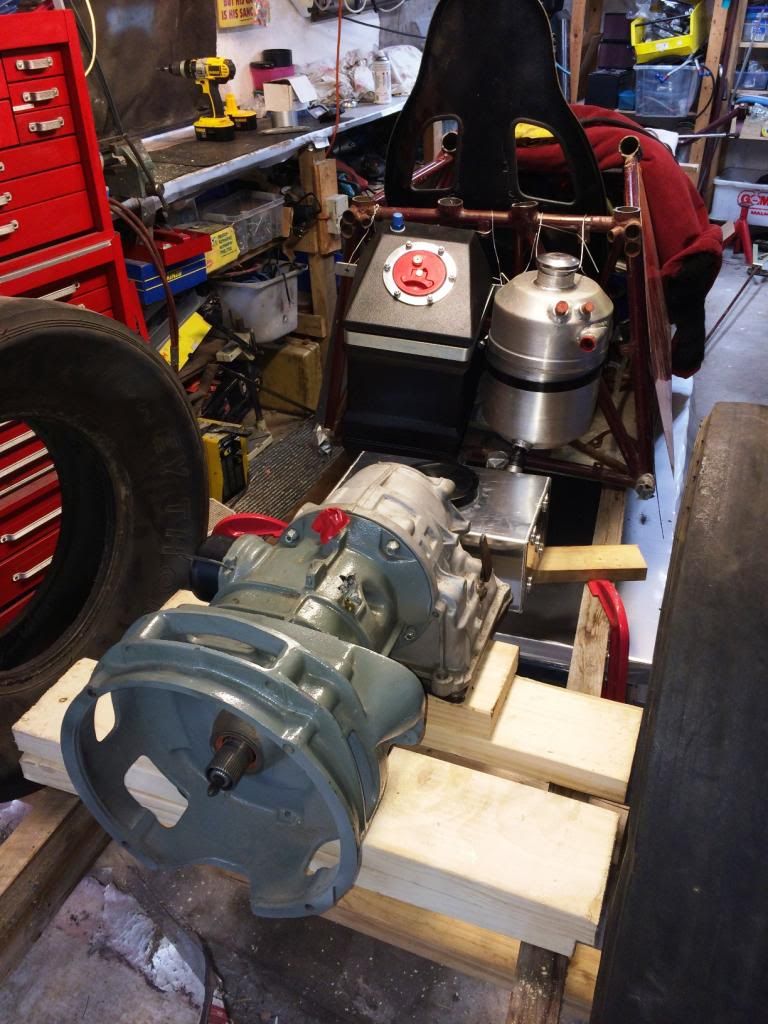

Here is the transmission.
Dave Folts built.
The spool
« Last Edit: January 23, 2014, 16:39:31 pm by Frallan » Logged

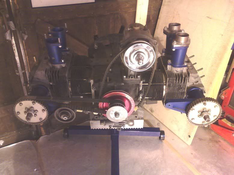

« Reply #12 on: January 23, 2014, 16:36:24 pm »

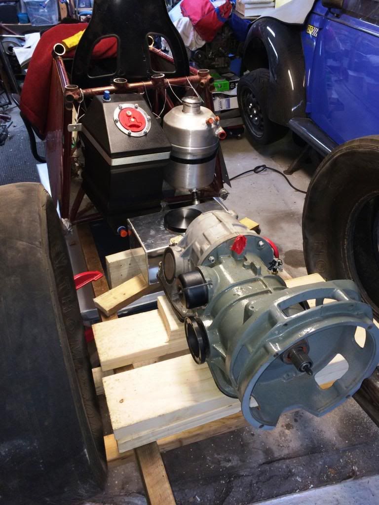

What the engine looks like today.
Prior to being painted and polished.
Mechanically fully renovated.
New Supercharger drive to be added.

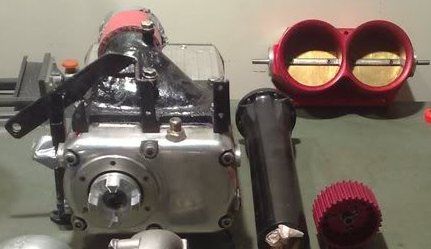

« Reply #13 on: January 23, 2014, 16:51:27 pm »
The Supercharger "huffer" from Autorotor that will go on top.
Billet throttlebody built by a friend.

Fredrik is that the 300m  hd inputshaft on that tranny?
gr henri
No SCC
At the best I will have the car running by end of season August/September.
Then it will only be local south Sweden strip testing on Malmö Raceway.
2015....that is not impossible.
Dave Folts built.
The spool
« Reply #15 on: January 23, 2014, 23:14:58 pm »
Yes Henri
And a lot more

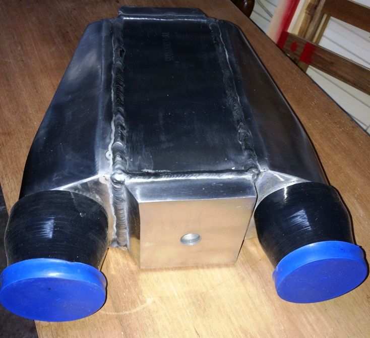

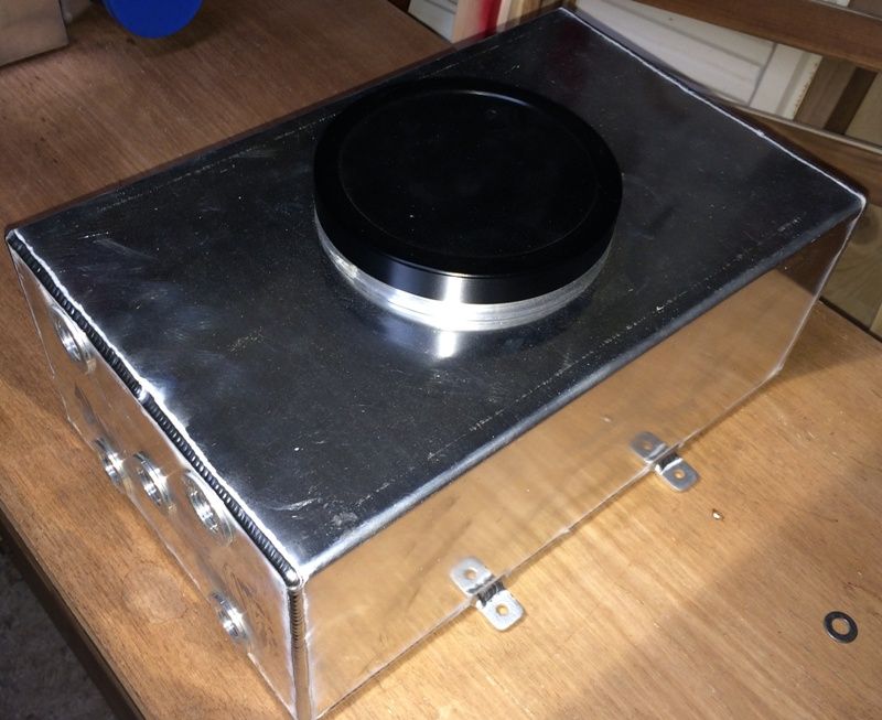

« Reply #16 on: January 24, 2014, 08:18:29 am »
The intercooler and ice tank.
Now I know what size to use.

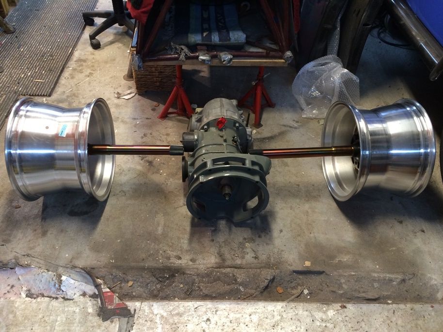

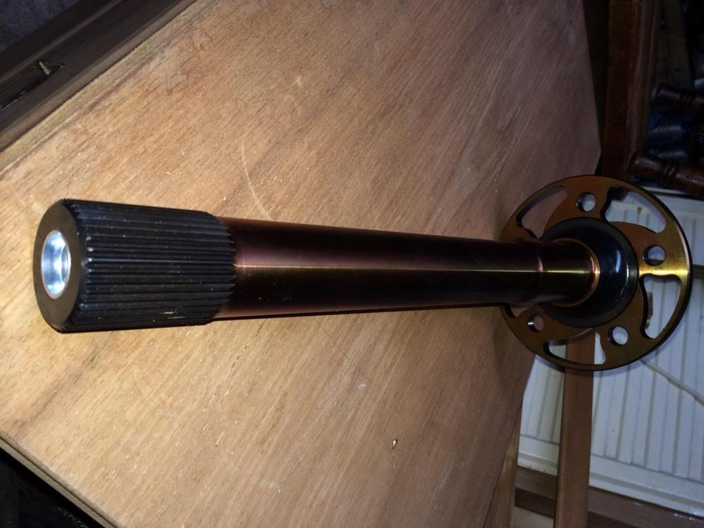

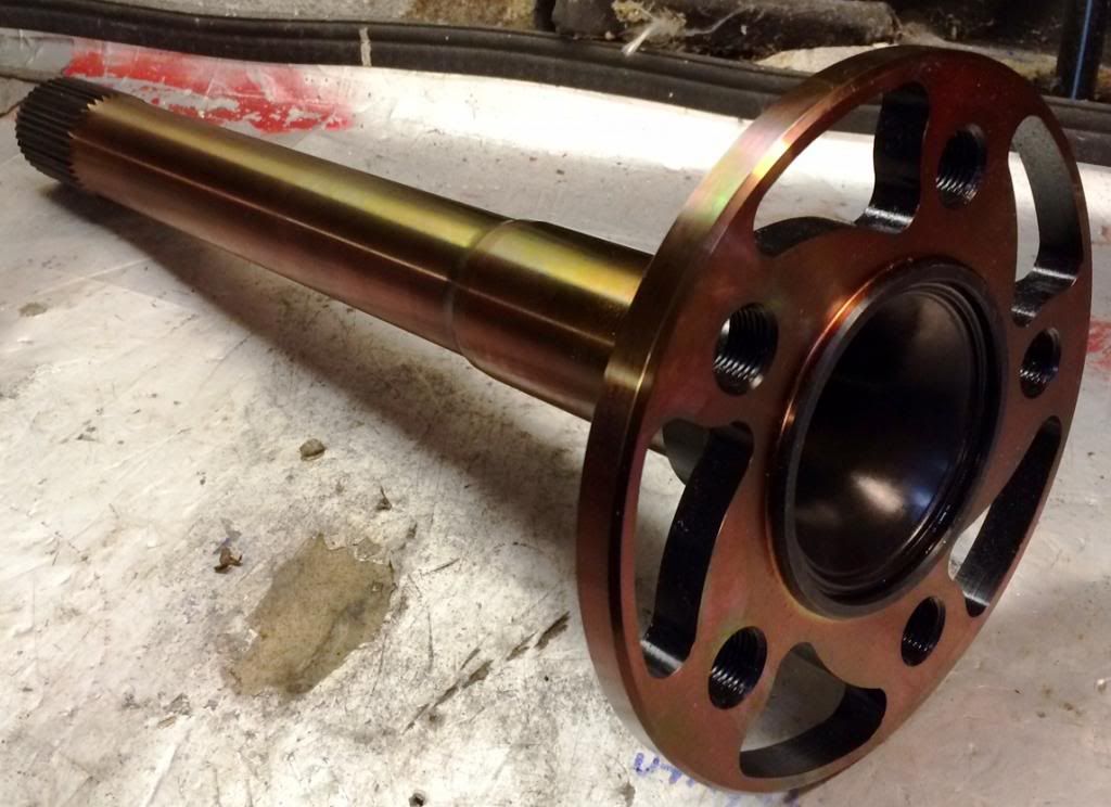

It will be a wide dragster. Maybe a bit wider than before but this time 10,5" slicks.
I love my Strange axles. A good feeling to know this part will not give trouble.
40 splines and gun drilled.

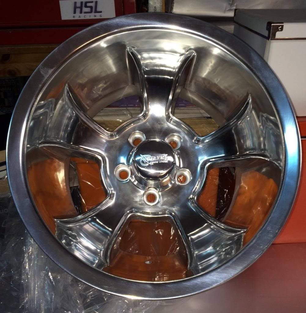

« Reply #20 on: January 25, 2014, 18:51:15 pm »
