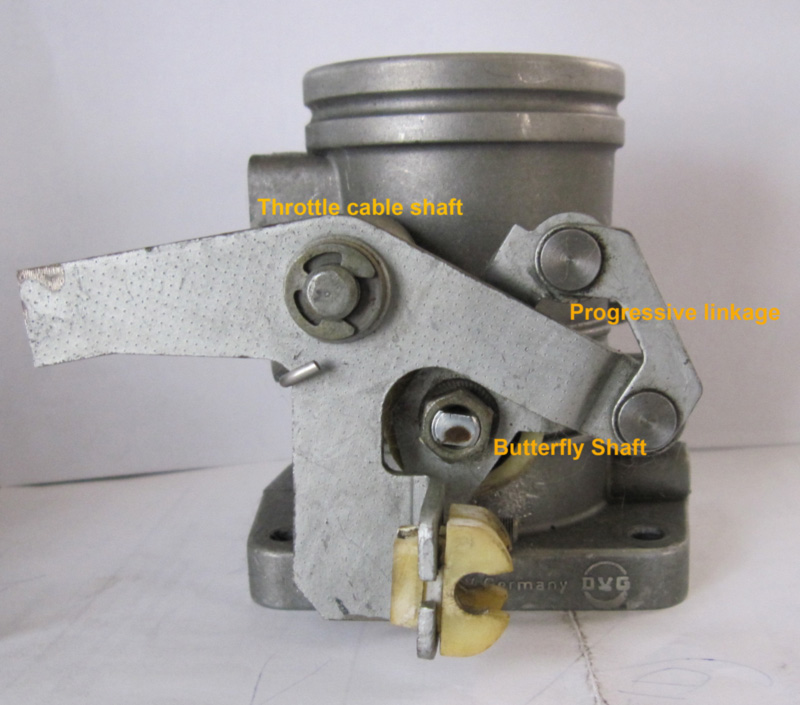

Quote from: modnrod on May 18, 2016, 11:23:58 am
PS: carb shaft "arms" riding on variable-distance "cams" like Holley pump cams maybe?
I've got a BMW throttle body in my shelf with "integral progressive linkage" that operates the buttefly shaft via links in triangle like arrangement. It's very effective but I would need at least some tech LEGO's to prototype as it's quite hard just to visualise the movements in your head. If something like that could be arranged either straight to the linkage or maybe to the carbs themselves. At least it'll need additional fixed pivotal point that maybe could be arranged to the carb's intake bolt.
Supposedly easiest way is to use center pull linkage that has "cam profile" for the throttle cable. But what fun is in easy
One possibility, maybe a quite good one, would be an linkage similar to base drum pedals. They've got a few variations for making straight movement into circular one with some progressiveness. Usually with chains or belts and "cam profiles" but also with different linkages.
