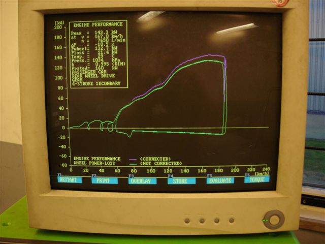

February 12, 2008, 21:00:36 pm »
http://www.youtube.com/v/9868ihgGVk8
The dyno pull is from 2500rpm to 8500rpm in fourth gear (60-190km/h or 37,5mph-118,75mph).
Today I just had to finish the "Mouse Motor" project and changed the main venturies from 37 to 39mm.
The engine responded really good with an improvement from 138,8-143,3kW or 188,7-194,9hp the torque increased from 191-195Nm (138-141lbs).
The attiude of this engine is really something, nice and smoth at idle and kicks really hard if you want it to.
There would probably be some more improvements with bigger venturies but as it is now there is no bog or hassitation between low and high circuit and as this engine is to be used on the street I prefere to have it like this.When using too big venturies you often notice a hassitation between low and high circuit even sometimes with the third progression hole modification.
The purple curve is engine power and the green curve is wheel power.
Thank you guys for all possitive input and if you have questions do not hassitate to ask.
We are lucky to have an outstanding forum like this.
Regards
Johannes

Once again Johannes, just awsome!
Looking at the photo of the power graph, it seems to be two small bumps in the curve. Is this where the rpm is between 1th and 2nd order, 2nd and 3th order? or is there another reason?
11.96 @ 180kmh - SCC 2013

Reply #226 on:
February 13, 2008, 10:38:22 am »
Hi Jim,
The camshaft is a fk45@108 and I dailed it 105deg intake centerline, too much advance will hurt the the overall performance because the exhaust changes too in a negative way and at a point the intakevalve will close too early and you lose a lot of top end power.I use to look at the closing point for the intake valve regarding to how good the heads are and the displacement of the engine, too late closing point will hurt the all over performance.If your heads are good you can close the intake valve earlier without losing top end power because the heads will still keep the VE high as the rpm goes up and your midrange will be superior.So from my experience the hardest part in chosing a cam is to determine when the intake valve should close, when you have desided the closing point chose duration so the intake valve does not hit the piston at tdc including the depth of your valvepockets.
Hopefully you see my point.
With the 39mm venturies the mains are 160,air180 and still F7 E-tubes, at low and midrange the A/F is too fat that is why there are small bumps around 4-5k rpm, maybe with F-16 or F-9 E-tubes I can get rid of those.The F-7 E-tube is a very fat tube at low and mid range the F-16 or 9 is a lot leaner.
Regards
Johannes

Holy crap!
So let me get this straight... is this 195 wheel horsepower??? or is it corrected flywheel horsepower??
And also, whats the compression???
Good work!
Roman
Posts: 656
Re: Small powerhouses and old school
Reply #231 on:
February 13, 2008, 15:47:47 pm »
Impressive to say the least.
It is corrected flywheel horsepower. The rear wheel horsepower is "only" 180.5!

February 13, 2008, 16:48:06 pm »
Hi Zack,
The comp ratio ended up at 12,32:1 and the power is corrected(DIN) at flywheel(as Roman said) about 1% less than the late SAE hp.
It is thanks to welded chambers otherwise it would be really hard to achive.
Regards

Quote from: Johannes Persson on February 12, 2008, 21:00:36 pm
Johannes,
I am very curieus about the small (gearbox and driveline) loss you have over the flywheel hp: Only 11.4 kW on a total of 143.3 kW! Thats just 8%
The 132.4 is at the rear wheel, so with a 'normal' loss of about 15-18% the FWhp would have been (is) even (much) more...
Do you have extremely good gearbox oil or something that explains this?
Tnx,
Walter
Last Edit: February 13, 2008, 17:50:31 pm by Airspeed
